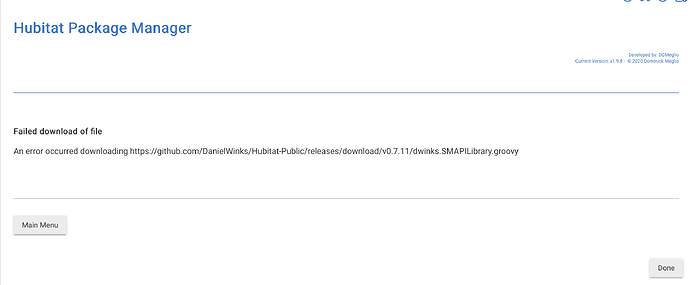

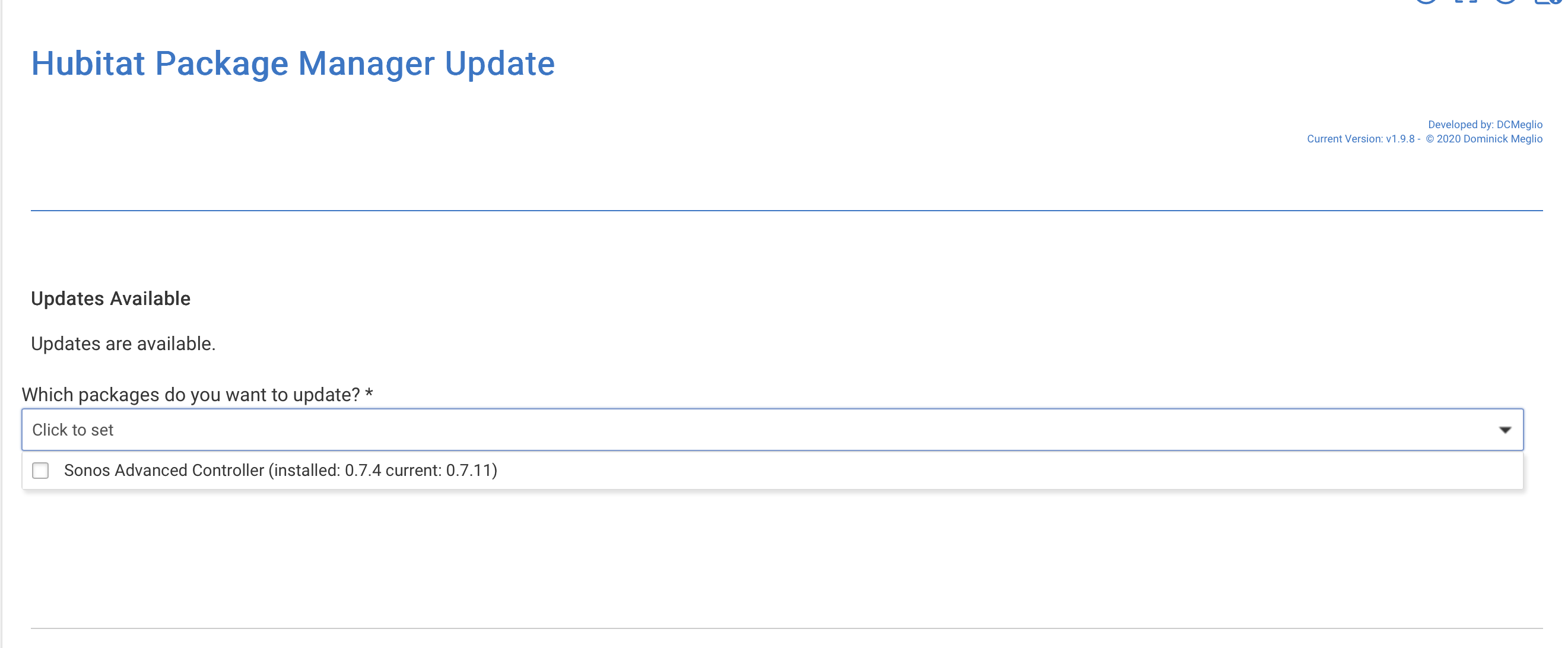

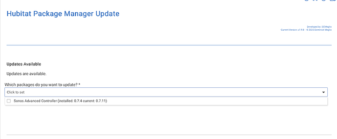

Same error here as well.
See attached pics.
Thanks, that's one issue for sure. The other is how the whole library/bundle thing works in Hubitat. I'd been reusing the same library, since that's what makes sense, but you can't put a library on HPM... you have to use a "bundle". The issue with that is if you have the library already installed, the the bundle install silently fails and just does nothing. It won't update the library contained within the bundle as far as I can see.

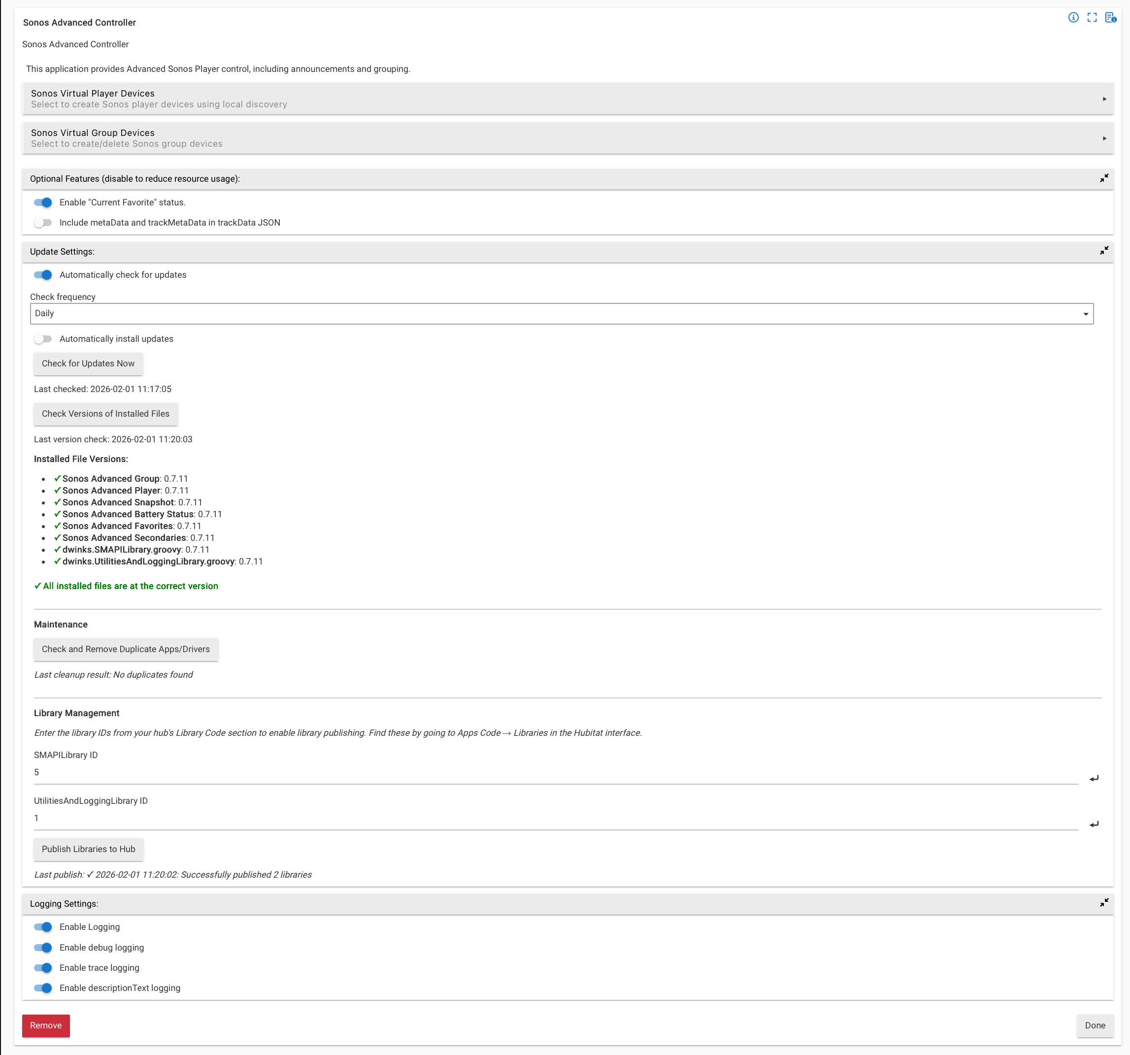

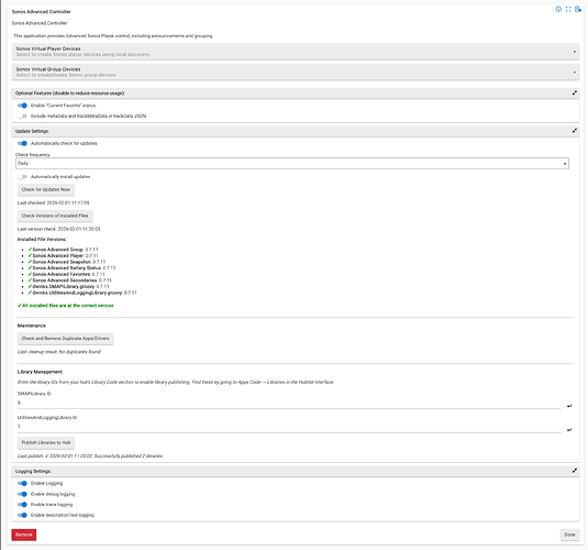

Alright, I've got a working self-update feature that I can release. However, it requires opening the 2 libraries to note the "id" for each (from the URL).
There doesn't seem to be any way around having to manually ask the end-user for the 2 IDs, as I don't see these exposed programmatically anywhere. However, by adding the 2 IDs to the Sonos Advanced app 'main page', it allows the app to "publish" the updates to the libraries directly, bypassing the whole "bundle" thing, using the same method the VS Code "Hubitat Developer" add-on uses to publish libraries.
For the app/driver, it doesn't need this and can self-update using the same method HPM does.
So far I've got this working:
What does everyone here think? Would needing to snag the 2 IDs for the 2 libraries be too much?
Testing this on my end seems to work pretty well. It'll schedule daily/weekly update checks, allow for scheduling auto-updates to occur at a specific time (and day of week, if weekly). It checks that the versions installed are correct, and allows updating them if they're out of sync, and it even checks the libraries versions directly and "publishes" them to update them as well.

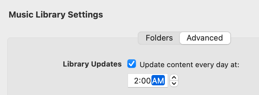

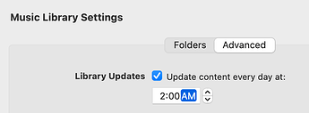

What's the specific issue you're having with local media? First, I'd check to make sure that there's not an issue playing it when using the Sonos app on your phone/computer, to rule out it being a Sonos issue. I don't have a lot of local media, but I haven't run into any issues with it myself. My local media is set to scan for updates every day at 2AM:
That's from the MacOS app... I can't find this setting on the iOS app.
My local folder is also on a little mini "server" running TrueNAS.
Assuming there's no issues playing it via the Sonos app, then see if you can get some more info on the exact issue you're having. It's a lot easier narrowing things down the more detailed and precise the info I get is.
