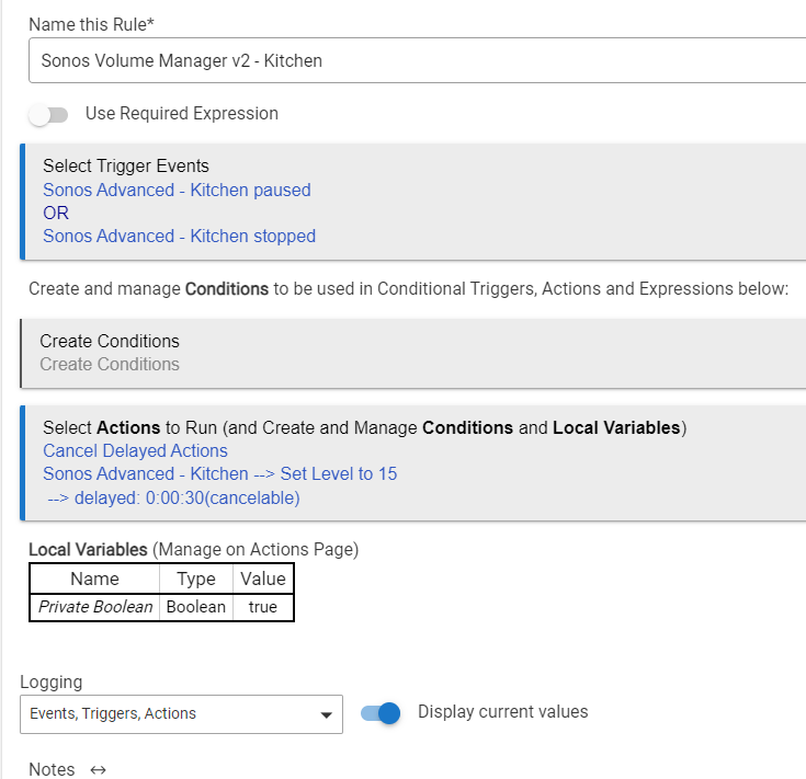

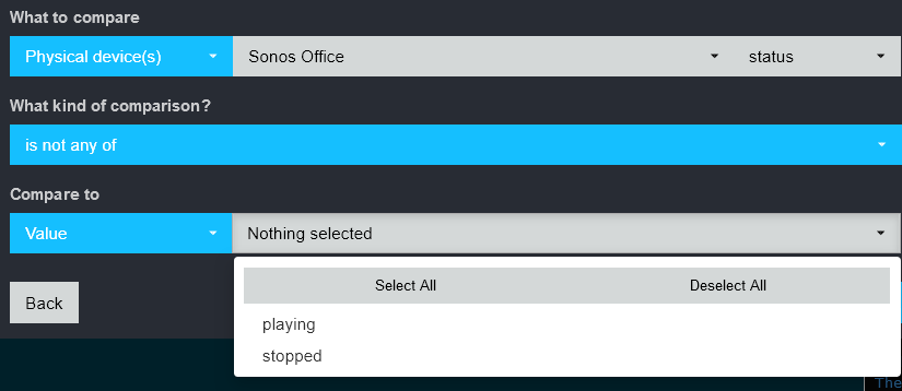

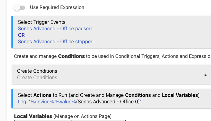

Tried to recreate it using sonos advanced device but cant get it to work, unsure if the rule is right as i don't have a reference anymore due to rm crashing. Used to reset the volume back to 15 once the music had been stopped or paused, any ideas?
I just tested this
which worked as expected

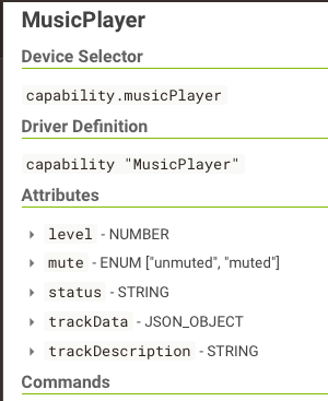

I did put in an update a couple versions ago that added this
So "status" and "transportStatus" are 'automatic attributes', part of 'MusicPlayer' and 'MediaTransport' capabilities:
So they don't need explicitly defined... but status is defined as 'STRING' on the capability. Someone else reported it not quite working the same way the system Sonos app did when using it with WebCoRE, likely because it's a string and not an enum. So I added it as an explicitly defined enum, which hopefully fixed it in WebCoRE (haven't heard if that's fixed or not yet).
It could be causing similar issues with Rule Machine.
If you haven't updated in a few days, pull in the latest version and give that a spin.
Edit: transportStatus is probably safer to use, as it seems to be properly handled as an enum.

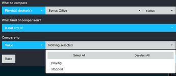

It did not.

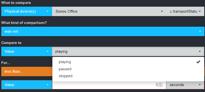

Well shucks. What about 'transportStatus'? That's updated with the same values, but it's explicitly an enum in the device capability definition.
Actually, it is there under transportStatus ... although I'd swear I was trying to do that or something similar a few days ago and getting a different result. :man_shrugging:t2:
Looks like explicitly defining it in the driver doesn't override the definition that is pulled in via the capability. At least transportStatus has it.

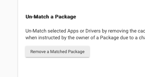

Try unmatching it, then re-matching it, then repair (not upgrade).
i dont seem to have the option to unmatch then repair, any other ideas or shall i delete and start again?
Click here:
then here:
then here:
From there it's "Match Up" and "Repair" on the main screen.

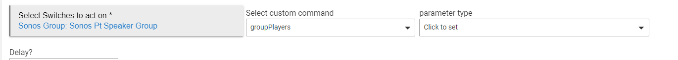

the grouping of the speakers still wont work running a custom command with one of the group speakers not available unless i'm doing something wrong? should i be picking a parameter type?
I don't know if it'll work with one of the speakers off. That's not really something I planned on being a situation when I wrote the code.
The issue is that all the grouping, ungrouping, etc, is handled on Sonos' end of things. I'm just calling their endpoints and APIs.
You could make a second group that doesn't include the speaker that's off, and do an if/else in Rule Machine to choose which group to use based on whether the speaker is on or off. But even that would require somehow having HE know that the speaker is off, such as with a power metering plug or something.
But more to the actual issue here... why is the speaker off? I'd suggest just keeping it on and avoiding the whole situation here.

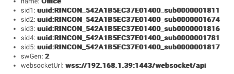

VERY IMPORTANT: you must click on "Initialize" (or "Save Preferences") on each speaker after this update. Without that, the initialize function won't get called, and the subscription for GroupManagement won't start. And without that a bunch of other stuff will end up out of sync or stop working. If there was a way to automate this, I would, but it doesn't seem possible.
Note that that step is only needed for existing player devices. If you're installing this for the first time, initialize will get called during the device creation and you won't need to worry about it. Or if you add new players to an existing install of 0.3.20 or greater, they'll also have initialize() called as part of device creation.
If everything goes properly when clicking on "Initialize" you should see 4 or 5 subscription Ids in the device data section:
If sid1 is not listed, that's expected as it's dynamically unsubscribed to when the device is not a group coordinator, and re-subscribed when it is.
sid2, sid3, sid4, and sid5 should all be listed at all times on all player devices.
It can take 10-15 seconds after clicking Initialize() for the process to complete.

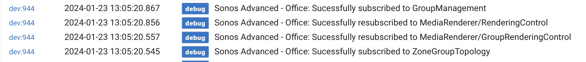

If you have debug logging enabled, it also logs this too:
Again note that sid1 ('MediaRenderer/AVTransport') won't be in that list because it's dynamic and isn't part of what gets subscribed to via Initialize().
