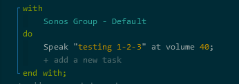

Using webCoRE, what is the proper command format to execute the speak command on a Group Device? I assumed it would be:
01
But that doesn't work and throws a 408 error.
ETA: It appears to be failing only on the Group Coordinator. It is playing elsewhere.
Bleh, more fallout from my attempt to trim down the device data section a bit. Guess I had even more code-reuse between the player devices and group devices than I thought. I'l just leave groupId, isGroupCoordinator, and groupCoordinatorId on the player devices data section. Makes things a lot simpler, at the expense of the tiniest bit extra load on HE.
0.3.22 out with fix for that.

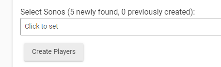

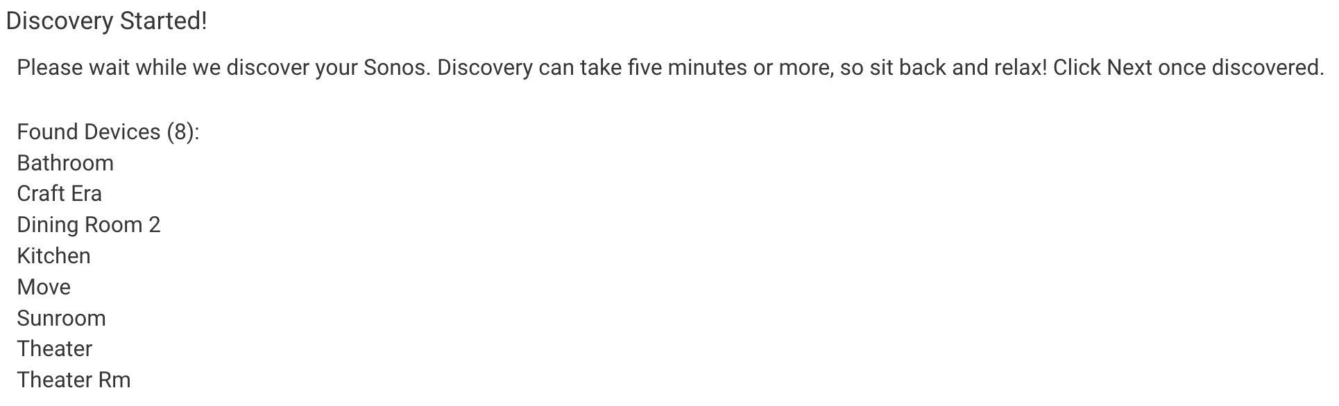

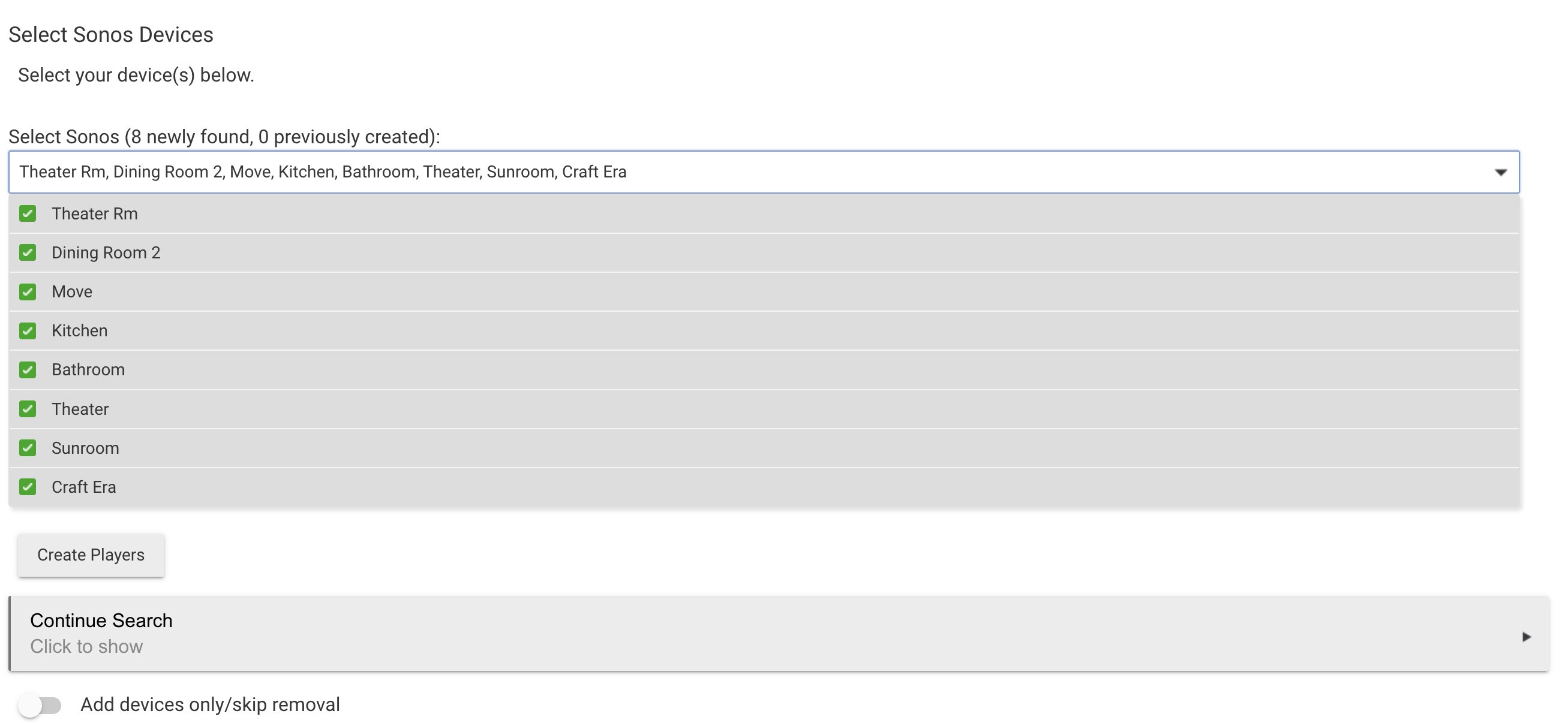

I cannot get the Sonos Advanced Controller App to create the discovered virtual player devices.
After runnig discovery, when i select each discovered player in the enum checkbox, the selected players disappear, and create players does not create any.

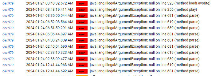

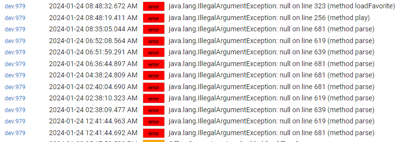

I've got lots of errors at the moment, was on .18 and just updated to .22 and it's the same. I clicked Initialize on each device after update.
Pressing play gives me this
979 is the Sonos Advanced App, all buttons are raising errors
I only see this on the device

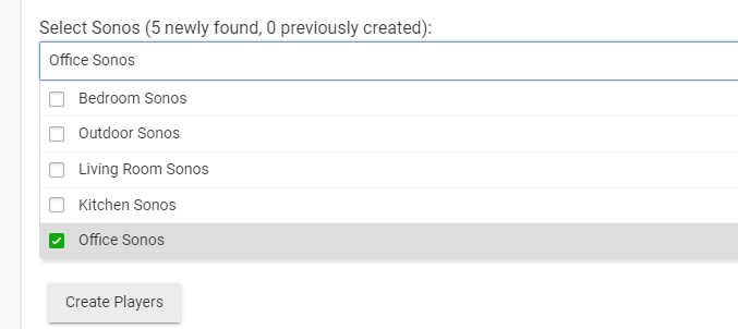

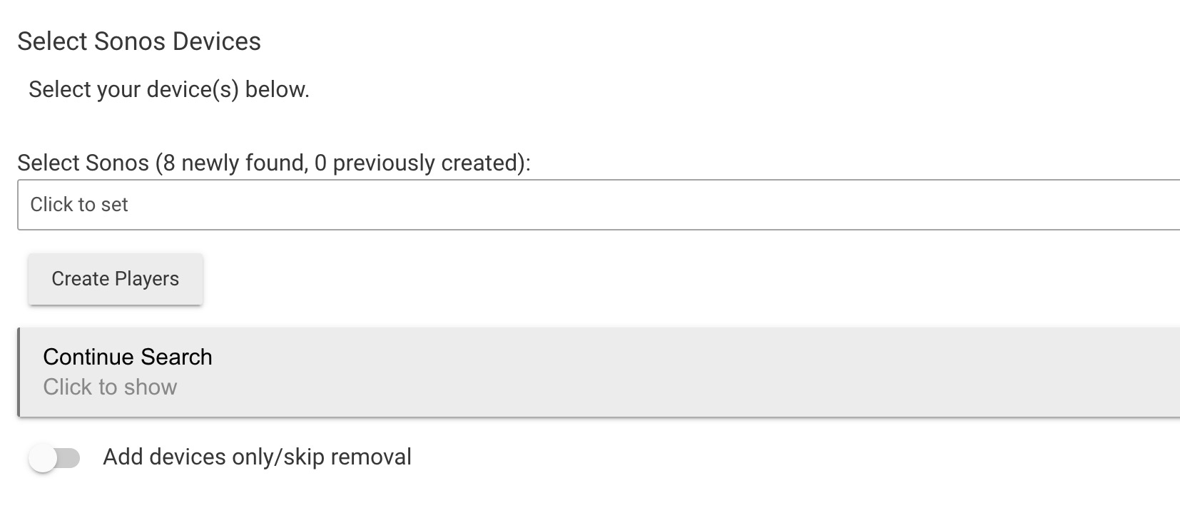

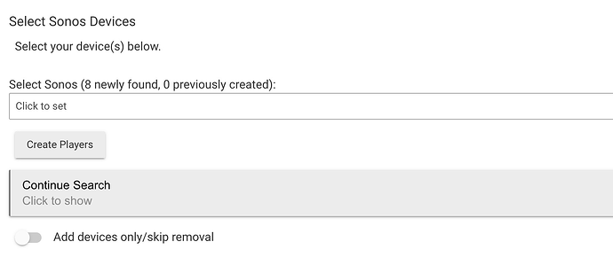

I've tried deleting a player and re-adding it but 'Create Players' isn't working. When you choose a player like this
It loses the selection when you click away

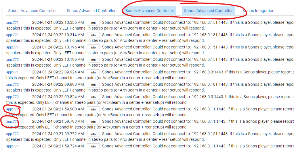

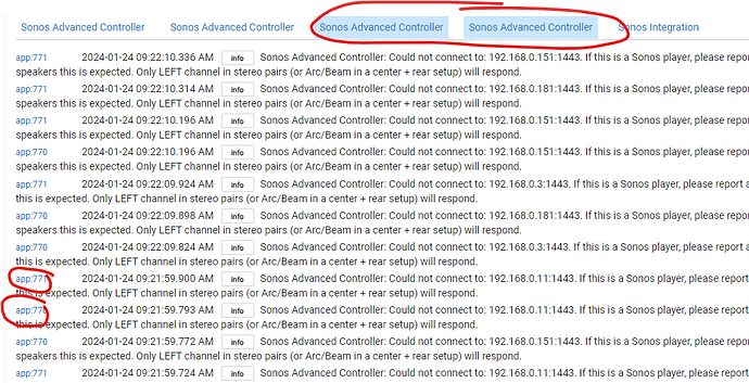

Looking at the logs I seem to have 2 versions of the app running at the same time, both producing logs
I think I'm going to wipe everything, clear logs, and start from scratch

OK, device creation should be fixed... try to fix it for one person, break it for others.
I think I'll leave a day or two between updates from here on out so I have enough time to see errors pop up on my C7. It was a relatively minor tweak to the device creation selection page that cause it to reset the selected items each time you selected one, making it impossible to select anything.

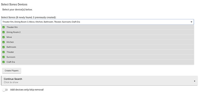

Thanks, mine works now. Re-installed everything and now have the 5 sids on each device. I did notice this in the logs initially though, before device creation
New release worked like a charm for device creation and groups! Nice!

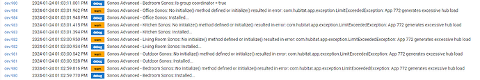

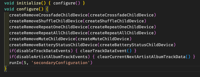

It's odd that initialize() would cause any excessive load. It's not doing anything on a newly created device:
Initialize() just calls configure(), which has a bunch of stuff to create child devices, but since those all default to off in the settings, it doesn't create them and those methods should just return super fast. secondaryConfiguration has some load to it, but it's called in a runIn specifically so configure() can complete pretty quickly.
I'll toss a quick if(createCrossfadeChildDevice) { ... } on each of those lines, so they spend even less time running. But really, configure() (on a new device where it's not making all these children) shouldn't take more than a millisecond or two to run.
