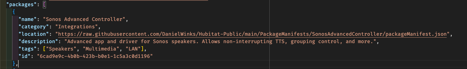

which I note points to
https://raw.githubusercontent.com/DanielWinks/Hubitat-Public/main/Package%20Manifests/SonosAdvancedController/packageManifest.son
but looking at GitHub, I'm actually seeing the manifest here:
https://raw.githubusercontent.com/DanielWinks/Hubitat-Public/main/PackageManifests/SonosAdvancedController/packageManifest.json
the difference being the hexidecimal space in Package%20Manifests :man_shrugging:t2:
Edit: I've updated from HPM multiple times previously, and never had an issue. In fact, I didn't install SAC until it was available in HPM.
Yeah, moved them out of the path with spaces a bit ago. I'm wondering if there's some sort of caching issue with the intermediate manifests.
The intermediate is:
So it shouldn't be trying to get anything at the path with a space (or the %20 version of space).
The whole point of the intermediate manifests is that it's there to allow me to move things around without breaking anything. But it seems like your HPM is using an old version of the intermediate manifest.

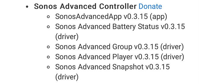

Tried that, even uninstall reinstall still showing version 3.15
That's the latest version, so you wouldn't see any updates available if you have the latest version already installed.

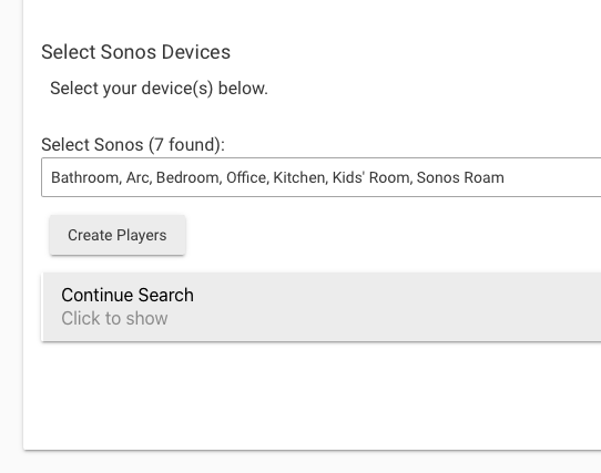

Should I see
“Added a button on the Player Device creation page that creates devices when clicked”
In 0.3.15?
Yeah, it should be right under the selection of the devices.
Thanks @bthrock I had the same issue, and this resolved it.
I dont have this "Create Players" Button

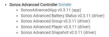

Check your "Apps Code" section... there's an issue that I've run into, as well as others, where it seems that HPM installs a second copy of the app code rather than updating what's there.
I'm guessing HPM thinks you have the latest, and you do... for the second copy of the App code. But the issue is that the one you're actually using isn't getting updated.

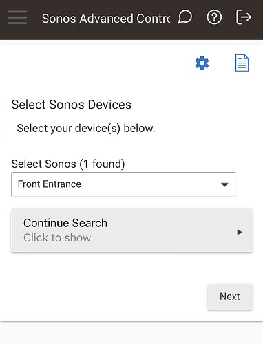

There were 4 x sonos advanced apps, I uninstalled then deleted app code and drivers then reinstalled and reboot hub but now discovery is not finding any sonos systems
Are you on Hubitat version 2.3.7.114 or newer?
Turn on logging and debug logging in the app and paste the logs in from when it’s running discovery.
Yes latest stable version, pm sent with logs
Hey Daniel,

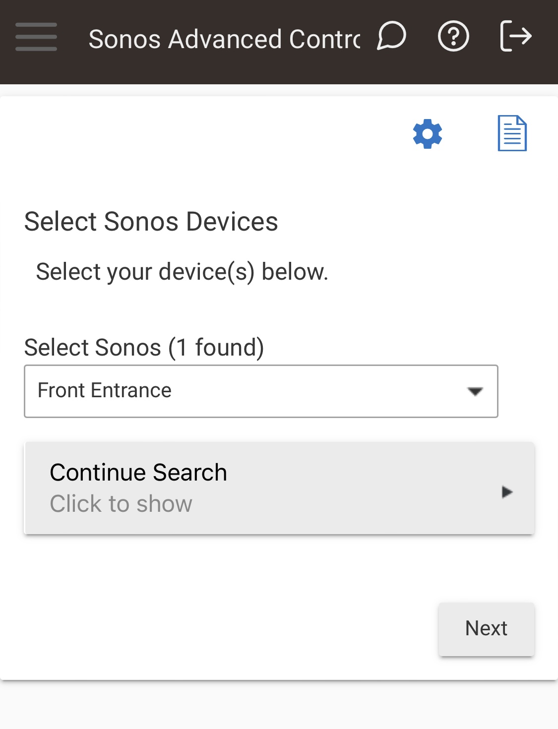

I'm having a unique challenge. I can't seem to discover all of my 17 Sonos devices. Several attempts seem to stall out at 15 or 16 and with different combinations of them. So when I hit advance, I can chose to add the missing ones that showed up in the last search, but then it want's to delete the one or two it didn't find on that run.
Kinda frustrating... I should be able to just discover additional devices and not have to remove what it didn't see during that particular search...
I've tried playing music through the devices and changing settings hoping that will cause your app to find the missing players... But no go... If I restart it, I might find the missing one, but then another doesn't show up and when I hit next it wants to remove what it didn't find.
EDIT: I ran it for the 9th time and it finally found all 17... Still maybe there could be something to prevent removing a previously found device... I've been playing with adding devices for about two hours just trying to get it to discover all 17 at the same time... But all good now... Gonna start playing with your app... Thanks again

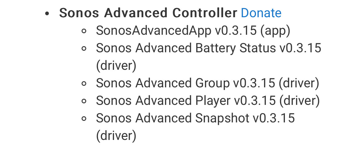

My latest update shows the following with no updates available on HPM. I'm on the latest HE version. No duplicates under 'Apps code'
That worked for me too :+1:
I can add a toggle on the creation page to have it 'only add'. Whenever you change your speaker config, such as adding a stereo pair mate, adding a sub, etc, it removes the old MAC/RINCON entirely and make a new one. So if you had a single speaker, and added a stereo pair mate to it, you end up with 2 entirely new MAC addresses on your network, and the old MAC/RINCON disappears entirely.
The current logic is to find such 'orphaned' devices and remove them. There's nothing I can do about how Sonos handles the logic behind their virtual MAC/new RINCON stuff in this regard... tho at some point when I have some excess time on my hands, I could probably code up a device migration helper for just such cases. It should allow me to update the DNI, all the "Data" fields on the device, and effectively replace the device anywhere it might be used in Rules or other places.
But adding a quick "don't remove anything, only add" toggle, that'll take less time than I spent typing this message.
Edit: It'll take a few minutes longer than I thought, because the reason it's wanting to remove them is that these devices aren't in 'settings.playerDevices' for the app. I'll need to make sure that running discovery 2+ times results in everything being added to that, and not having the most recent discovery simply replacing it.
