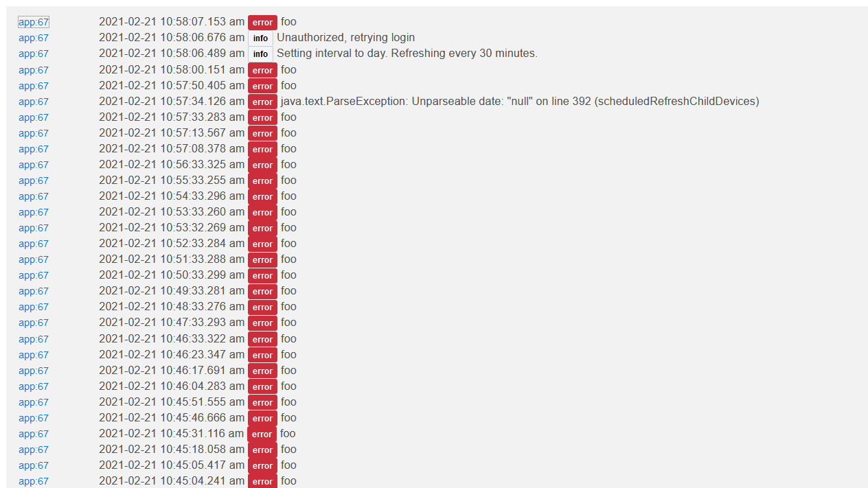

Haven't checked into this feed for a while. However, I noticed this in my logs. What is the reason for all the "foo" errors?
Also, noticed multiple "unauthorized" lines. Lost power and internet due to ice the night before last. Could that be the issue? What would be the fix?
Sorry, the foo
log was me testing yesterday and accidentally left it in. Just pushed 3.1.2 that removes it.
Unauthorized is likely due to the power loss but I'm not sure why it wouldn't recover. If you now have power, you can try opening the app and re-saving your credentials. If that doesn't work, can you enable debug logging (after taking the update) and PM me the logs?

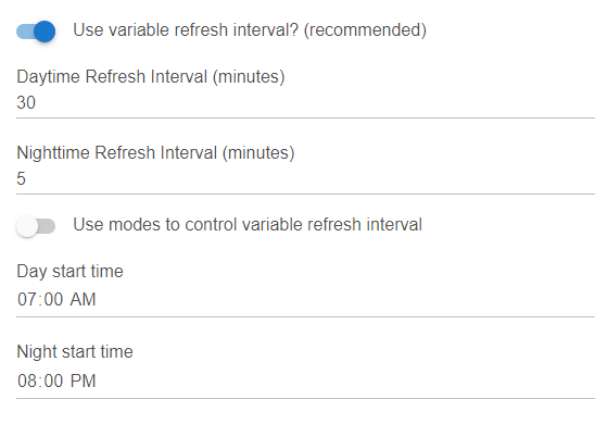

I just updated to the newest version yesterday. Now it looks like the day/night modes are battling each other for some reason.
Here are my settings
interesting, I shuffled that around a bit but didn't change the underlying logic. I'll take a look later today.
I think I see the problem; I'll run it overnight and if it fixes things I'll push the update tomorrow.
