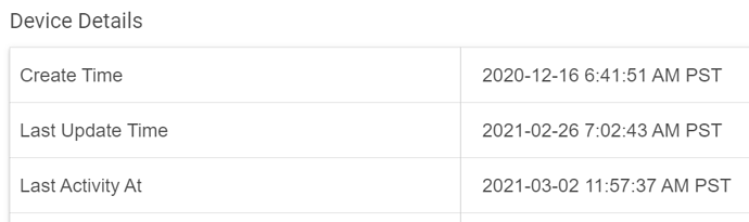

Here is the state from my side

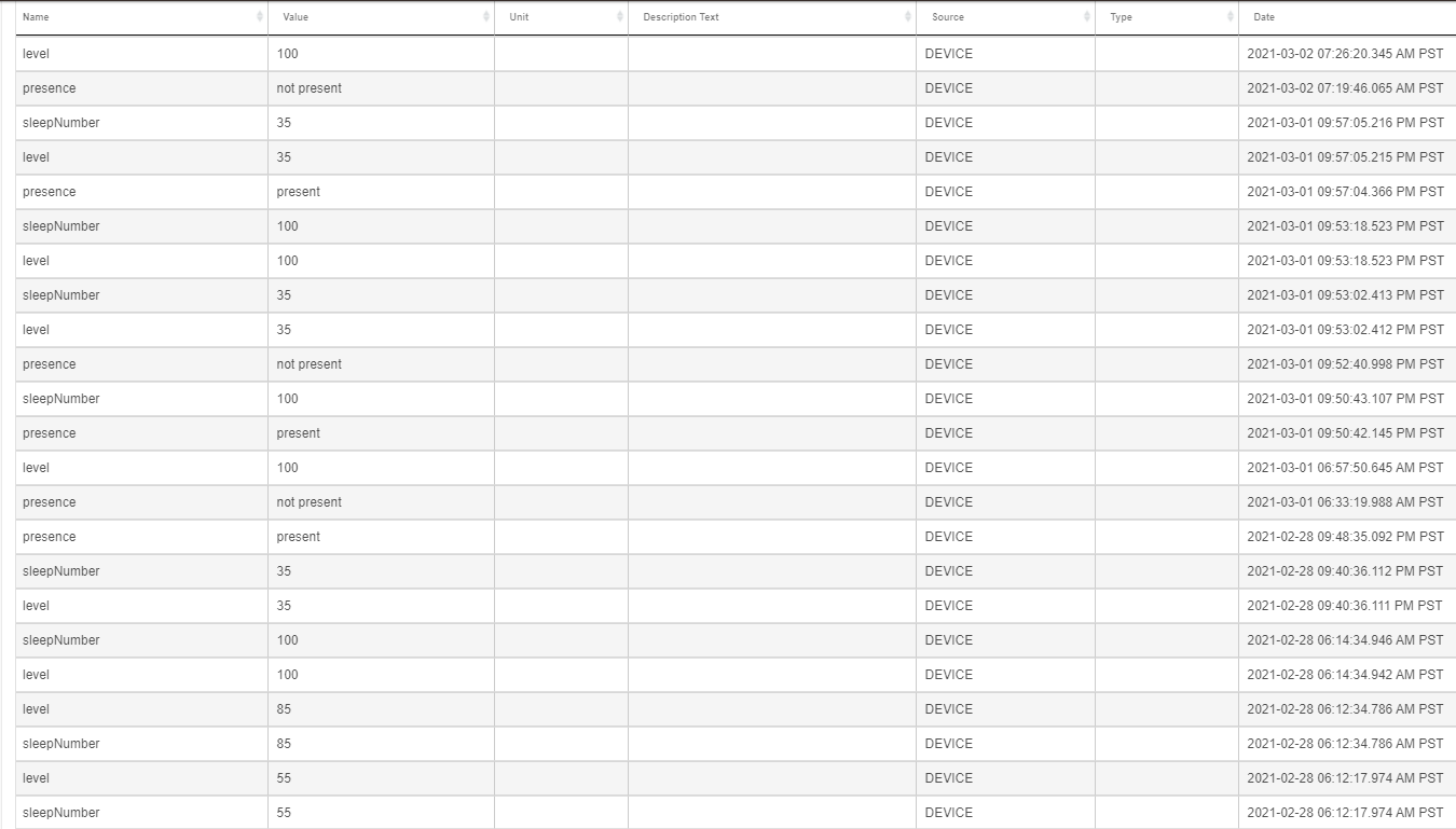

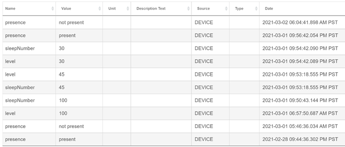

Nothing in the HE log, however here is the event log from the device
Note, for the last week, I have manually selected departed in the AM which is why everything appears to be normal but it's not. My wifes side detects when she leaves w/o issue
Not sure if this helps but the last activity seems to coincide with what I have been seeing

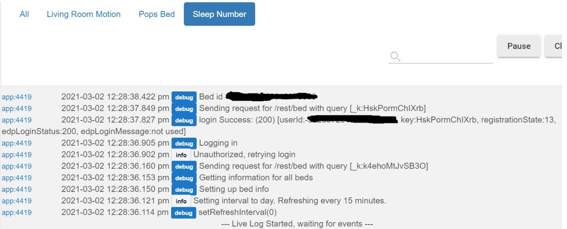

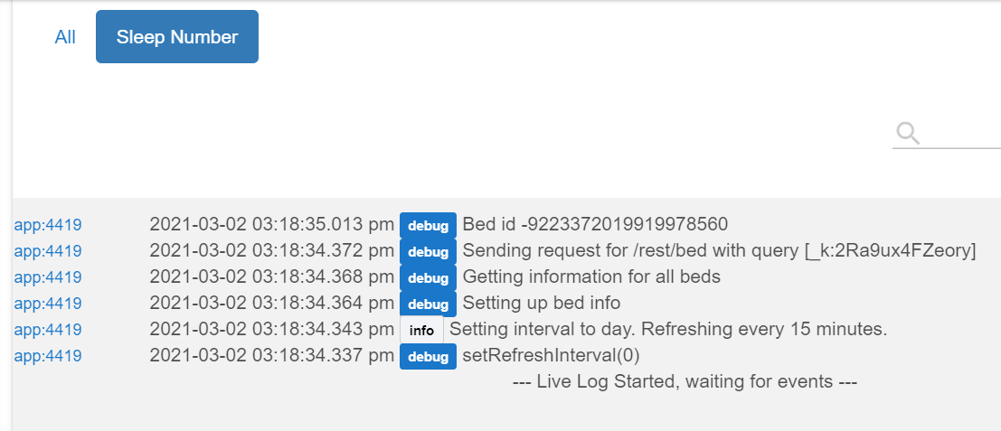

Debug was enabled and saved, then I hit poll, here is the device log
App log
there should be a lot more in the app debug log than that. You should have something that looks more like this where it shows the response and cached info.

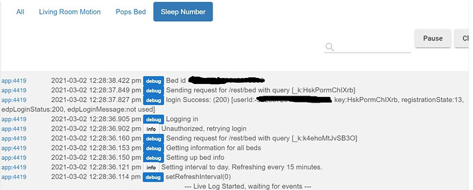

I went into the Apps section, opened Sleep Number Online, turned off debug, saved and then turned it back on and this is all I get
that's really odd; can you try repairing your install through HPM? The first part of your log looks correct but if you don't see anything after that then it doesn't appear to be issuing requests.

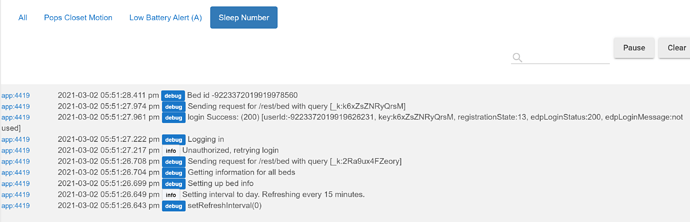

Edit: Turned off debug, used HPM to repair the app, enabled debug logging and here are the results
Ah right, I forgot your bed was set up that way. That means saving the app won't do anything interesting; you'll need to have debug on and hit poll on the device. This should result in log lines for the app that start with:
Getting family status
Response data from SleepNumber:
and then more info about the response.

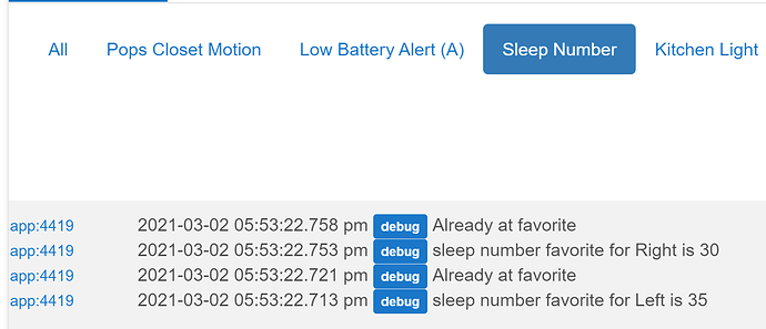

My wifes device, hit poll
My side, hit poll, nothing showed up in the logs, literally nothing. selected present then departed and this is all that is in the log

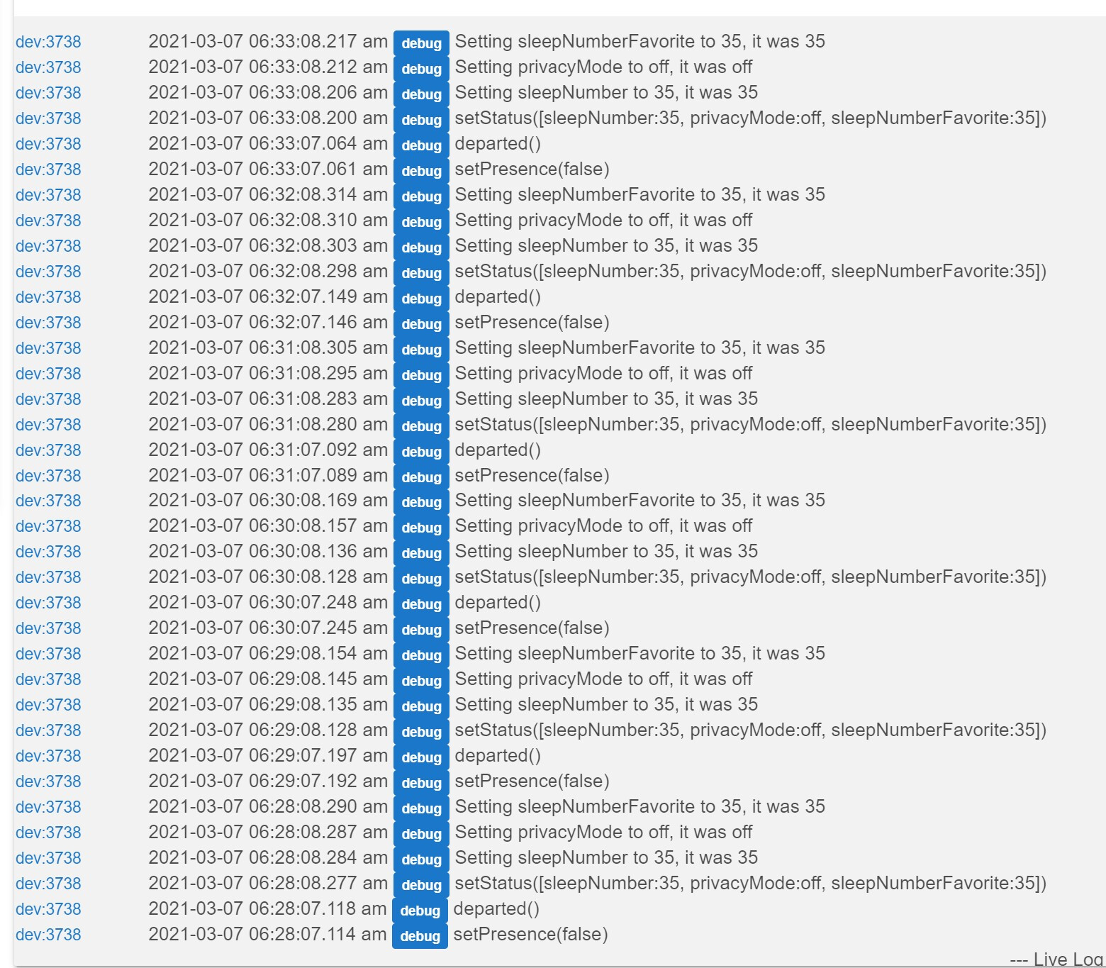

Here is the log from my device. I was in/out of bed right around 6:29am, nothing is showing
There is nothing in my wifes device log for the same time
So, SIQ knows when I we get in/out of bed but not the app
