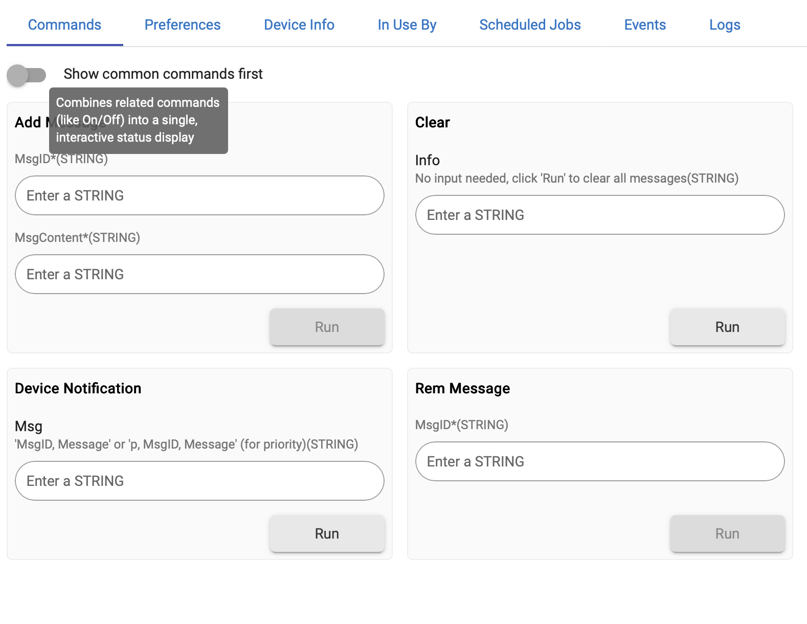

How To Add The Driver
- Go to Developers > Drivers Code
- Click 'Add Driver'
- Paste the code from below and Save
Add The Device
- Go to Devices > Add Device > Virtual
- Select 'Scrolling Event Notifier' from the type dropdown
How To Use/Example

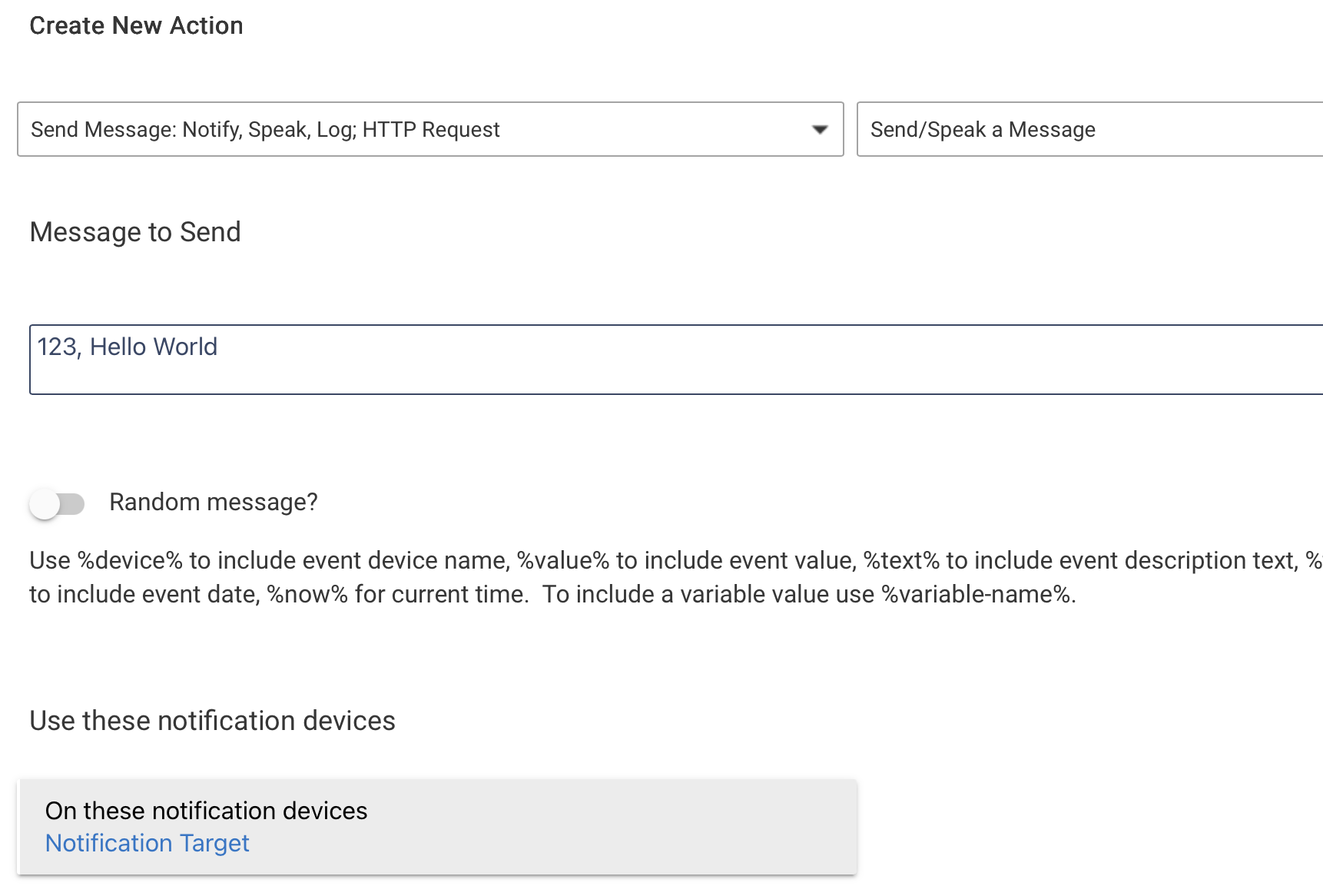

To add, remove, change a message or remove all messages as an action in Rule Machine:
- Create a new action and Select Action Type To Add > Set Variable, Mode or File, Run Custom Action > Run Custom Action
- Select capability of action device > Actuator and select your new 'device'
- addMessage > Add a Parameter > Parameter Type - String
- enter a unique number in the string value field and save
- Repeat Add a Parameter > Parameter Type - String
- Now enter your message in the string value field and save
The number added is paired with the message. Removing a message is done the same as above, but by selecting remMessage and entering the corresponding number in the string value field.

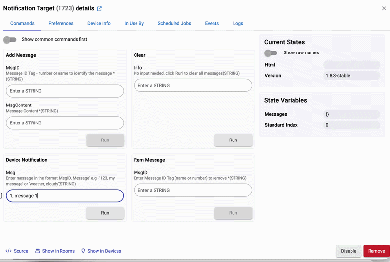

command "deviceNotification", [[
type:"STRING",
description:"'MsgID, Message' or 'p, MsgID, Message' (for priority)"
command "addMessage", [
[name:"msgID*", type:"STRING"],
[name:"msgContent*", type:"STRING"]
command "remMessage", [
command "clear", [[
type:"STRING",
description:"No input needed, click 'Run' to clear all messages"

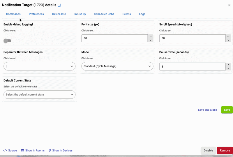

preferences {
input("debugEnabled", "bool", title: "Enable debug logging?")
input("fontSizePx", "number", title: "Font size (px)", defaultValue:30)
input("speedPxPerSec", "number", title: "Scroll Speed (pixels/sec)", defaultValue:50)
input("separatorChoice", "text", title: "Message Separator",
description: "Enter character, symbol, emoji to separate messages. Leave blank for default ('|')")
input("separatorPadding", "number", title: "Separator Padding",
description: "Number of blank spaces to add either side of the separator",
defaultValue:3)
input("mode", "enum", title: "Mode",
options:["Scroll Message","Standard (Cycle Message)"],
defaultValue:"Scroll Message")
input("pauseTime", "number", title: "Pause Time (seconds)", defaultValue:5)
input("noMessageText", "text", title: "No Message Display",
description: "text to show when no message present, leave blank for empty tile")
input("priorityColorPreset", "enum", title: "Priority Message Colour",
options:["Hex Value","red","orange","yellow","green","blue","indigo","violet",
"purple","pink","brown","gray","black","white","teal","lime",
"cyan","magenta"],
required:true)
input("priorityColorHex", "text", title: "Hex Color",
description: "Enter a hex color (e.g., #FF00FF) if 'Hex Value' is selected",
required:false)
input("priorityStyle", "enum", title: "Priority Message Style",
options:["Standard","Bold","Italic","Underline","Bold & Italic","Bold & Underline",
"Italic & Underline","Bold, Italic, & Underline"],
defaultValue:"Standard")
