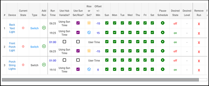

@evcallia Think I've found a bug, or perhaps more accurately an edge case. I've got a schedule set up like this:
Randomly, the front porch light doesn't come on at 1am, and/or the porch string lights don't turn off at 1am.
I commented out the logsoff function so debug logging would remain on, and I think I know what the problem is. At line 1654 you have: schedule("0 0 1 ? * * *", updated)
but there's also two scheduled jobs that call switchHandler() at 1am. So there's three scheduled jobs for 1am and the order they are called in is random. If the one that calls updated() runs first, the other jobs are either unscheduled or somehow interfered with, and one or both of the lights that should turn on or off at 1am does not occur.
I'd probably check to see if there's anything scheduled for 1am and if there is, back off the time by a few minutes and keep checking until there's no conflict. But there's probably several ways you could handle this.
For now, I'll just change the time to 12:50 am instead.

Definitely a race condition here depending on which 1am schedule gets run first. I like your proposed solution of backing off the refresh until it doesn't conflict. I'll get a fix out for that and include the logging suggestion as well.

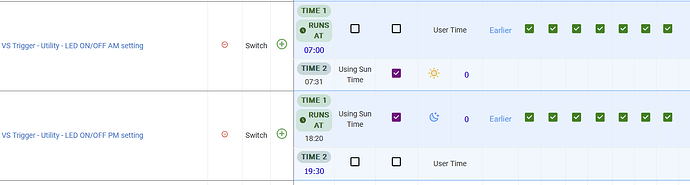

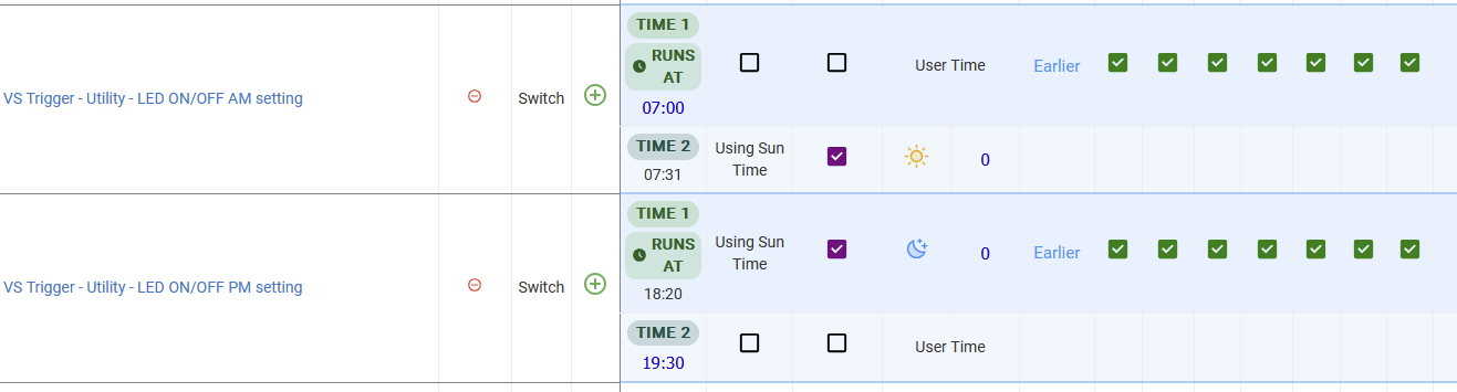

Awesome, here's the updated branch - https://raw.githubusercontent.com/evcallia/hubitat/refs/heads/codex/add-earlier-or-later-option-to-schedule-manager-66ry1b/apps/schedule-manager/schedule-manager-child.groovy
Here is my test case:
I'll report back in a day or two!

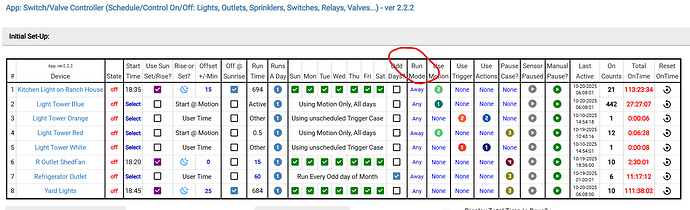

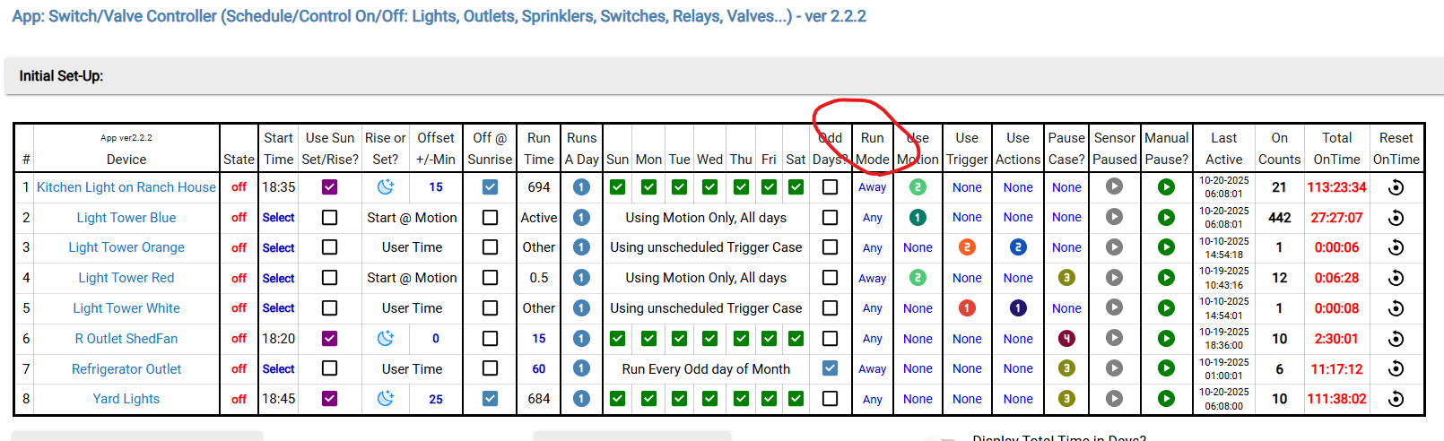

Thanks, but that's way too many moving parts to move something I already have set up in RL to Schedule Manager. RL does exactly what I want and has been working fine for a long time, I'm just not a fan of its UI. I probably ought to leave well enough alone, but I like the simplicity of Schedule Manager's UI.
Like this?
