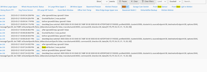

nothing on any of the c8 fixes would have changed how this worked, have you reverted to a previous release to verify its a platform issue?
cannot revert to a previous release as it probably has been in there awhile and obviously dont have very many previous releases for the c8..
i was hoping you could refresh your memory and check that the fix you put in on that build is still in place.. all i know is that when you did it stopped on both of my c7s'' let me check the other c7 in my othe rhouse to see if it is also having the bogus event.
dont see the device on the othe rhouse.. must have removed the device to stop events when house was empty... bummer
it was a driver update, and there haven't been any changes to that driver since then
could it be behaving differently on the c8 becuase of the new chip or zigbee version.. ?
i will turn debugging on but i think it is the same message as prior
i dunno, would need to see a few rows of the device debug logs while this is happening to be sure
this looks like a C8 specific thing..., will look into it

have you looked in the logs..
2.3.5.116 includes a fix for the spastic events. In reviewing the driver code I'm not sure the previous fix last year could have ever worked....
I did look through the logs. The only activity showing are confirmed doorbell button presses. No other messages, errors or triggers appear.
ya mine stopped doing the button two whan button 1 was pressed so it is intermittant weird.
