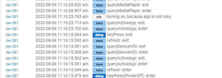

I have a rule that has been running for probably a year that automates ambient light with the Switch attribute on the TV. Basically it just turns the TV lights on and off when the tv turns on and off. Recently it quit working. When I look at logging it looks like it turns it off and then seems to think it is active because the TV reports it is on the Home app.
Any ideas. Only idea I have right now is to either resort to what i do for two other tv's that use roku sticks which is power monitoring, or change the automation from switch to the Power state on the TV.

From this, you can see the a couple things must happen. First, the currentApp had to have changed from the previous refreshed state. Next, the currentApp must not be 'Roku', and finally, the switch must not be 'on'.
From your logs, I see that the powerOff keypress was initiated. This in turn resulted in a refresh which would have updated the application and all device info. Then, 10 seconds later, the current application was quarried, and the current application was not "roku", so it set the TV state to "on".
Perhaps your TCL is taking more than 10 seconds to shutdown, and incorrectly reporting Roku as the current app. Try unplugging the TV, to see if the adequately resets the TV and clears up the issue. I know the TCL Roku software is a bit buggy, and my older Roku TV will get very slow, requiring me to reboot the TV. Although sometimes, a reboot is not enough, and I have to unplug it.
If I power the TV on and then off with the driver. Application shows Roku and MediaInputSource shows Home. Once The queryActiveApp routine runs it changes the application to Home and then sets the switch to on.

To me it looks like the driver changes all of the states as expected. Media Input source is Home, and it changed the application state to Roku. When the QueryActiveapp routine runs and queries the TV it gets "home" which triggers everything to be set to the active state even though the TV is turned off
