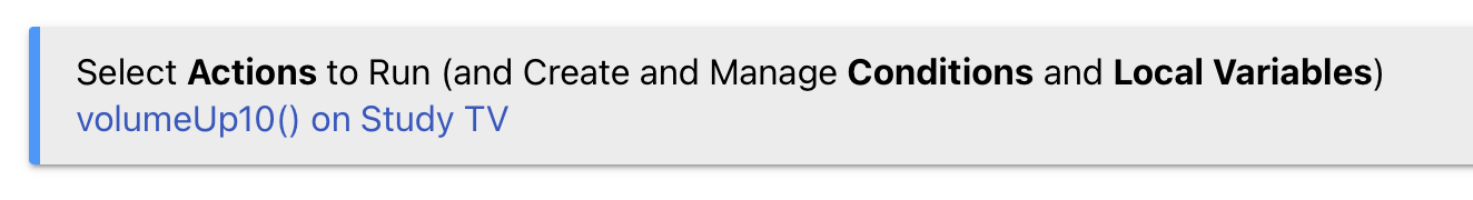

The setVolume does not work, because Roku does not support the command. Also Hubitat does not support TV in rules so you must use a custom command. The only commands available are mute, unmute, volumeUo, volumeUp10, volumeDown, volumeDown10
As such, Roku allows us to raise and lower volume, but we cannot set volume to any specific level β€” it’s all relative adjustments only.
In case anyone else finds this in a search some day (like me) here's what that looks like in a rule:
Thanks!

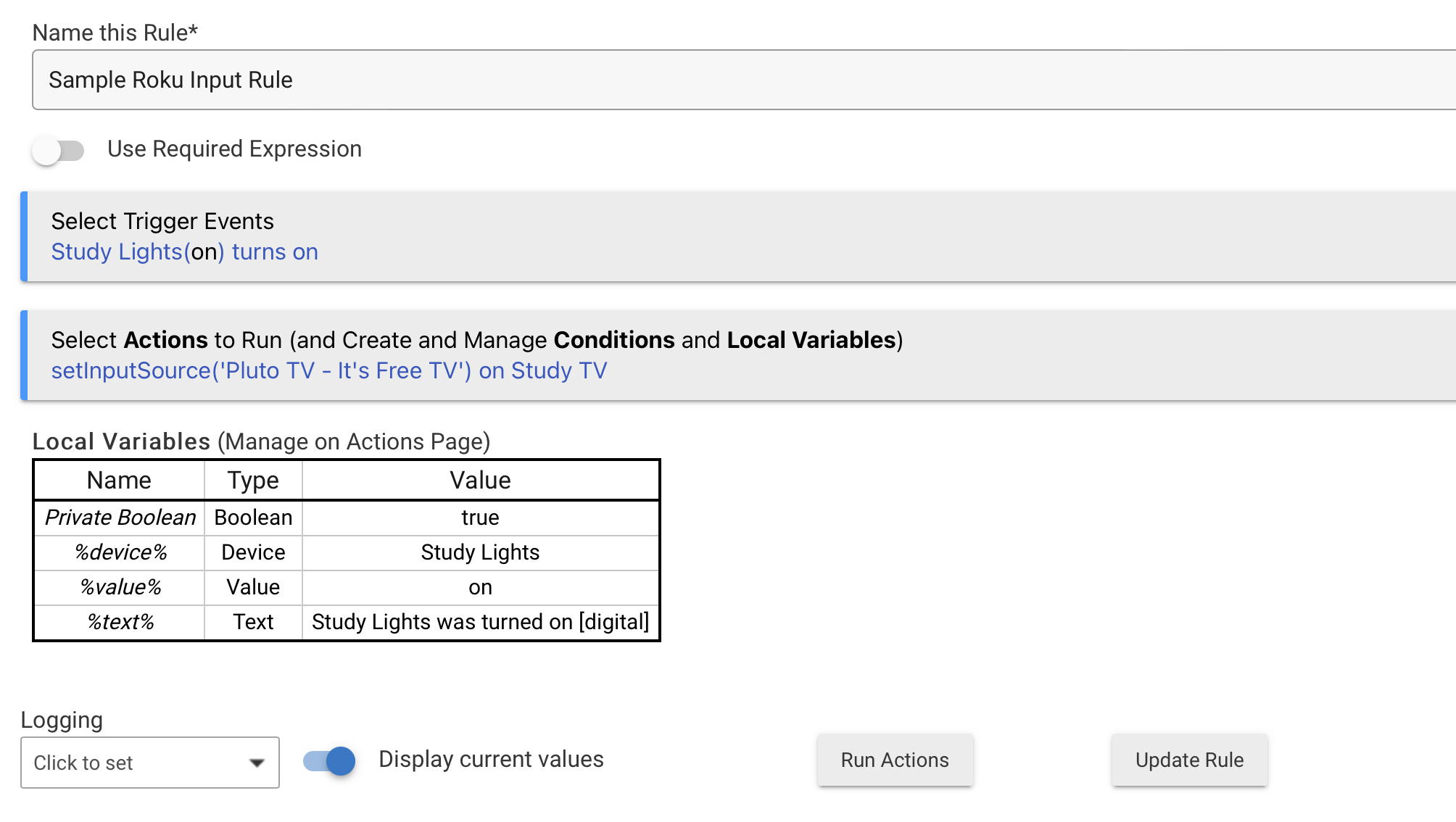

Does anyone have a rule machine example to set the input?
I just made one and it worked fine. Hope this helps.

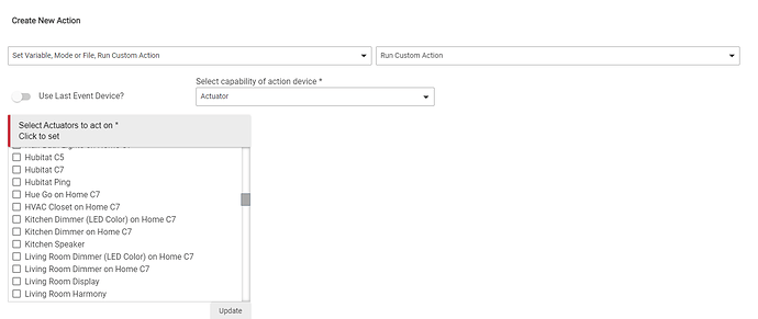

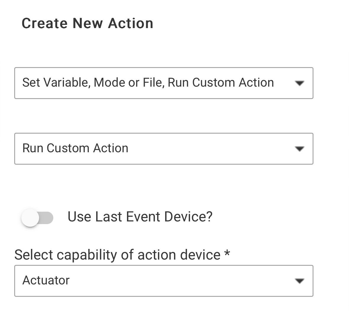

To set the input source use custom action
Then select the device, and the custom action. The argument you pass will be the name of the input source from the JSON list, sans quotes.
IS there a reason why my Roku TV wouldn't show up? The device is Kids TV but its not in the list.
Sorry my screen shot was wrong. Use switch, not actuator.
