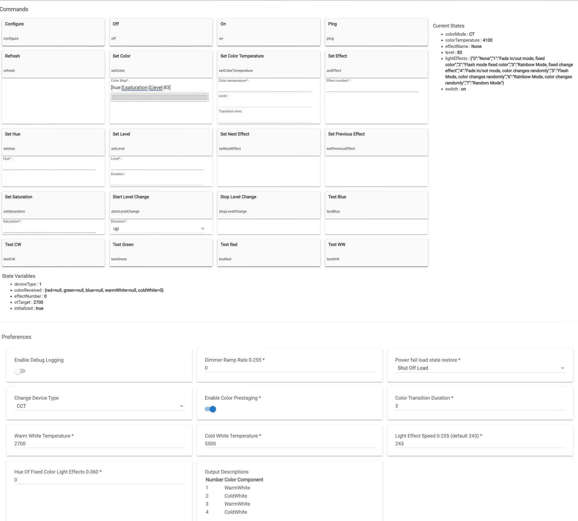

I have the ZW controller/driver combo connected to CCT tuneable white LEDs. Everything works fine... except that the Set Colour Temperature commands are bass-ackwards. Asking for 2200k results in daylight, and vice versa. What have I done wrong?
Well, four months later I've decided I should try and fix this.

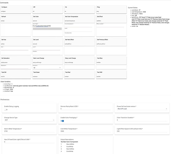

Changing colour temp in the driver results in this in the logs:
dev:5062023-06-14 08:05:47.545 AMerrorgroovy.lang.MissingMethodException: No signature of method: user_driver_rgbgenie_RGBGenie_LED_Controller_ZW_735.setColorTemperature() is applicable for argument types: (java.math.BigDecimal, java.math.BigDecimal) values: [5500, 100]
Possible solutions: setColorTemperature(java.lang.Object) (method setColorTemperature)
If I hit the "test CW" or "test WW" the LEDs change colour as expected.

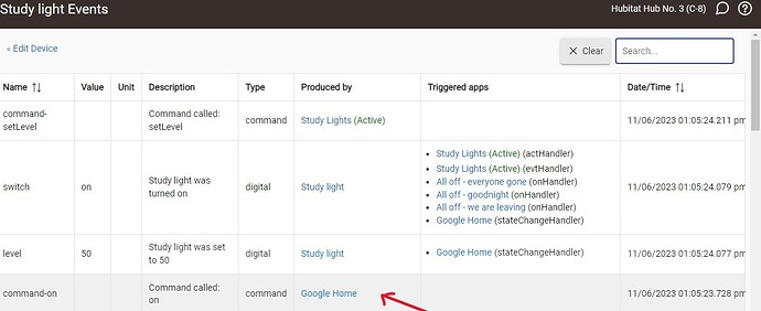

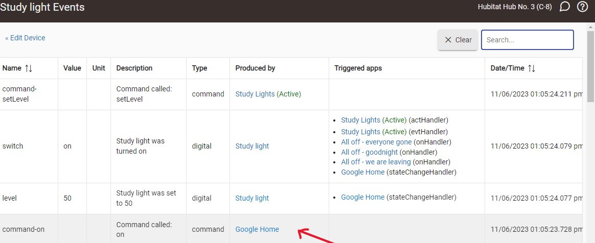

  4. What about the events logs for the actual device....For instance here is a screenshot of the events page for my study light when I tell Google to turn it on...

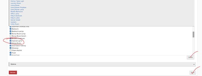

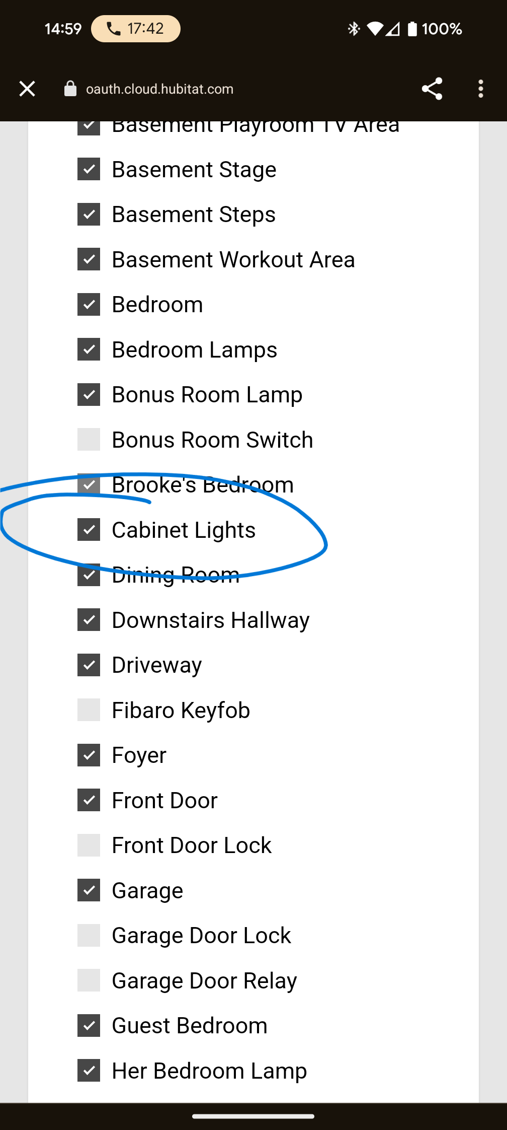

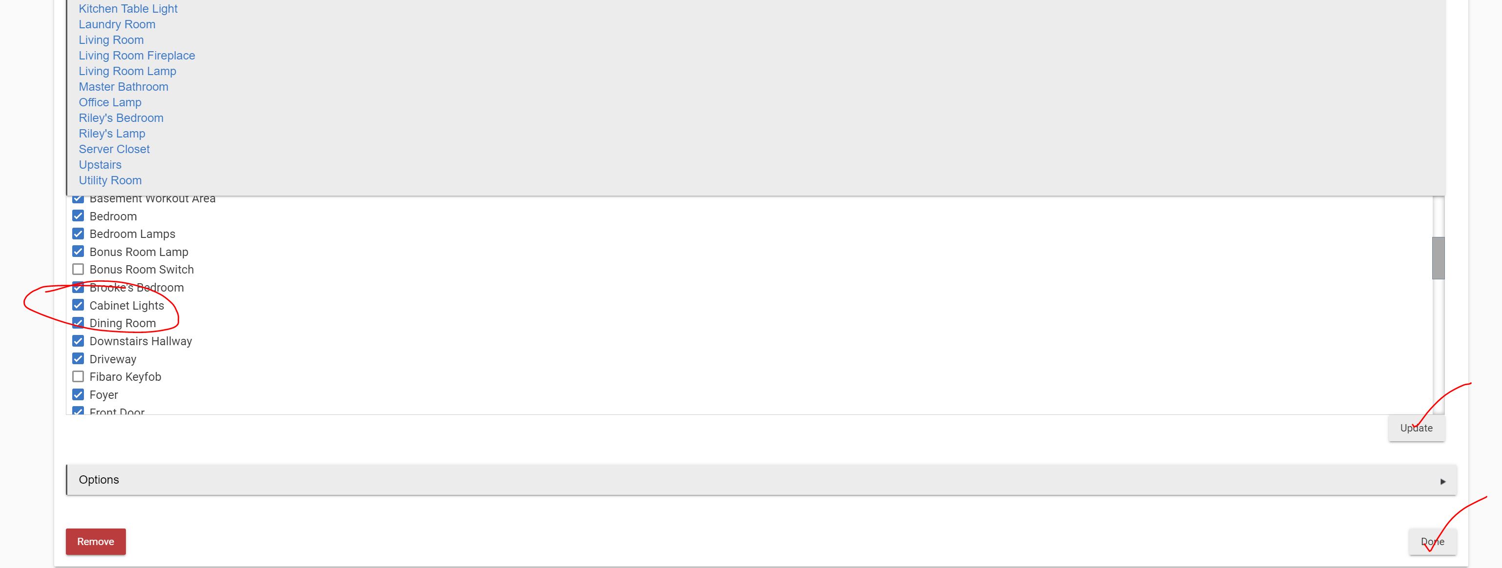

Some screenshots on my end:
After this process I verify that this devices it not showing up in Google Home and then when I go back into Hubitat that device is deselected in the Google Home Hubitat app.
This turns out it seems Google Home doesn't like the custom driver... I was having the same issue with a Zooz RGBW controller and their custom driver. As soon as I changed the RGB Genie device as well as the Zooz to the Generic RGBWW controller driver, they work in Google Home without any issues.
