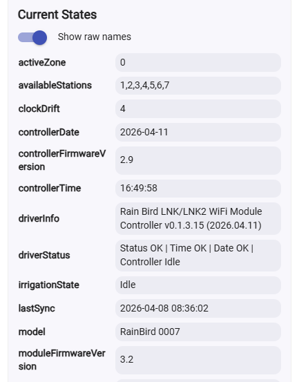

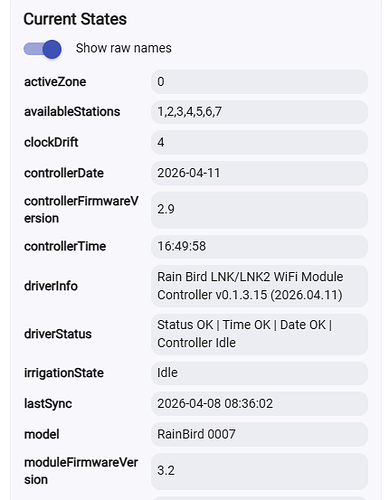

Take a look at the Current States and you should see something like this:
We're interested in availableStations, controllerFirmwareVersion, and moduleFirmware Version, and model.
You did have zones 1-8 working so I know it must understand which version of firmware you have or that wouldn't have worked before at all.
None of the capabilities are being populated because of the 503 overloaded errors.

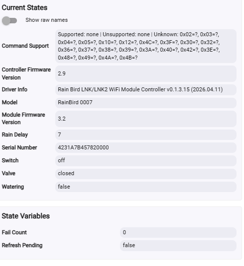

Ok....I set refresh to 8 hours. After doing nothing for about an hour, I then clicked initialize a single time. I was watching my live logs, and the time sync did ender the death loop, but it did stop after X times running. I didn't count. So that worked as it should have.
I still has all "?" for command support.
After then letting everything settle for a little bit, I clicked test all supported commands and here is what I have for current states.....still "?"

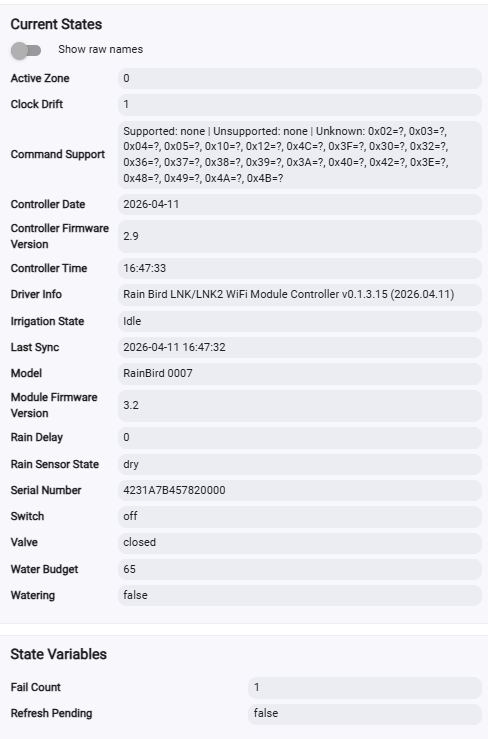

Excellent! Firmware 2.9 and Module 3.2. That is the same hardware setup I have.
What's interesting is that you are getting everything except for the number of zones. It's definitely communicating, or you wouldn't get firmware, date/time, model, serial number, etc.
Neither the availableStations or zoneCount attributes are even populating. That is most likely an initialization error, not a coding issue with the driver. We have the exact same hardware so I know it works here. At least that mystery is solved.
That failure and the commandSupport failure is what's odd. You're getting the date/time (opCodes 0x10 and 0x12) and identity/firmware (0x02, 0x03, 0x05), etc so... it has to be communicating with those codes yet the routine that tests EACH ONE of those is failing. That looks like a stale session problem (common to Hybrid 2.9 controllers behind module FW 3.2). The clock issue also seems to suggest a comms issue.

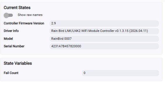

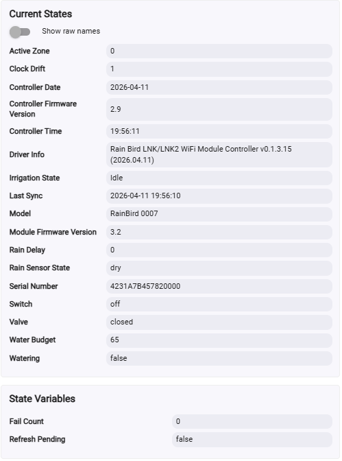

No joy.
Did exactly you said in those 7 steps. (Step 5....I assume you mean the Device page > Commands, right?)
With only the Initialize button pressed, here is my current state and even lower is my logs

warn
[Rain Bird LNK/LNK2 WiFi Module Controller] sendRainbirdCommand() exception: status code: 503, reason phrase: Service Unavailable
dev:1582026-04-11 07:55:51.424 PM
info
[Rain Bird LNK/LNK2 WiFi Module Controller] lastSync=2026-04-11 19:55:51 (Clock synchronized at 2026-04-11 19:55:51 | Drift corrected: 11298s)
dev:1582026-04-11 07:55:51.398 PM
warn
dev:1582026-04-11 07:55:51.385 PM
info
[Rain Bird LNK/LNK2 WiFi Module Controller] clockDrift=11298 (Clock drift: 11298s)
dev:1582026-04-11 07:55:51.124 PM
warn
dev:1582026-04-11 07:55:50.621 PM
warn
dev:1582026-04-11 07:55:49.877 PM
info
[Rain Bird LNK/LNK2 WiFi Module Controller] lastSync=2026-04-11 19:55:49 (Clock synchronized at 2026-04-11 19:55:49 | Drift corrected: 11296s)
dev:1582026-04-11 07:55:49.852 PM
warn
dev:1582026-04-11 07:55:49.841 PM
info
[Rain Bird LNK/LNK2 WiFi Module Controller] clockDrift=11296 (Clock drift: 11296s)
dev:1582026-04-11 07:55:49.577 PM
warn
dev:1582026-04-11 07:55:49.070 PM
warn
dev:1582026-04-11 07:55:48.327 PM
info
[Rain Bird LNK/LNK2 WiFi Module Controller] lastSync=2026-04-11 19:55:48 (Clock synchronized at 2026-04-11 19:55:48 | Drift corrected: 11295s)
dev:1582026-04-11 07:55:48.303 PM
warn
dev:1582026-04-11 07:55:48.293 PM
info
[Rain Bird LNK/LNK2 WiFi Module Controller] clockDrift=11295 (Clock drift: 11295s)
dev:1582026-04-11 07:55:48.032 PM
warn
dev:1582026-04-11 07:55:47.492 PM
warn
dev:1582026-04-11 07:55:46.749 PM
info
[Rain Bird LNK/LNK2 WiFi Module Controller] lastSync=2026-04-11 19:55:46 (Clock synchronized at 2026-04-11 19:55:46 | Drift corrected: 11293s)
dev:1582026-04-11 07:55:46.725 PM
warn
dev:1582026-04-11 07:55:46.714 PM
info
[Rain Bird LNK/LNK2 WiFi Module Controller] clockDrift=11293 (Clock drift: 11293s)
dev:1582026-04-11 07:55:46.452 PM
warn
dev:1582026-04-11 07:55:45.945 PM
warn
dev:1582026-04-11 07:55:45.204 PM
info
[Rain Bird LNK/LNK2 WiFi Module Controller] lastSync=2026-04-11 19:55:45 (Clock synchronized at 2026-04-11 19:55:45 | Drift corrected: 11292s)
dev:1582026-04-11 07:55:45.179 PM
warn
dev:1582026-04-11 07:55:45.167 PM
info
[Rain Bird LNK/LNK2 WiFi Module Controller] clockDrift=11292 (Clock drift: 11292s)
dev:1582026-04-11 07:55:44.905 PM
warn
dev:1582026-04-11 07:55:44.394 PM
warn
dev:1582026-04-11 07:55:43.652 PM
info
[Rain Bird LNK/LNK2 WiFi Module Controller] lastSync=2026-04-11 19:55:43 (Clock synchronized at 2026-04-11 19:55:43 | Drift corrected: 11290s)
dev:1582026-04-11 07:55:43.628 PM
warn
dev:1582026-04-11 07:55:43.617 PM
info
[Rain Bird LNK/LNK2 WiFi Module Controller] clockDrift=11290 (Clock drift: 11290s)
dev:1582026-04-11 07:55:43.355 PM
warn
dev:1582026-04-11 07:55:42.856 PM
warn
dev:1582026-04-11 07:55:42.101 PM
info
[Rain Bird LNK/LNK2 WiFi Module Controller] lastSync=2026-04-11 19:55:42 (Clock synchronized at 2026-04-11 19:55:42 | Drift corrected: 11289s)
dev:1582026-04-11 07:55:42.081 PM
warn
dev:1582026-04-11 07:55:42.035 PM
info
[Rain Bird LNK/LNK2 WiFi Module Controller] clockDrift=11289 (Clock drift: 11289s)
dev:1582026-04-11 07:55:41.773 PM
warn
dev:1582026-04-11 07:55:41.764 PM
warn
dev:1582026-04-11 07:55:41.754 PM
warn
[Rain Bird LNK/LNK2 WiFi Module Controller] getAvailableStations(): No response
dev:1582026-04-11 07:55:41.753 PM
warn
dev:1582026-04-11 07:55:41.743 PM
warn
[Rain Bird LNK/LNK2 WiFi Module Controller] getRainDelay: No valid response
dev:1582026-04-11 07:55:41.742 PM
warn
dev:1582026-04-11 07:55:41.724 PM
warn
[Rain Bird LNK/LNK2 WiFi Module Controller] getWaterBudget: No valid response
dev:1582026-04-11 07:55:41.722 PM
warn
dev:1582026-04-11 07:55:41.709 PM
warn
[Rain Bird LNK/LNK2 WiFi Module Controller] getRainSensorState(): No valid response
dev:1582026-04-11 07:55:41.708 PM
warn
dev:1582026-04-11 07:55:41.698 PM
warn
[Rain Bird LNK/LNK2 WiFi Module Controller] No compatible controller-state opcode (4C/3F) supported; skipping zone status refresh.
dev:1582026-04-11 07:55:41.696 PM
warn
dev:1582026-04-11 07:55:41.683 PM
warn
dev:1582026-04-11 07:55:41.674 PM
warn
dev:1582026-04-11 07:55:41.663 PM
warn
dev:1582026-04-11 07:55:41.654 PM
warn
dev:1582026-04-11 07:55:41.133 PM
info
[Rain Bird LNK/LNK2 WiFi Module Controller] Refresh scheduled every 240 minute(s) (offset 2) using CRON '0 0 2/4 ? * * *'.
dev:1582026-04-11 07:55:41.113 PM
warn
dev:1582026-04-11 07:55:40.268 PM
info
[Rain Bird LNK/LNK2 WiFi Module Controller] driverInfo=Rain Bird LNK/LNK2 WiFi Module Controller v0.1.3.15 (2026.04.11)

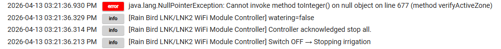

Also, when trying to run zone 1, I get a single line on my log:
2026-04-11 08:00:07.114 PM
error
[Rain Bird LNK/LNK2 WiFi Module Controller] runZone() failed: Cannot invoke method toInteger() on null object
I turned the clock sync back off just for easier debugging. Here is what my initialize looks like after unplugging the LNK module, and then pugging it back in and pressing Initialize and ONLY that.
Summary
dev:1582026-04-11 08:12:05.949 PM
warn
dev:1582026-04-11 08:12:05.930 PM
warn
dev:1582026-04-11 08:12:05.921 PM
warn
dev:1582026-04-11 08:12:05.919 PM
warn
dev:1582026-04-11 08:12:05.873 PM
warn
dev:1582026-04-11 08:12:05.872 PM
warn
dev:1582026-04-11 08:12:05.864 PM
warn
dev:1582026-04-11 08:12:05.862 PM
warn
dev:1582026-04-11 08:12:05.855 PM
warn
dev:1582026-04-11 08:12:05.853 PM
warn
dev:1582026-04-11 08:12:05.846 PM
warn
dev:1582026-04-11 08:12:05.844 PM
warn
dev:1582026-04-11 08:12:05.834 PM
warn
dev:1582026-04-11 08:12:05.825 PM
warn
dev:1582026-04-11 08:12:05.816 PM
warn
dev:1582026-04-11 08:12:05.808 PM
warn
dev:1582026-04-11 08:12:05.287 PM
info
dev:1582026-04-11 08:12:05.270 PM
warn
dev:1582026-04-11 08:12:04.472 PM
info
Very strange indeed. I need to do some more hunting around. The oddest part is we're almost running the same hardware. I want to make sure that extra zone module isn't somehow messing with us. I doubt it but with Rain Bird one never knows.
I don't think this is an issue but... Go ahead and delete the device, and lets start from scratch. I want to see if we're tracking a ghost with those serial numbers and device types. Just like power cycling the module, it won't hurt anything.
Deleted the device.
Uninstalled the driver.
Rebooted HE hub.
Reinstalled driver via HPM
Recreated virtual device
Entered IP and password and also changed the sync time to 4 hours.
Clicked Initialize.
Here are my logs from start to finish. I'm not convinced it is EVER actually doing a handshake with my LNK.
Summary
dev:1652026-04-12 09:32:52.651 AM
warn
dev:1652026-04-12 09:32:52.640 AM
warn
dev:1652026-04-12 09:32:52.630 AM
warn
dev:1652026-04-12 09:32:52.627 AM
warn
dev:1652026-04-12 09:32:52.617 AM
warn
dev:1652026-04-12 09:32:52.615 AM
warn
dev:1652026-04-12 09:32:52.606 AM
warn
dev:1652026-04-12 09:32:52.604 AM
warn
dev:1652026-04-12 09:32:52.595 AM
warn
dev:1652026-04-12 09:32:52.593 AM
warn
dev:1652026-04-12 09:32:52.585 AM
warn
dev:1652026-04-12 09:32:52.583 AM
warn
dev:1652026-04-12 09:32:52.567 AM
warn
dev:1652026-04-12 09:32:52.522 AM
warn
dev:1652026-04-12 09:32:52.509 AM
warn
dev:1652026-04-12 09:32:52.496 AM
warn
dev:1652026-04-12 09:32:51.941 AM
warn
dev:1652026-04-12 09:31:32.474 AM
warn
dev:1652026-04-12 09:31:32.464 AM
warn
dev:1652026-04-12 09:31:32.454 AM
warn
dev:1652026-04-12 09:31:32.452 AM
warn
dev:1652026-04-12 09:31:32.434 AM
warn
dev:1652026-04-12 09:31:32.432 AM
warn

Also, my Current States is very empty. I ONLY clicked the Initialize button.
So I'm beginning to wonder if I have a hardware issue on the Rainbird side and nothing wrong on the HE side.
When using the app, it has always been finiky. It will frequenly give "communication error: the rain bird server has not received a responce from the controller. Please verify......" And frequently gives other random errors. There are other times where it starts to connect and download the schdule and just stops at a specific/random % complete.
I've always just assumed this was normal. Curious if you ever run into issues with the app (i'm using an iphone) where you have to "kill" the app, wait a bit and try again.
Maybe something with my router? Although your comment that these LNK devices are easily overwhelmed with requests sounds more like what I'm having happen. I wonder if my LNK is just constantly "tapping out".
Might could be :wink:
The driver is reading the model, serial number, and controller firmware but not the module firmware, which is really odd.
That, along with what we're seeing, sure does seem like an issue with the module itself, not your Wi-Fi connection. The reason I don't think it's the Wi-Fi connection is that our logs show those 503 errors (Service Unavailable) and not 408 (Request Timeout). IOW, we're getting a positive comm link that says, "I'm too busy" vs a "What? I can't hear you." message.
If you're getting app errors like that and over random errors, I honestly don't think its this driver. Rain Bird's app not working on their hardware might be the smoking gun.
Do you have access to another module? Perhaps a neighbor has similar hardware?
No, I don't have access to any other modules to swap out.
If I Run "Test all supported commands" the module firmware DOES show up.....v3.2.
One thing that I noticed.....that Serial Number; It doesn't match the serial number on my esp-me or my LNK. Is that normal?

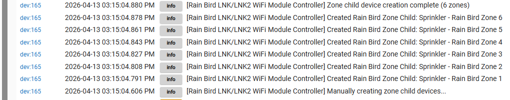

Ok....so total random curveball. I AM able to set rain delays. I put 7 days and click set, no errors on the logs and I go to the app and it does show a 7 day rain delay.......So clearly the two are talking.
Also, it if I "create zone children" it does successfully create zones 1-6.
Inside that child device, nothing works EXCEPT the Off button does give me a controller reply
Another test....I can turn a zone on with my phone, and when I click "Turn Irrigation Off" it DOES turn the sprinkler off and I get this log:

Creating the child devices is 100% controlled with the driver. The controller and comms have nothing to do with that which is why it works.
Being able to stop a running zone means it's responding to the one STOP opcode. The problem is, without the driver knowing precisely which version of firmware its talking to, everything will always be hit-or-miss.
The same for rain delay opcode. That isn't firmware specific.
That error for line 677 comes from the driver not knowing which zones are available (null) so it can't verify zone (null) is off.
It's not a Wi-Fi issue. A Wi-Fi issue won't cause 503 errors. If the driver can't cleanly get a response to which opcodes are available or not (all those '?' responses), it can't properly control anything.
From the thread here, v0.1.3.3 was what was working for you, except for the clamping of zones 9 & 10. I'll grab a copy of that version and update the clamp only and put it on git for you. If that works, at least we'll have a known good and can see exactly what's causing the issue.
Posting this here for any future folks that may have the same issue as I did.
IF you have an ESP-ME with a zone expander and maybe the light grey original LNK module and you run into a bunch of issues as discussed above, please DM myself or MHedish. Offline we were able to get my system working. It requires some very unique modification to the driver code that really only applied to my specific setup so MHedish isn't posting those changes publicly as it is likely to do more harm that good. So if you are running into issues of not all your zones showing up, or your zone numbers showing up weird, let either of us know and can send you the "tweaked" driver code that works for my hodge-podge setup.
