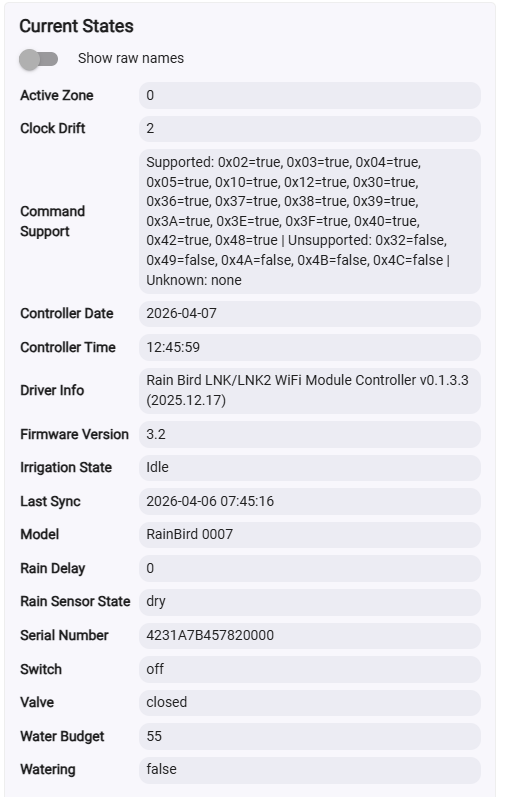

That will populate which commands the controller is capable of handling:
commandSupport
Supported: 0x02=true, 0x03=true, 0x04=true, 0x05=true, 0x10=true, 0x12=true, 0x30=true, 0x36=true, 0x37=true, 0x38=true, 0x39=true, 0x3A=true, 0x3E=true, 0x3F=true, 0x40=true, 0x42=true, 0x48=true | Unsupported: 0x32=false, 0x49=false, 0x4A=false, 0x4B=false, 0x4C=false | Unknown: none

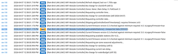

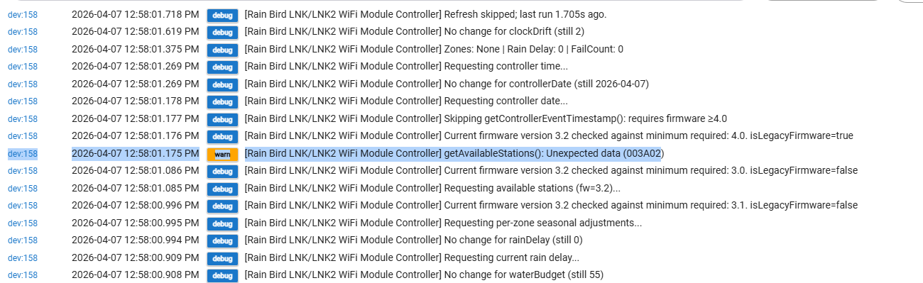

Mine doesn't show available stations.
You have one of those wonderful edge cases with Rain Bird.
00A3A02 is the tell.
Rain Bird's APIs are not well documented, and their firmware changes are often not backwards compatible, and the firmware version does not reliably indicate opcode support.

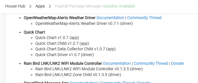

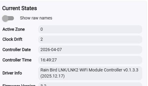

So… I made a slight change to the code and pushed it to HPM. Run an update to get v0.1.3.5 and it should report all 10 zones and then be able to control zones 9 and 10 properly.

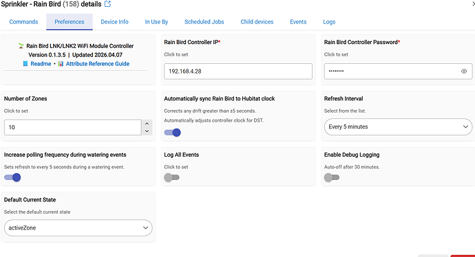

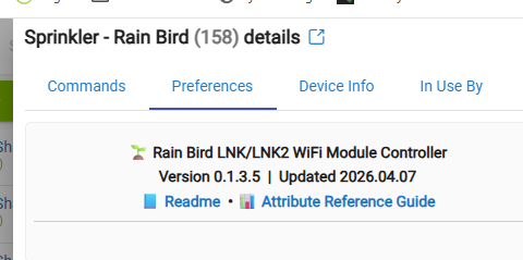

Hmmmmm. HPM is now showing 1.3.5, Device prefrenes also shows 1.3.5, however the driver info in "current states" still shows 1.3.3
And clicking run on the create zone children doesn't fix it. Also test all supported commands yields the errors shown below.
The version number attribute not being updated is a Hubitat thing. It repopulates when the preferences are updated or the driver is reinitialized.
Just click on the "Initialize" command and it will update and ensure you're running the newly updated code.

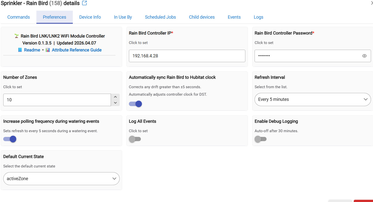

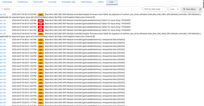

Double-check your preferences too. The URI in your screenshot is http://null/irrigation/status.json
It shouldn't be null.
I did the initialize and then retried everything with no luck. I am still getting the null as well. My preferences are this:
I found the 'null' :beetle:. :slightly_frowning_face:
It didn't appear when I tested it against my controller. Updating the code to address your 00A3A02 issue exposed it. So, I thank you for the testing.
I'll fix it on my end and push another update.

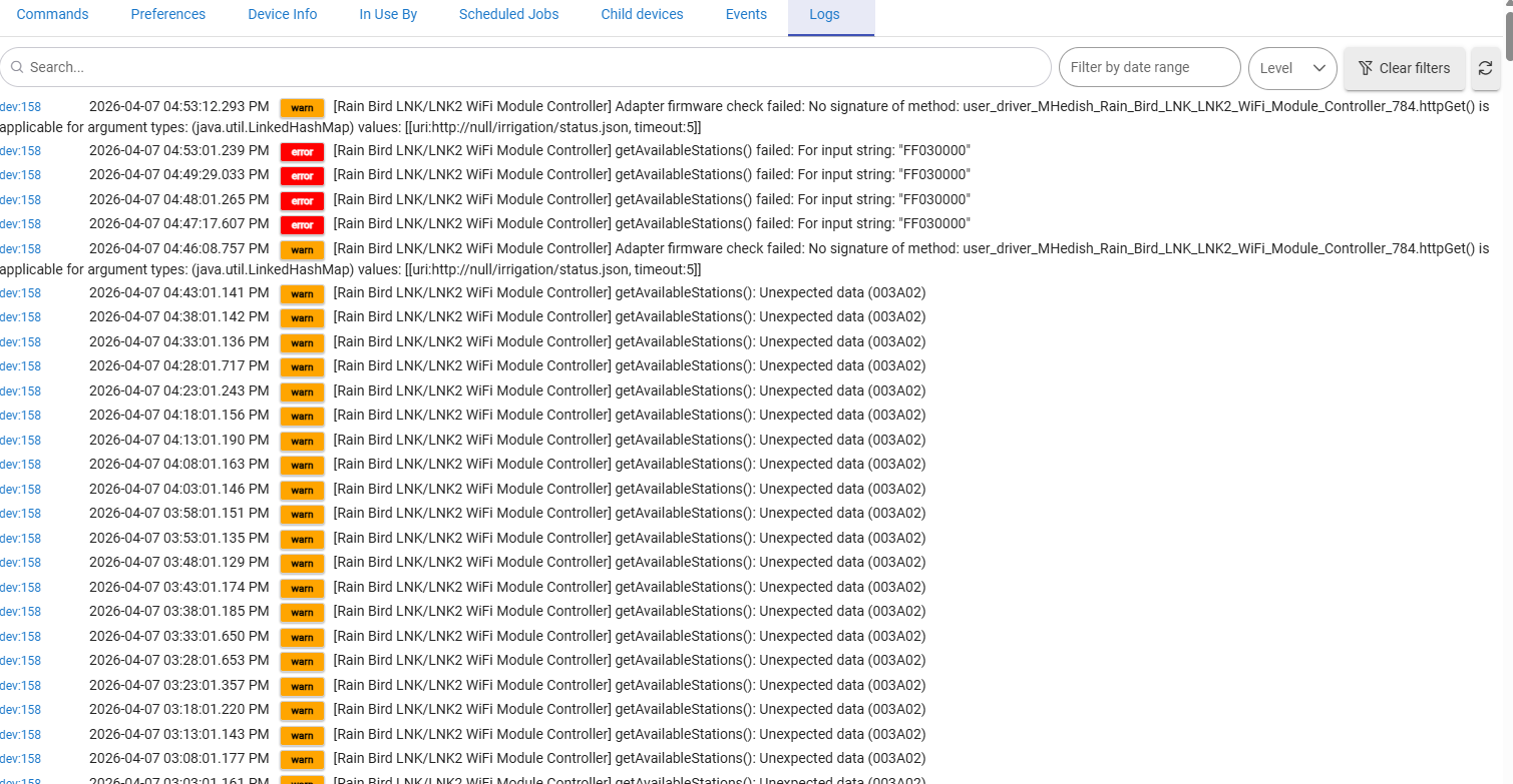

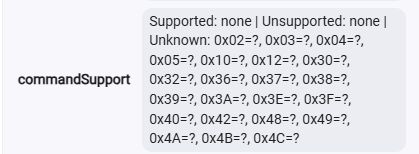

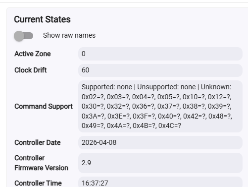

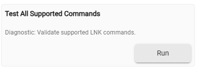

We may have crashed in pit row........i clicked Initialize and then test all supported commands. Stoll no available stations listed, an also now the command support has gone wonky.
No... Getting Controller Firmware 2.9 is a good sign. What happens when you refresh and/or reinitialize? Command Support is just for diags. We don't need that at the moment. I've seen that with my controller and then when it refreshes, it populates. It has to do with the timing.
Screenshots are close to useless for troubleshooting. Make sure you turn on Log All Events and Debug Logging. The logs are what we need to figure out what's happening, not screenshots.
It's like sending a cell phone pic of your car dashboard vs connecting to the OBDII and reading the codes. "Check Engine" isn't helpful. The actual codes from the ECU is. :wink:
Also... Outside of the command list. Are you able to properly control zones 9 and 10 now? That should be working.

That button is only for diags, it doesn't have any influence on the operation or gathering of zones. Like I said in the previous post, the fact that your populating both controller firmware and module firmware is important.

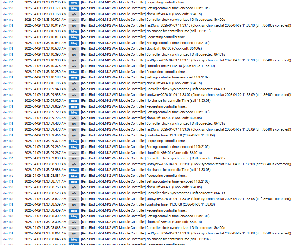

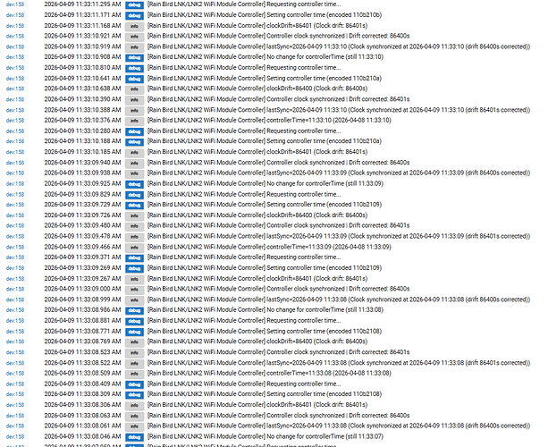

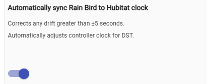

That error is date-related. Some firmware versions use a single code to update date/time and others use two, one date, one time. Clearly, you have one that is different from mine. The clock is being reset, but the date in your controller is still off by one day so it keeps retrying. I'll add a guard so it will stop retrying forever if the update fails like this.

The clock sync is minor compared to getting the driver to control the valves.
Are you able to control the valves now, or was that also reverted? We need to get you back where you were when the main issue was zones 9 and 10 not working. I know that's fixed as log as you can control anything. That was a simple clamping issue.
As for how to share the logs, do what I did above. Instead of a screenshot, highlight the log text you want to share and then right-click and copy. You can paste it in as text and use the Hide Details option here to shrink it down. Or, just DM it to me.
Also, what versions of firmware are being reported (controller and module)? The error is real, but without knowing which firmware you're running, I don't know which opcodes are available for us.
Ok, I turned off the time sync. I reenabled the device, clicked initialize and then clicked the test all commands. Following that, I tried zone 1 and then zone 5. Now none of the zones work. My for this entire process are as follows:

[Rain Bird LNK/LNK2 WiFi Module Controller] driverInfo=Rain Bird LNK/LNK2 WiFi Module Controller v0.1.3.11 (2026.04.08)
in the Current States portion, the Controller Firmware is said to be 2.9. Module firmware "unknown"
Also.....FWIW, I have the LNK Wifi Module (light gray) for my ESP-Me....not the LNK2 module (dark gray).
Just pushed v0.1.3.15 to Git and HPM.
:star2: What’s New in v0.1.3.15
  • Fixed clock sync retry loop by suppressing false ±86400-second drift after opcode 11 (Set Time)
  • Improved command support probing reliability by retrying ACK-only opcode 04XX responses.
  • Hardened opcode 04XX command-support detection
  • Added dynamic runtime controller-state opcode-family inference (4C vs 3F)
The “death spiral” should be a thing of the past. :wink: That infinite loop was a new one for me. There's something different in your controller firmware than I've seen. I still really need to know which version you have for both the controller and module.
The commandSupport diagnostic should work for you now. I add retry if the controller is busy so you should see something like this:
commandSupport=Supported: 0x02=true, 0x03=true, 0x04=true, 0x05=true, 0x10=true, 0x12=true, 0x3F=true, 0x30=true, 0x36=true, 0x37=true, 0x38=true, 0x39=true, 0x3A=true, 0x40=true, 0x42=true, 0x3E=true, 0x48=true | Unsupported: 0x4C=false, 0x32=false, 0x49=false, 0x4A=false, 0x4B=false | Unknown: none (Command support diagnostic complete.)
instead of all those unknowns like this:
commandSupport=Supported: 0x02=?, 0x03=?, 0x04=?, 0x05=?, 0x10=?, 0x12=?, 0x30=?, 0x36=?, 0x37=?, 0x38=?, 0x39=?, 0x3A=?, 0x3E=?, 0x3F=?, 0x40=?, 0x42=?, 0x48=? | Unsupported: 0x32=?, 0x49=?, 0x4A=?, 0x4B=?, 0x4C=? | Unknown: none (Command support diagnostic complete.)
I also reordered the controller capability probe order so it is now queried by capability group rather than opcode order.
OpCode Command Group
02,03,04,05 identity / firmware / capability handler
10,12 clock / date
4C,3F controller state (primary first)
30,32 configuration
36,37,38,39,3A program runtime ops
3E sensor
40,42 irrigation control
48,49,4A,4B extended telemetry
The theory here, from what I can gather from other implementations is this should remove
  • Hybrid fallback oscillation (v2.9)
  • LNK2 secure-mode stub masking
  • Controller-state opcode flip-flop selection
Give it a whirl and let me know what you're seeing. Unfortunately, I'm at the "works great here" stage and can't test against your controller.
Updated.
Death Spiral is Gone.
Still no zone functions at all.
Command support still shows all the question marks.
Here are my logs from Initialize - All Commands - Run Zone 1

dev:1582026-04-11 03:38:42.565 PM
warn
[Rain Bird LNK/LNK2 WiFi Module Controller] getCommandSupport(): No valid response
dev:1582026-04-11 03:38:42.564 PM
warn
[Rain Bird LNK/LNK2 WiFi Module Controller] sendRainbirdCommand() exception: status code: 503, reason phrase: Service Unavailable
dev:1582026-04-11 03:38:42.557 PM
debug
[Rain Bird LNK/LNK2 WiFi Module Controller] Querying command support for 0x3F...
dev:1582026-04-11 03:38:42.556 PM
warn
dev:1582026-04-11 03:38:42.554 PM
warn
dev:1582026-04-11 03:38:42.545 PM
debug
[Rain Bird LNK/LNK2 WiFi Module Controller] Querying command support for 0x4C...
dev:1582026-04-11 03:38:42.544 PM
info
[Rain Bird LNK/LNK2 WiFi Module Controller] serialNumber=Unavailable (Controller serial number: Unavailable)
dev:1582026-04-11 03:38:42.539 PM
warn
dev:1582026-04-11 03:38:42.531 PM
info
[Rain Bird LNK/LNK2 WiFi Module Controller] controllerFirmwareVersion=Unknown (Controller firmware version: Unknown)
dev:1582026-04-11 03:38:42.525 PM
info
[Rain Bird LNK/LNK2 WiFi Module Controller] model=RainBird Unknown (Controller model: Rain Bird Unknown)
dev:1582026-04-11 03:38:42.523 PM
warn
[Rain Bird LNK/LNK2 WiFi Module Controller] ModelAndVersionRequest failed or unexpected: null
dev:1582026-04-11 03:38:42.522 PM
warn
dev:1582026-04-11 03:38:42.514 PM
debug
[Rain Bird LNK/LNK2 WiFi Module Controller] Requesting controller identity (model/firmware/serial)...
dev:1582026-04-11 03:38:42.512 PM
warn
dev:1582026-04-11 03:38:42.503 PM
warn
dev:1582026-04-11 03:38:42.494 PM
warn
dev:1582026-04-11 03:38:42.484 PM
debug
[Rain Bird LNK/LNK2 WiFi Module Controller] Starting driver self-test sequence...
dev:1582026-04-11 03:38:42.460 PM
debug
[Rain Bird LNK/LNK2 WiFi Module Controller] Controller IP = 192.168.4.28, Password = ********
dev:1582026-04-11 03:38:42.459 PM
info
[Rain Bird LNK/LNK2 WiFi Module Controller] driverInfo=Rain Bird LNK/LNK2 WiFi Module Controller v0.1.3.15 (2026.04.11)
I only have one controller, but I do have both modules. The modules only control the Wi-Fi capability. Everything we're running into is related to the controller firmware. That's how I ended up with two modules. I was hoping the module would give me “newer” firmware; it doesn't. I learned the hard way here.
The controllers are not field upgradable.
Stick with the older module. If you look through the thread, you'll see what @rgr unfortunately learned about the module. Whatever you do, don't update the module's firmware. Stick with the LNK. Updating the module firmware locks you out of local control.
I believe 0.1.3.15 finally addresses the firmware version flapping he and I were seeing back in January. The module and controller firmware are now separate attributes. Looking back, that “flapping” was the driver seeing both attributes and conflating them into a single version.
