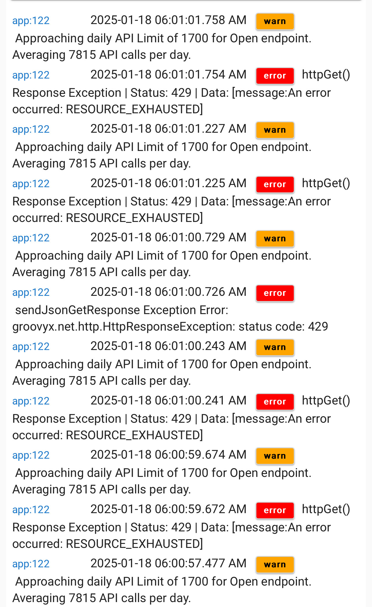

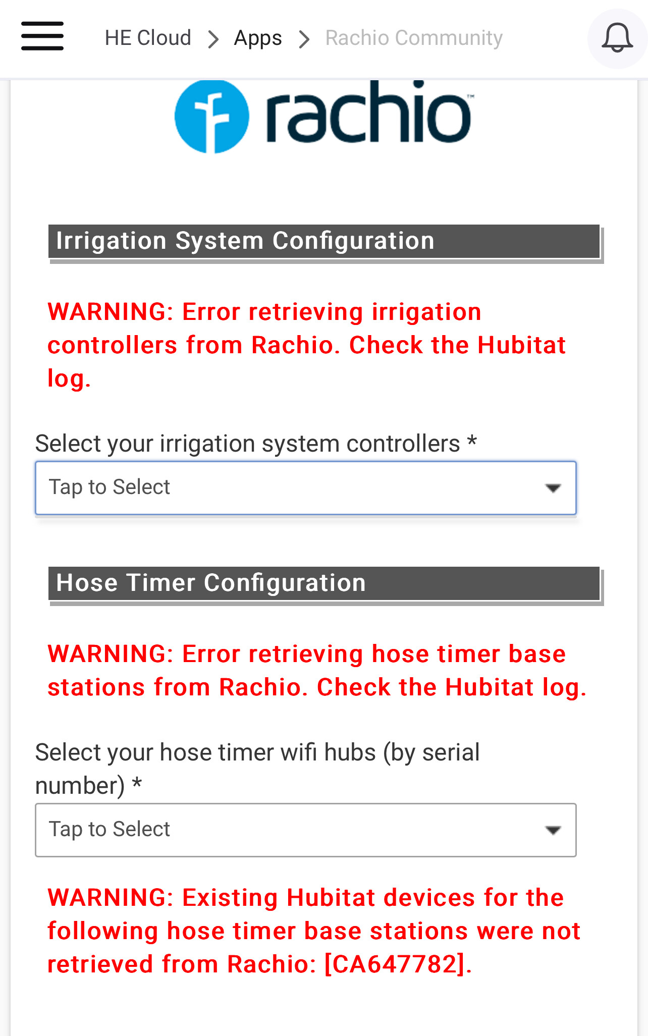

I updated and I only have two hose timers. Since the update I’m seeing this. Nothing is selectable in the drop downs and I cannot click done.
Recommendation to get past this? My hose timers have batteries in them but are put away for the winter.

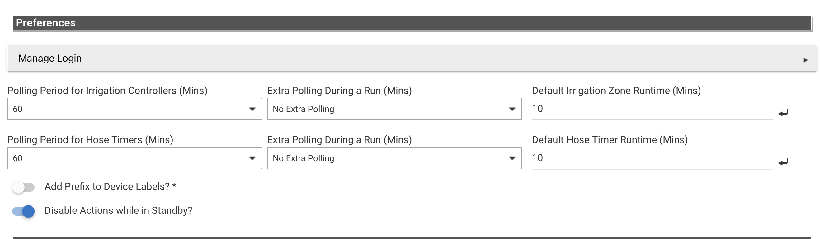

Those errors must be attributable to something else besides this last update. It's telling you that you have exceeded the allowable API calls per day. What's your polling rate set to?
Also, this error should resolve on its own after Rachio resets the API call limit the next day.
Sorry where do I check that?

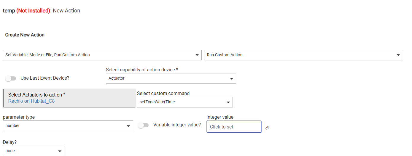

Is it possible to modify the SetZoneWaterTime property? I am trying to create a Rule Machine automation that factors in the temperature to calculate a variable bonus watering time for the summer months.
In the automation, it seems like you can only control a zone like an on/off switch, which will turn on a zone to run for SetZoneWaterTime minutes.
You mean like this?
That's exactly what I was looking for... thanks! :grinning:
