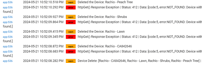

but devices for them don't exist in the devices list for the hub. I see this in the logs:

While trying to get the wifi hub and timers installed I checked the logs and noticed this error:
I had tried to set the poll interval to 60 minutes to see if that would help. However, it appears the CRON string stopped something essential from completing. When I changed it to 30 minutes it completed and I got my devices back.

@JustinL, thanks for your continued work on this. May I ask one question: on those occasions that we get the "resource_exhausted" error because of excessive polling, I notice that the applicatioin deletes the hose timers and wifi node. When Rachio's block times out I need to go back to reinstall them. Can't you just leave those devices installed so they start to work again when the block is lifted?
