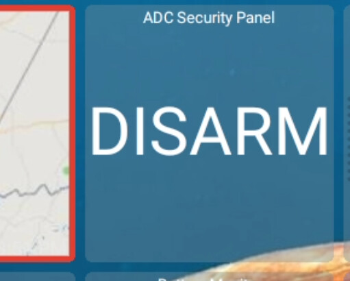

@dcaton1220 I have a request if you feel up to it. Right now, when disarmed, the partition attribute shows "disarm." The ask is simply (realizing that simple does not always mean simple) to have that show "DISARMED" instead.
For everyone else, I found an interesting 'bug' on the panel itself. I had a RM rule to disarm the alarm when unlocking one of the doors using a lock code. If I hit my lock code and immediately opened the door, the disarm command would be issued about the same time the panel would go into entry delay. The 'bug' part is that the panel would show disarmed (green LED) but the count down and code request would still stay on the screen. No idea if the alarm would have actually triggered or not, but I got around the issue by adding a two second wait into the rule before sending the command.
I'm pretty sure that the partition attribute value mirrors the actual value sent from the panel. Changing it to "DISARMED", while perhaps more grammatically correct would likely be a breaking change.
In any case, I'm out of town for the next six weeks or so and do not have access to a panel to do any testing, so I'm really hesitant to make any changes to the driver I can't test.
No big deal. Was only asking if you find yourself twiddling your thumbs. It's really an edge case anyways. I have a tile in the Android Dashboards app to show current state, but, to someone not familiar, it would almost look like a button. As I'm thinking about it, that might not be a bad thing :smiley:

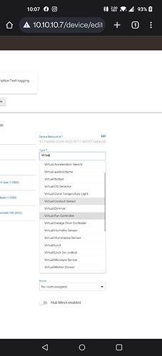

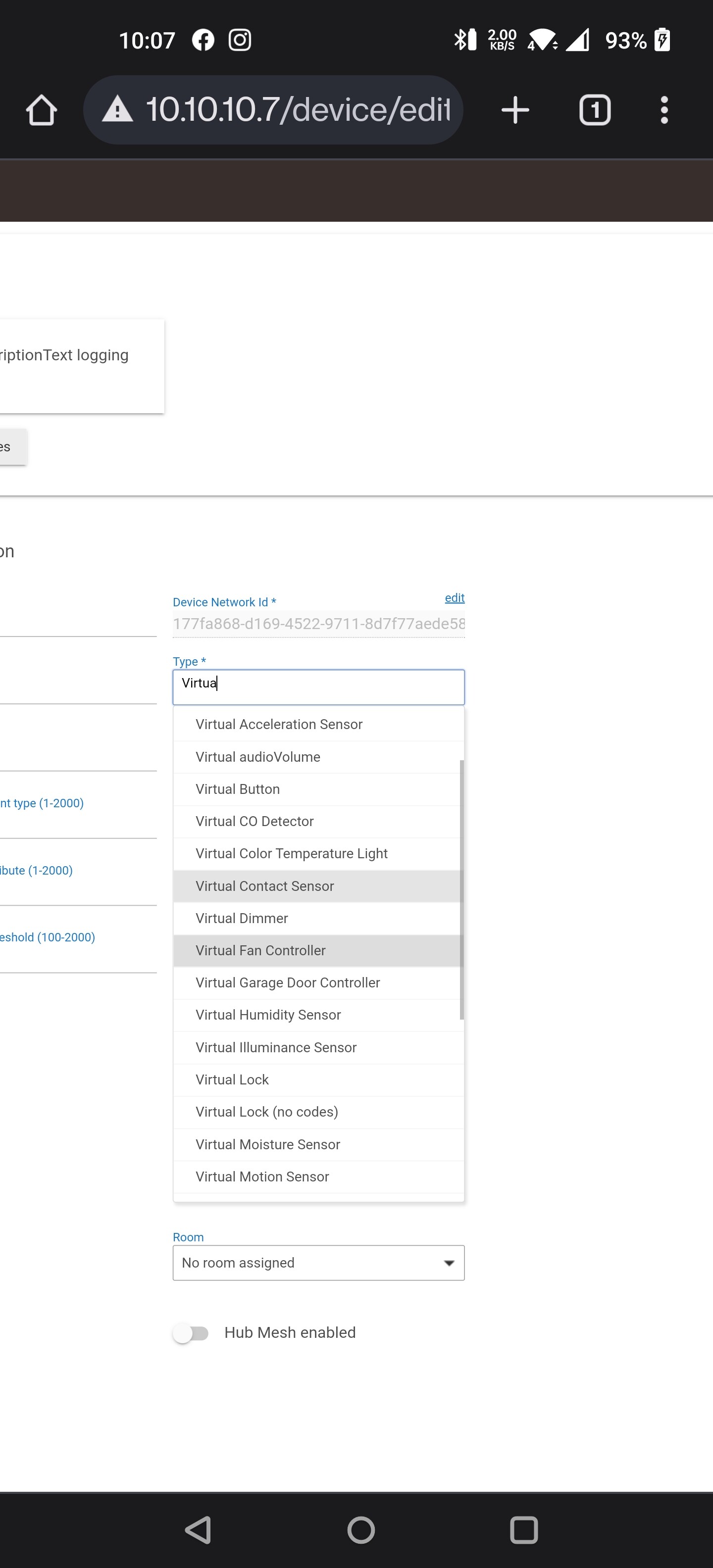

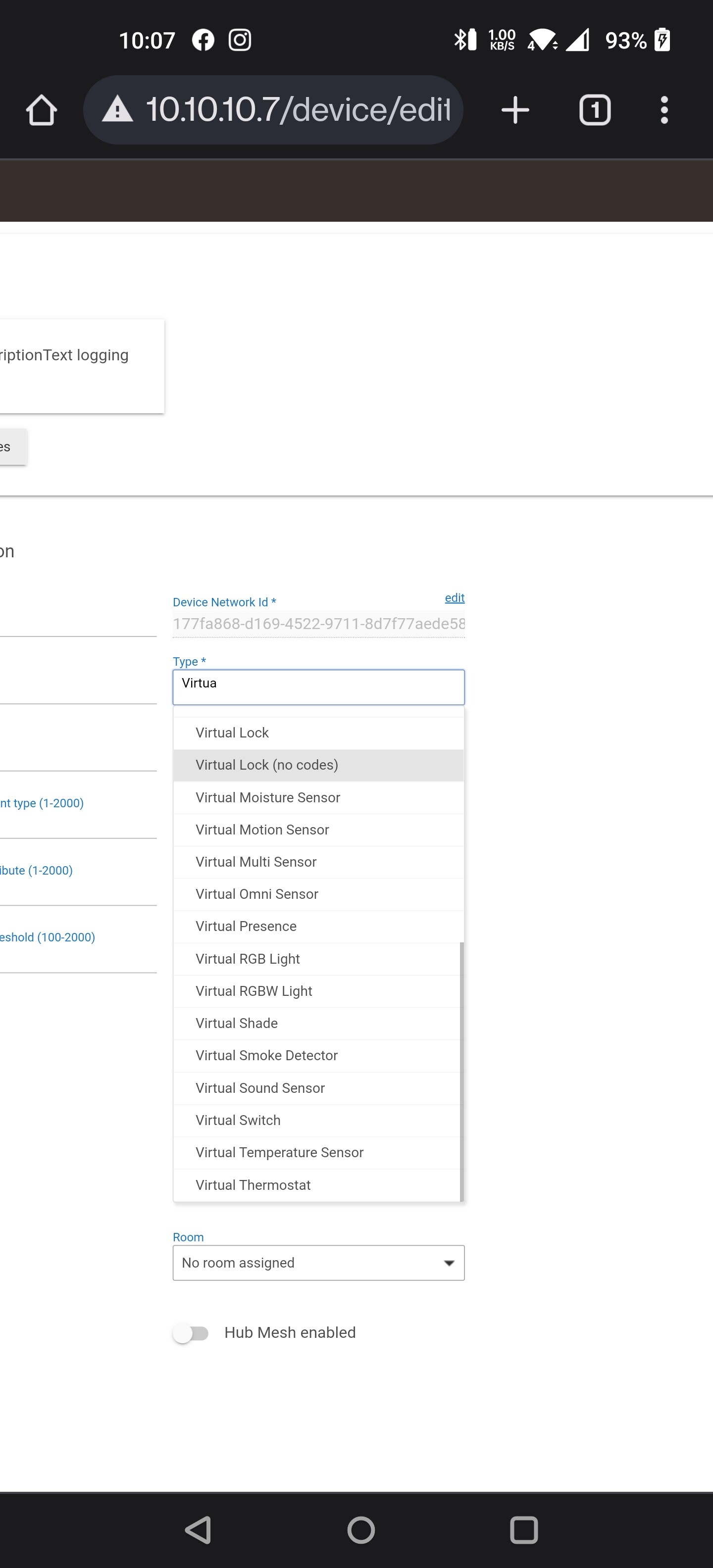

Where are you entering values?
I don't have "actuator" as a virtual device and I don't have any place to type in those commands within a "virtual switch".
Are you using rule machine?

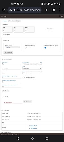

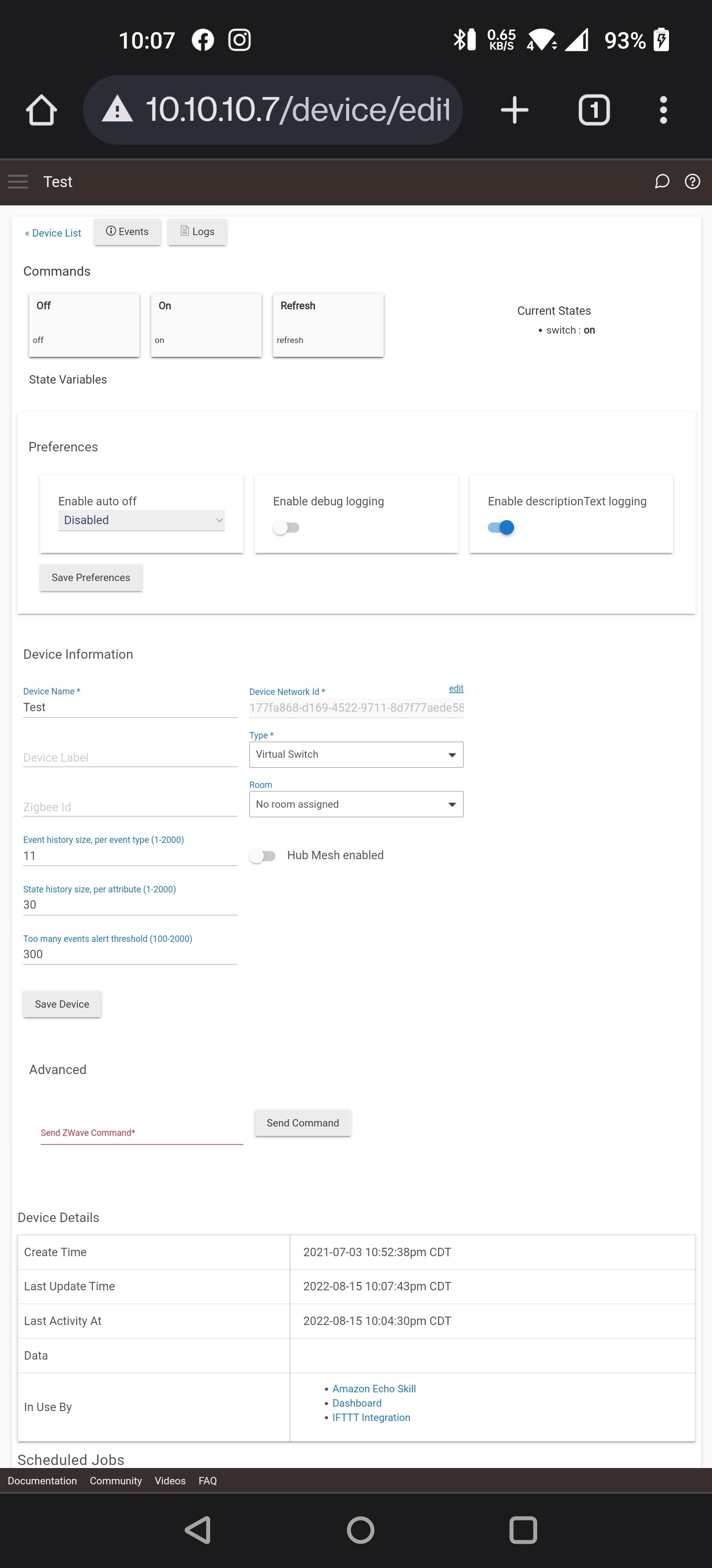

So, you create one virtual switch each for each mode you want to control (e.g., disarm switch, alarm stay). Set your virtual switch to auto turn off after 500 ms (that's long enough for Rule Machine to pick it up).
Create the rule like I posted above.
Each mode type in the panel driver has some attributes that must be included. Like "Arm Stay" needs to have the partition_id and bypass attributes passed (the user code too if you have secure arming enabled). Partition_id and bypass are both strings.

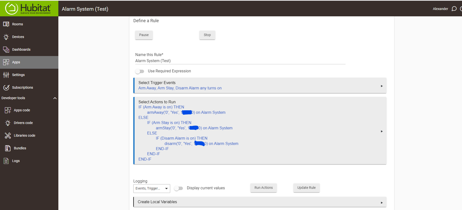

After some tinkering, I got Got "Arm Stay" to work.
Arm Away and Disarm dont seem to work. Any Suggestions? Am i missing something in the actions area?

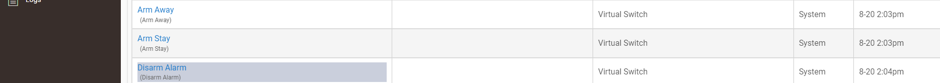

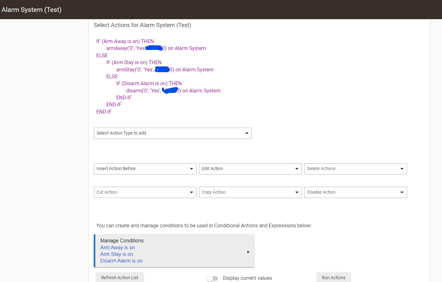

Attaching images of device area and rule macine rules. For now, all switches are set to auto off after 1 second.
Thank you again for all your help.
@user2173
So, the 'disarm' action only needs:
String: 0 (partition ID)
Number: PIN code
'Arm away' needs:
String: Yes (bypass open sensors)
Number: 0 (delay exit time)
Number: PIN code
The stuff in parentheses is just so you know what you're sending.

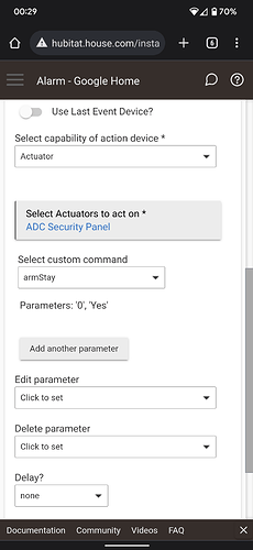

This is really nice. I can arm and disarm from the devices page but I don't see an option to arm or disarm in the rules. Did I miss a step? I want to set up a rule that when my noise-making fan is turned on the alarm is set to Night. Thanks for all this work.
You have to use "custom actions" and pass all arguments that the device page requires.
