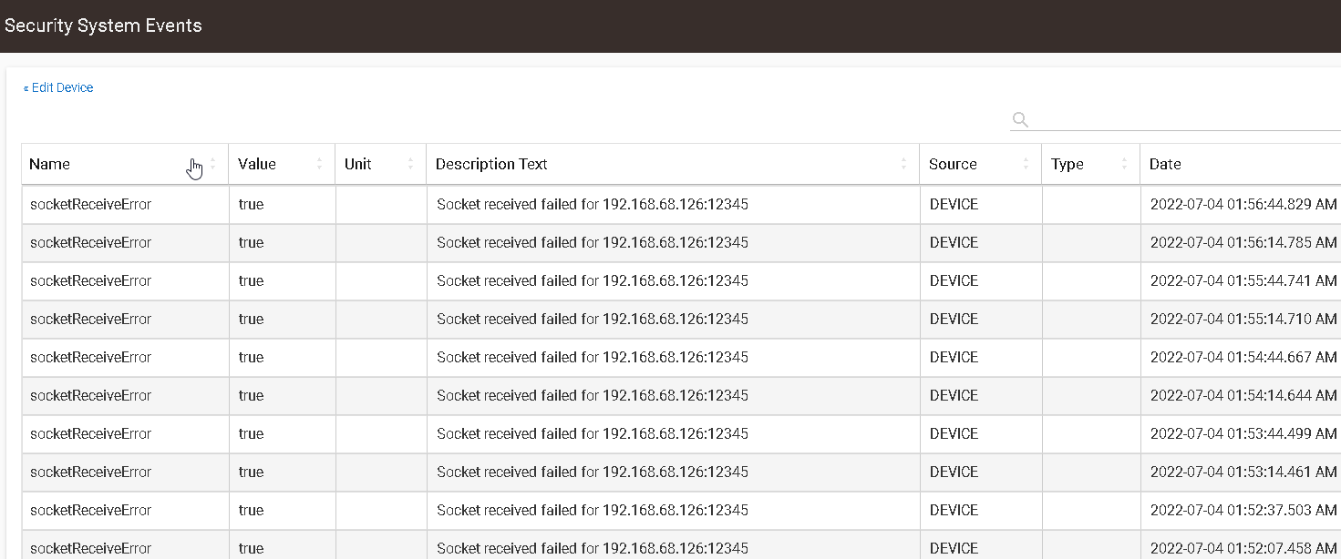

Starting July 3rd, when I check the event logs in HE device manager it shows SocketReceiveError.
It's repeated every 30 seconds, I am able to arm and disarm from HE, It is connected as far as i can tell.
I rebooted both my HE and the alarm panel. The same issue is repeated every 30 seconds.
I fully removed the Alarm Panel, uninstalled the driver installation via Package Manager, and reinstalled it. I changed the access token on the panel, verified I lost connection, regenerated the token, and verified the connection. Yet the SocketReceiveError persists.
attached are screenshots of the error and error details. Any insight would be greatly appreciated.

How many devices do you have connected to your alarm panel (not including any z-wave devices)? The alarm panel periodically transmits the status of the devices which creates a fairly steady stream of messages. If you don't have many devices connected, perhaps the socket times out. It will reconnect so there's really nothing to worry about. I'm out of town right now but I logged into my HE remotely and don't see those messages. Are you running the latest version of HE?
I'm seeing the same error under the "events" page from the device, but, I'm not seeing anything in the main logs. I'll do some poking around today to see if I can come up with anything.
EDIT: This error also just started appearing for me. Oddly, it literally just started happening about 45 minutes ago. What's weird is nothing shows in the main logs. Just these event entries. And like @user135 I'm still getting devices updates and what-not. Weird.
EDIT2: Even weirder...I'm not getting a connection failure when cURL'ing the panel directly, but I'm not getting any messages coming across either. Something appears to have changed with the panel. What's weird is that the messages are coming across to HE still. Opening a window with the curl connection open and monitoring the HE logs. I see the event in the HE logs, but nothing across the open curl connection. I did eventually get an "SSL/TLS connection timeout" error from the cURL.
I didn't think to look in the events page; I see the same timeout messages. Guess they can be ignored; my system is working fine.
The panel may only support a single connection, or it may allow multiple connections but only send info out on the first. The interface is meant for Control4 integration, it's not intended for general use and isn't documented publicly, so it's probably not as robust as it would be if it were a publicly documented API.
I currently have 6 devices connected to the panel. (All Z-Wave devices are connected to the HE hub and not the panel) so 5 total sensors + the panel Glassbreak:
I am running the latest firmware for HE. I did that upgrade while troubleshooting initially.
I know it'll support both at the same time since I used it when setting everything up. I think we might be hitting a rate limit somewhere. I all of a sudden stopped getting the device event error for about two minutes and was able to get a response to curl. Then it clamped down again, I'm seeing the socket receive error, and curl isn't getting anything back.

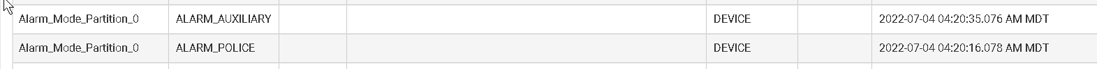

One last thing to add:
When all of this started, my panel would randomly be given the ALARM status and set the panel off. The logs indicate the command was sent to the panel from HE. THis happened in the middle of the night. When i disabled the 3rd party connection setting in the panel, The event triggers stopped. I have not re-enabled it, yet, but will do so now to test further.
Can't imagine how that could happen. Do you have any rules in HE that could trigger an alarm condition? I've been using these drivers for well over a year in two different houses with IQ2+ panels and haven't seen any issues at all. I don't have any personal experience with the IQ4 though.
Those device events aren't HE sending the command. That's just the panel reporting back that the alarm was triggered. You'd only know if the command was sent from HE if you have debugging enabled and are looking in the main hub logs.

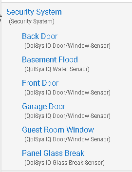

What an incredible driver!! Thanks for making this. All my IQPanel sensors are now usable inside HE which is amazing!
