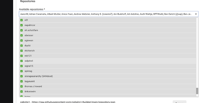

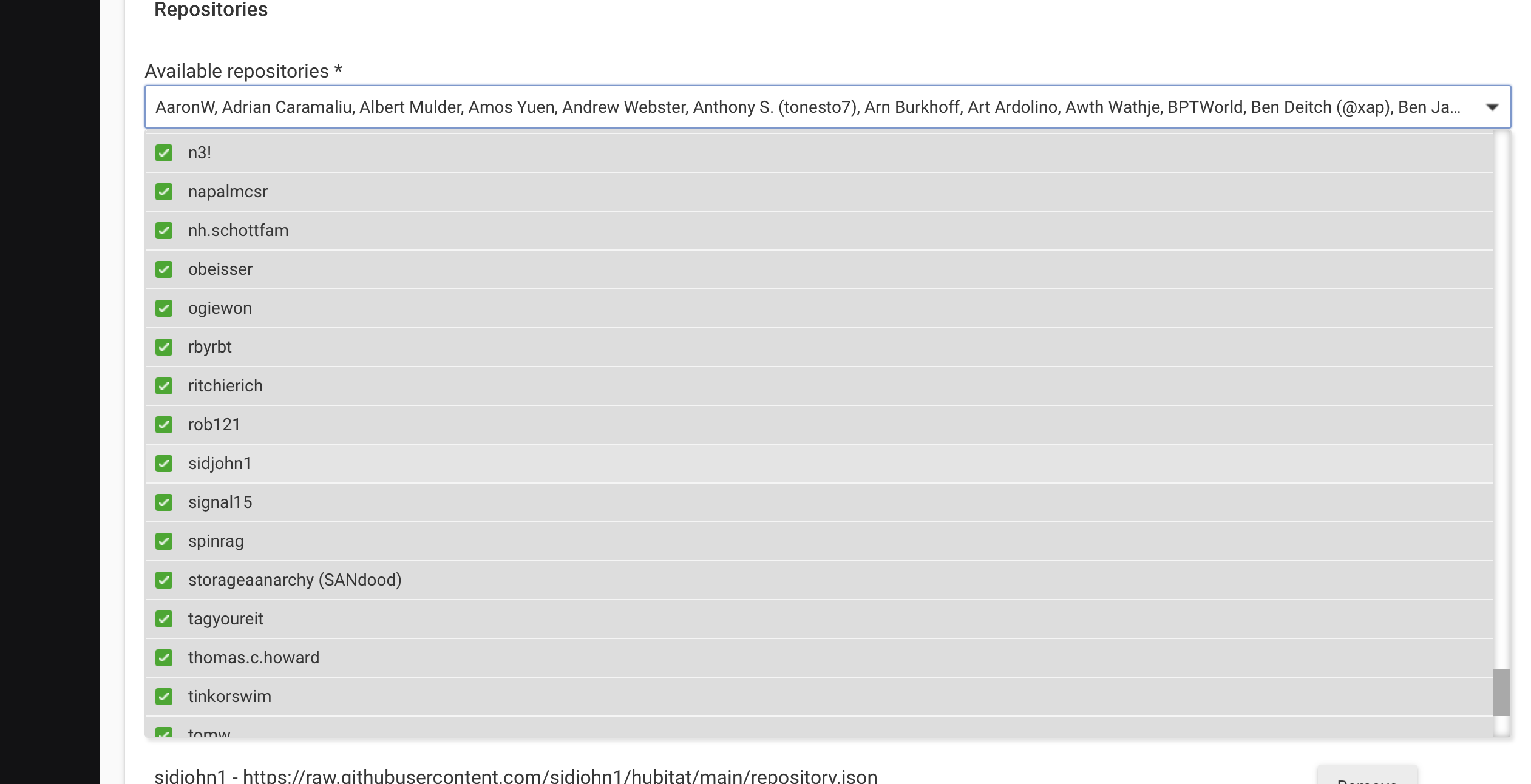

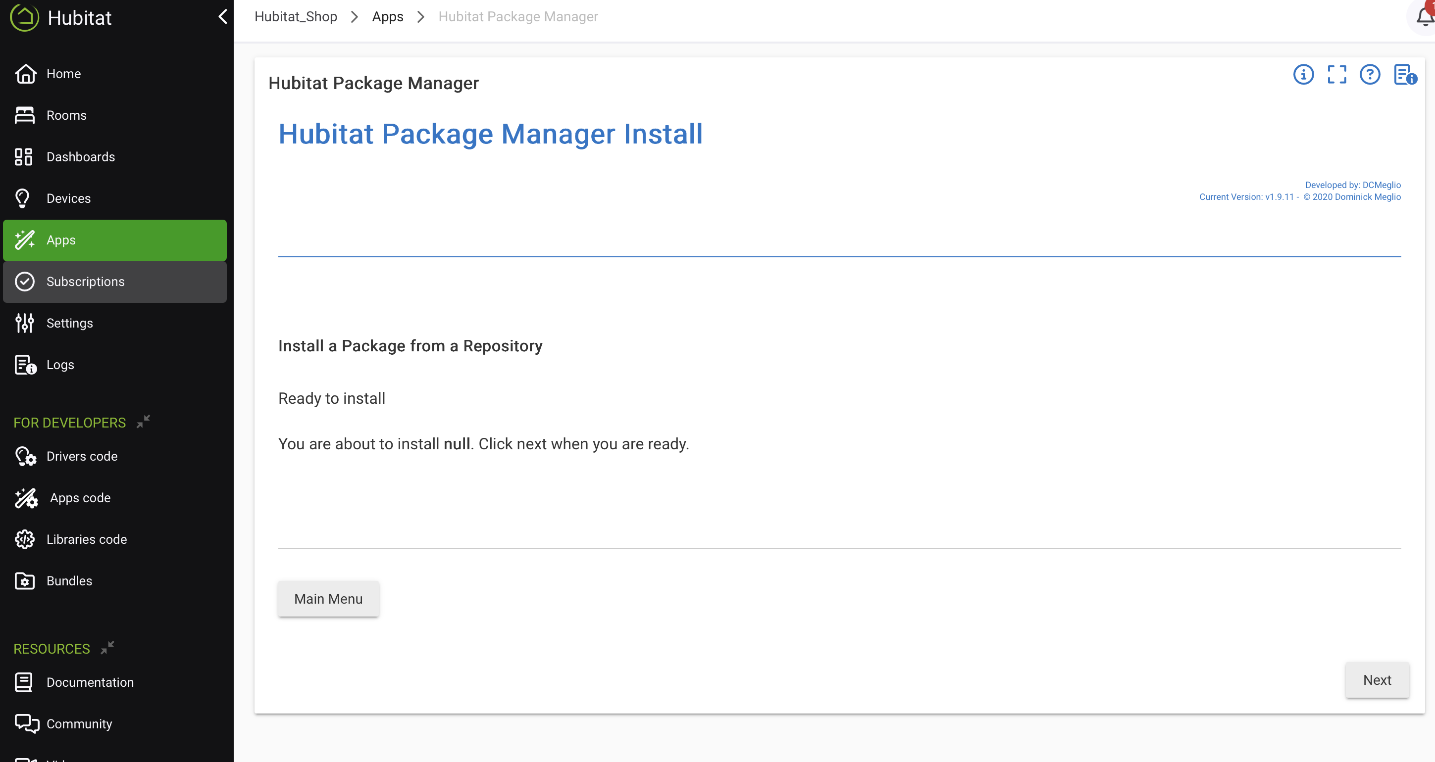

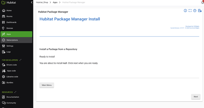

I'm attempting to install this app.
When I paste: "https://raw.githubusercontent.com/sidjohn1/hubitat/main/repository.json"
Into package manager ( Install a Package from URL), I get:
" You are about to install null . Click next when you are ready."
Once installed (?), I can't find PurpleAir in Apps...
Am I not doing the correct steps? What am I missing?
Thank you.
Thanks. I've already done that. (What do I do next?)
It’s like 1 post down from the last link i sent
Thanks.

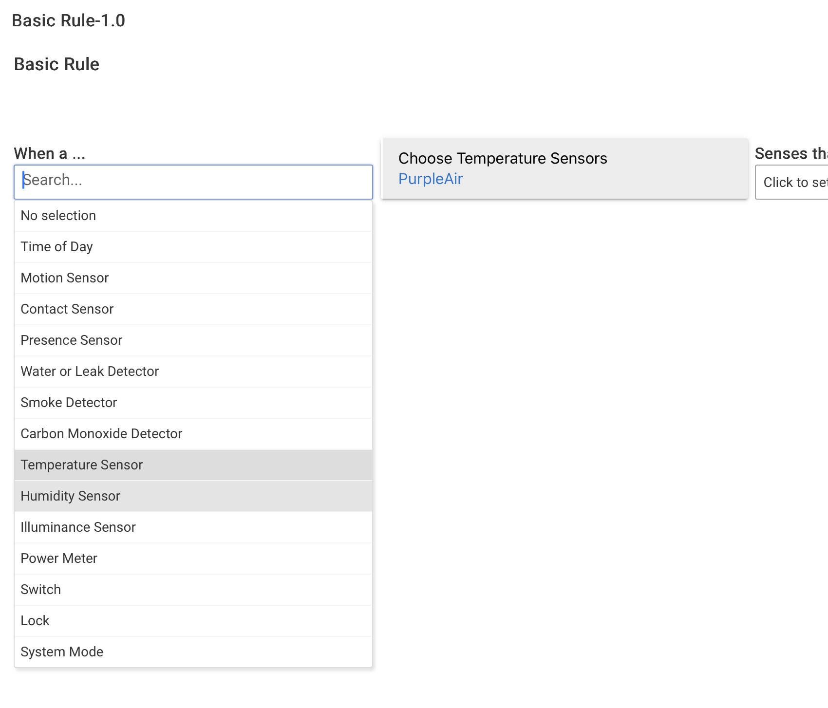

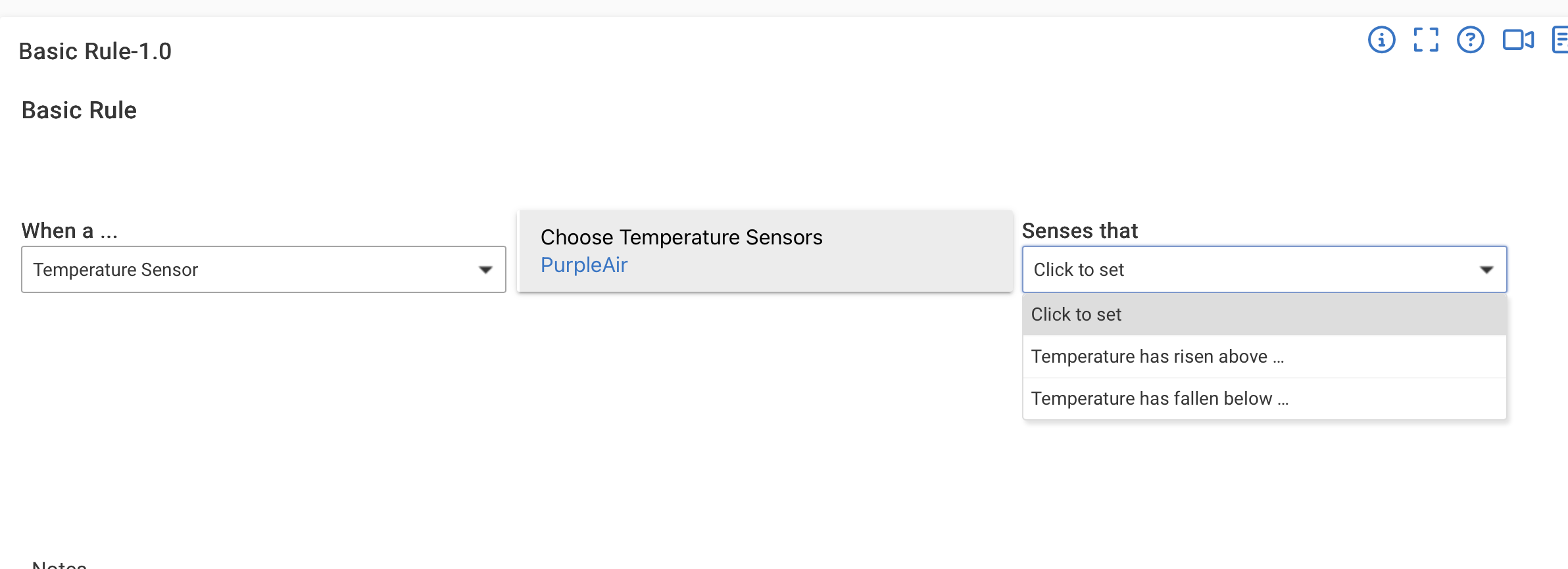

I'm using Basic Rules to pull sensor data. I see that the driver provides temperature and humidity. Any way to pull other data, such as PM 2.5 ?
Not from Basic Rules, no it’s a limitation of that application. RM has access to all the atttributes.
before you ask… No i will not help with RM.
Thanks. No, I don't need help w/ RM.
