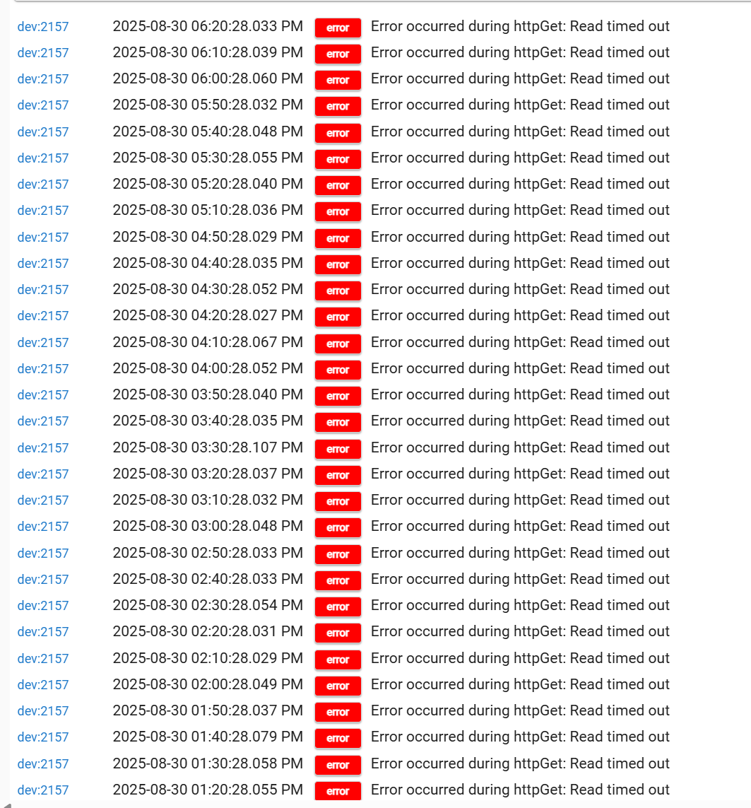

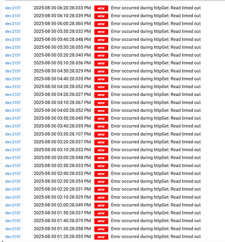

@sidjohn1, I am getting HTTP read errors periodically. Sometimes they persist for hours; sometimes they only happen once. They eventually clear up on their own and things start to work again. I am polling every 10 minutes.
Any suggests would be great appreciated, thanks!
Marc
Normally that means the destination server isn't responding or isn't responding in a timely manner. Given that the developer states that this is a local driver though it would point to either the device being unavailable or a slow wifi network.
