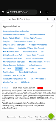

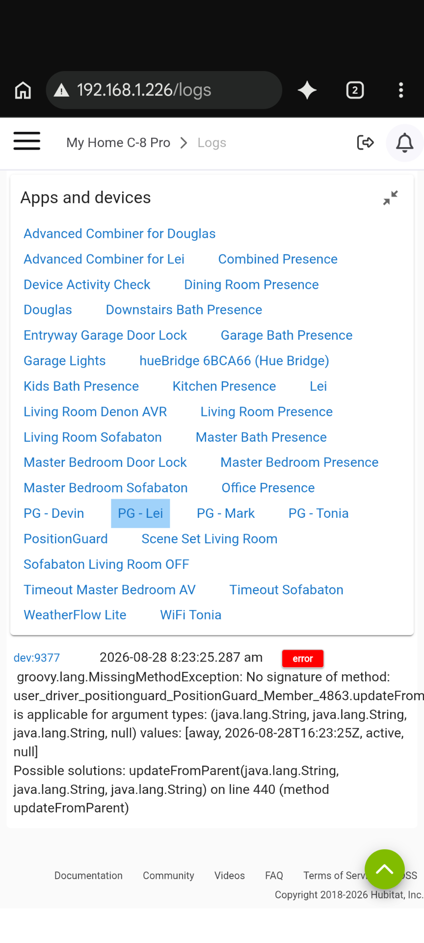

I believe I've found it: a couple of possible causes depending on what actually happened (the logs should tell us). Either way, I've built and tested a fix for the most likely one, and it's going out as a 1.3.1 release for the integration. I'll follow up here once it's live.
I did see an error about signature of method, will screenshot and add shortly
good catch @halfrican.ak, and no harm done: this looks scarier than it is.
Your hub's running the current app with an older driver. As of 1.3.0, the app sends each member's Safety Zone status as a 4th argument. If the driver on your hub predates that, the call has no matching signature, Hubitat logs it red, and the app falls back to the old 3-argument update automatically. Your presence data keeps flowing either way; the red line just repeats per state change until the driver's updated.
Quick check to confirm nothing's actually broken:
In the app, is Last successful poll advancing?
Does a member's currentArea/presence still update when they actually move?
If both check out, it's cosmetic. Fix:
HPM: Hubitat Package Manager → Repair → PositionGuard (re-fetches app + driver together)
Manual install: Drivers Code → PositionGuard Member → Import → Save (URL's pre-filled)
Either will fix the error and turns on the two new Safety Zone attributes as a bonus.
If either check doesn't work, post here and I'll dig further. That would be a different problem than this one.
