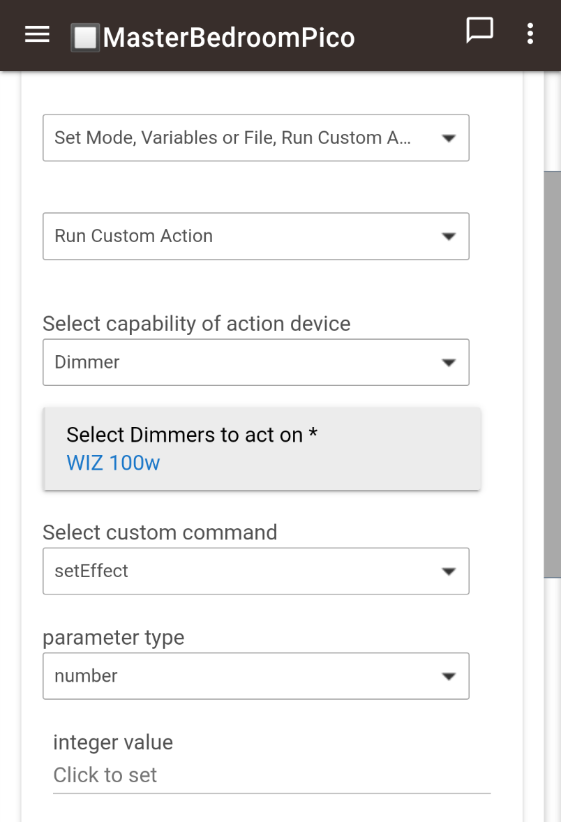

however, i'm struggeling to manage to create a wake up routine - the effect nr is 9 but how to I trigger the bulps to that effect via rule machine? any ideas?
@ottomarwin, there's probably some arcane way to get rule machine to give a "Set Effect" command, but I've yet to figure it out. In this case though, you can cheat a little by using the mechanism I built into the driver to let the scenes app control effects. Just have rule machine set the color temperature to 6000 plus the number of the effect you want to run -- in this case that'd be 6009.
I'm new to Wiz devices, but I have used Rules Machine to handle non-standard things on my Lifx Z-Strip and it may be applicable. I think you can probably sub "setEffect" for "zonesLoad". Here's a link. Lifx Custom Solution.

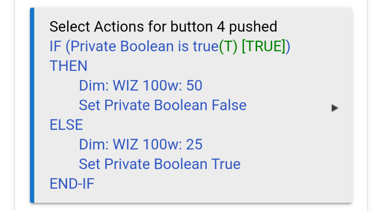

I'm having problems getting start dimming/ stop dimming to work in rule machine, I'm doing it the same way with hue bulbs. I'm running v1.2.6 of the wiz driver. I have been trying everything I can think of. And I also can't seem to get set ip to work either... But everything else works perfectly.
EDIT: As noted below by the author set dimming isn't available for WiZ lights. I deleted the screenshot so no one tries to copy me by mistake.
Yeah, that's the issue: the "Start raising/lowering..." actions in Rule Machine run the startLevelChange() command on the device, which is not implemented in this driver (you should see an error in "Logs" hinting at this) and may also not be possible with what's been reverse-engineered of the bulbs' API.
The Wiz bulbs don't support the startLevelChange() command via either the local or cloud API as far as I've been able to discover, and I'm not willing to try to build it into the driver -- it would involve sending several commands per second to each bulb, which would bring the hub to a standstill if you had more than a couple of bulbs.

To get rule machine to setEffect (or speed, pulse, saturation, etc) you want to "run a custom action" , it's grouped with set mode and set variable. The other method the author designed is to set temperature to 6001 for effect 1, 6002 for #2, etc. Since the bulbs don't actually go above 6000k
