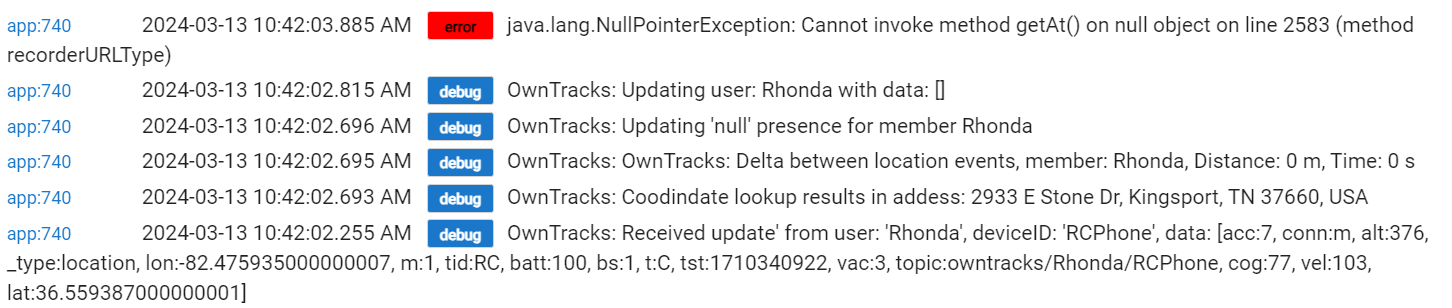

@lpakula I am having errors with null data coming from Owntracks. Any idea what I need to do to fix this?
I have Recorder set up and am not seeing these errors - and given this part (
image) it seems related to Recorder. Are you using Recorder?
No, not using recorder. How do I turn this off? I have no URL and Enable Location Updates is turned off.
Above my paygrade...likely need @lpakula to chime in on this one.
I assume you've never had Recorder enabled and haven't enabled any of the settings in the Recorder section of the OwnTracks HE app?
If you force close/open the app again, or restart your phone, that will "cure" it. They did a bunch of improvements around this in the upcoming version -- I had asked if they'd add in the changes for this portion, but they asked to wait to confirm it's still broken on the next version.
Let me check into this. Might be missing a check that's giving you that error. That shouldn't be happening....

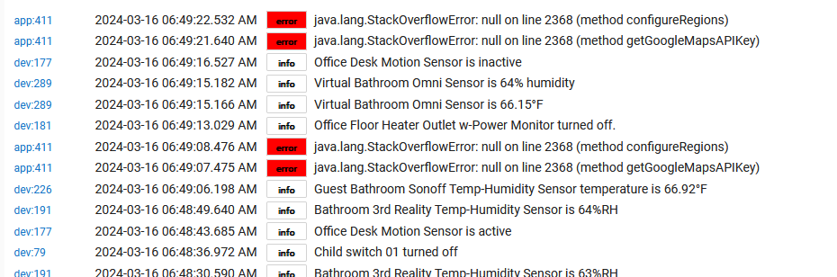

ran into a problem this morning after update. I'm set to NOT use google API, I can't get to the screen so can't see what my geo service type is, but I'm 100% sure I'm not google api.
I get an 'unexpected error' crash when I try to go into the app.
I'm seeing this after the latest update.
