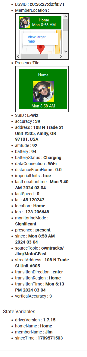

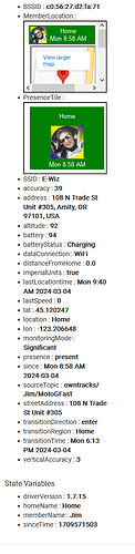

Hey Gary - here's my device - should be similar - does this help?

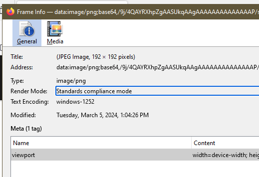

If I opened the first graphic - It shows what seems to be an iframe
the second image also seems to be an iFrame. I didn't waste a copy paste here. Is that what you wanted to peek at?
Looks like everything is in the individual attributes, I'd just have to assemble the component pieces. Could maybe even do that with Tile Builder Grid like:

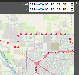

  • Recorder 'Past Locations' tile now has start/end date selection boxes (adds that nice feature Owntracks Frontend has). By default, the start date/time is 12-hours before the current time. This default is configurable in each member's device from 0.1 to 31.0 days. You can select further back in time with the selectors, it just is slower to load the further back in time you select.
Ability to see lines vs breadcrumbs will be in the next version (not saying I 100% forgot about it until now @jonathan.lorber :rofl: )

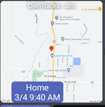

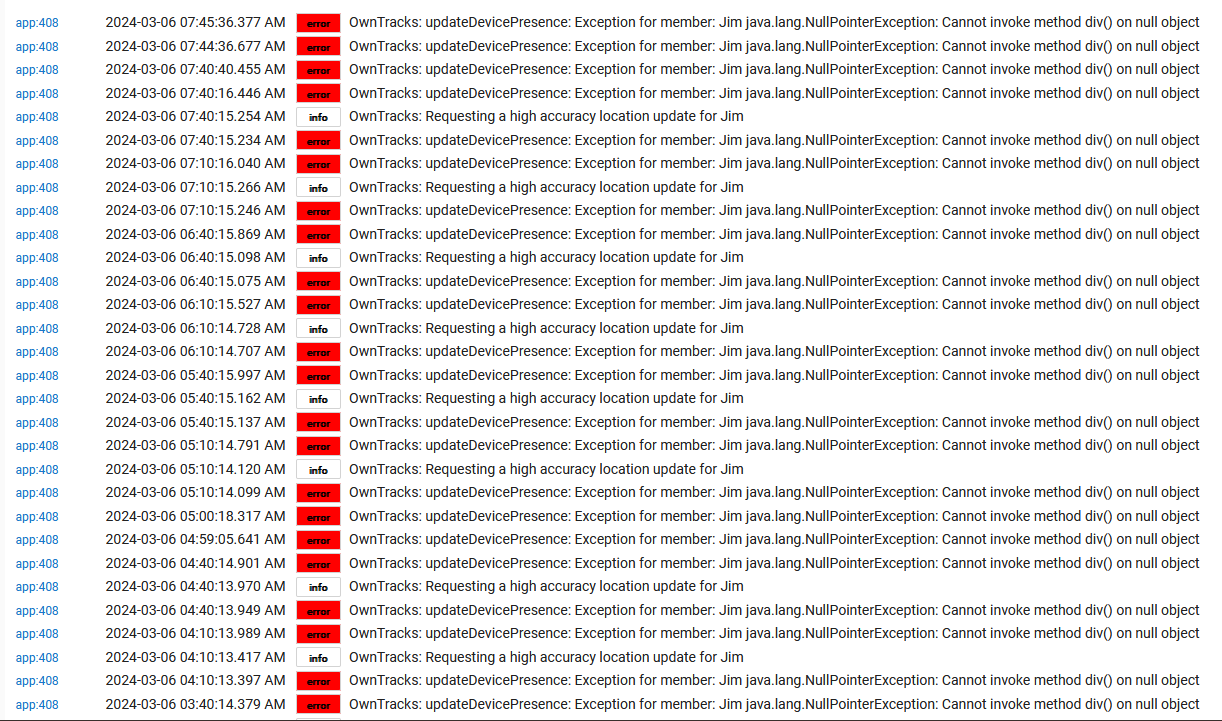

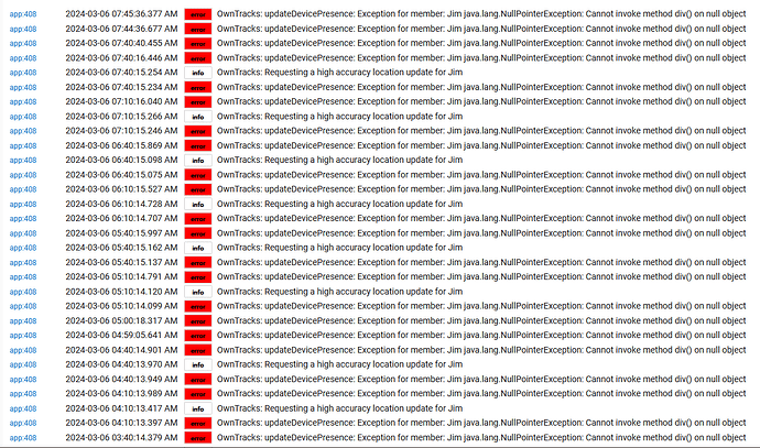

Sorry to bother - Not sure how to clear or fix this - it seems to be a tile painting problem.
A few days ago (2? 3?) My owntracks tile on HD+ Stopped displaying my photo/icon. I didn't think much of it - but I did try uploading a fresh copy to file manager.

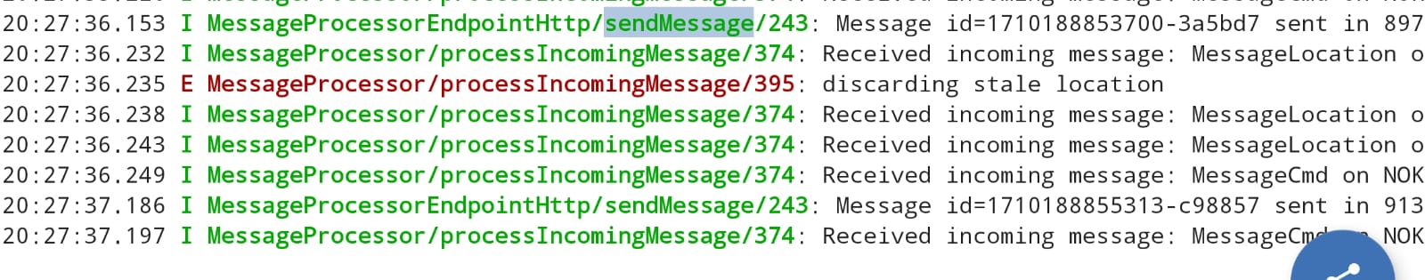

However more important is that the tile is not showing the date / time of event correctly. My error logs which were clean 4 days ago now have these messages:
I'm guessing the '(Div)' error is in the HTML of the tile? I don't believe anything has changed with 2 minor exceptions - I updated the long/lat to be a tad more accurate, and a driver/app update I applied for Hubitat Owntracks Presence.
Here's an image of the Tile - note the date shows 3/4 (today is 3/6)
Suggestions on repairing?
Go back and reset your 'home' location in OwnTracks. Should fix that issue.

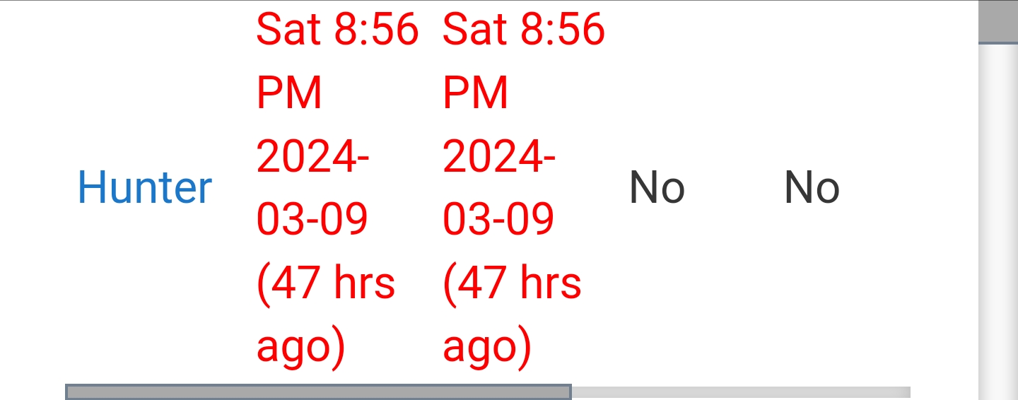

I have been noticing slow behavior with all of our four owntracks users. Usually about 10min lag before nothing happens.
Also noticed that one of the users is correctly changing location attribute but transition direction and transition region is stuck to home.

Hmm.. that is something on the phone side. If it it didn't get the region transition, then HE app won't show that.
Are you in an area with low wifi presence, or fringe cell coverage?

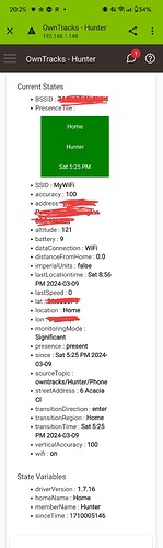

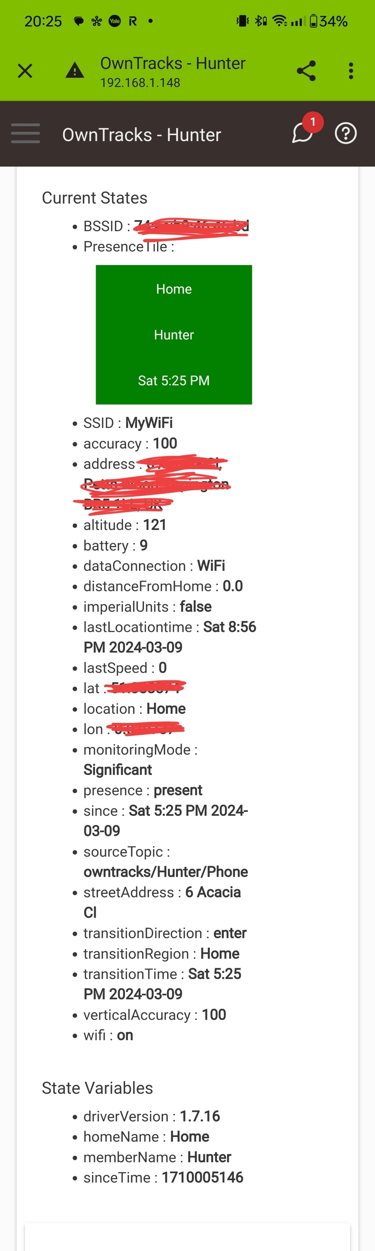

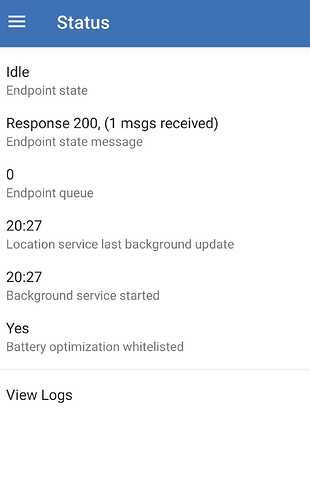

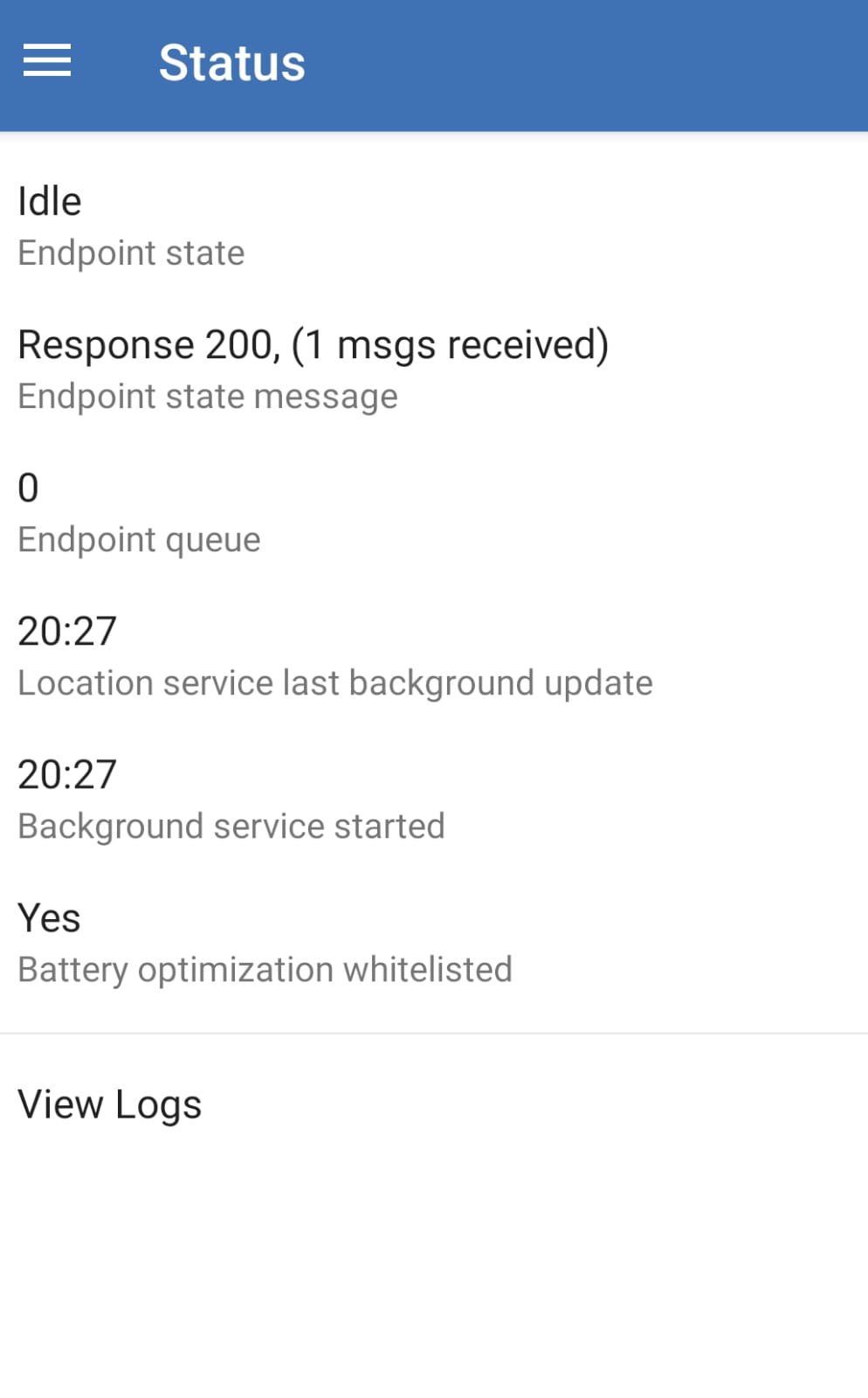

I'm having some trouble with some of my users going offline. Not sure if it's all due to the same reason but here are some screenshots for one of them. Any suggestions?
