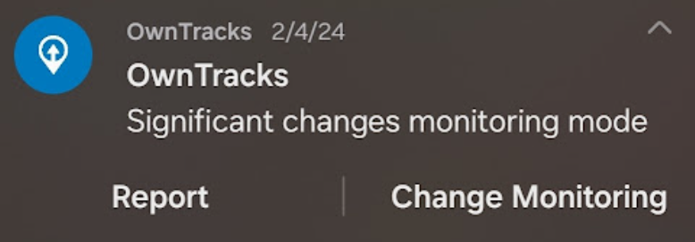

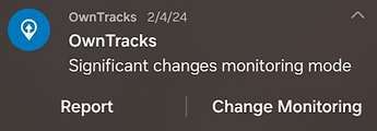

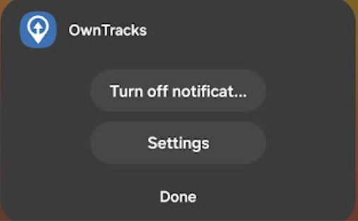

If you mean persistent notification appearing in the Notification drop-down, I believe yes, one does appear, since the app is running in the background. There is an option to disable the notification but I'm not sure if/how that affects the app runing in the background.
2024-02-06 11_58_55-Main
I'm seeing the same thing. Looks like it's primarily happening on Samsung phones from what I've been able to determine. Maybe get if the HE app can also provide a "Local" connection, then I can create a proxy to allow the connection from the phones to come in, and also, potentially use the proxy to shorten the URL on the phones to something like tracker.example.com and forward to the full local address.
Just a data point, not happening for me, unlocked S21 on Android 14, Verizon is my carrier. Using @lpakula modified version.
I'm seeing it on an A51 and S23. So yeah, my not be all of them.
Just thinkining.. Maybe if you can make use of the port 39501 option so it doesn't rely on the APP ID. Something like http://127.0.0.1:39501/tracker
Of course this would only be for those of us that would set up a proxy.
Exactly, I saw that, but wondering how much of a difference it makes.
Life360 didn't have a persistent notification and worked just fine
One way to find out may be just to test it by turning off the notification.

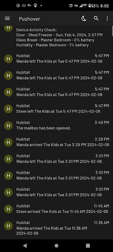

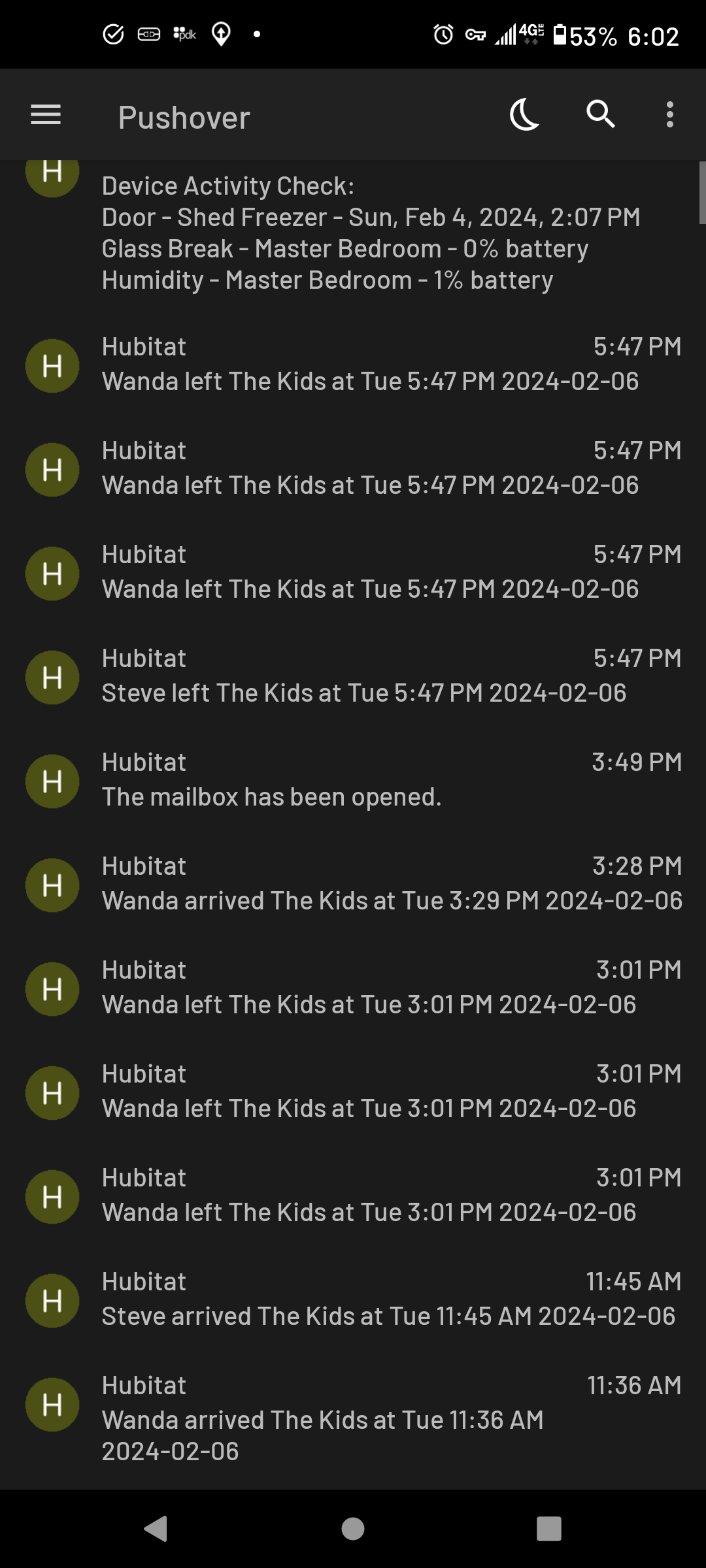

Anyone else seeing multiple notifications when someone leaves a region? On my brides iphone, I'm often getting 2 and 3 notifications. There are not multiple regions on the iPhone so that isn't the cause. I'm seeing this on all regions on the iPhone.
I'm going to turn on logging and see what I can gather tomorrow but wanted to see if I'm the only one seeing this behavior.
