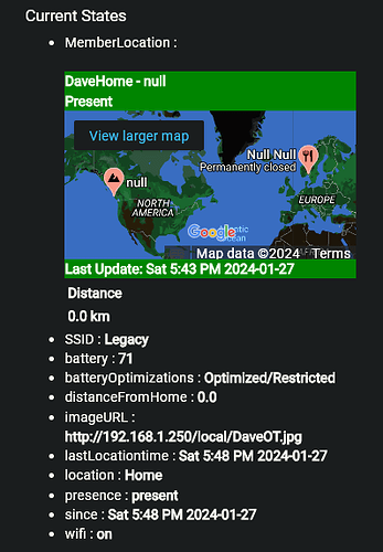

Don't know if this is related to my issue above but I'm stuck in Norway now and, even though my attributes are updating, I now have a battery optimized/restriced message and my app is not.
EDIT: flicking al the movement and waypoint widgets I managed to get home but the battery optimization attribute refuses to budge so far.
The iPhone and Android Play Store versions don't report an address, that's why there is no street address. I'm just wrapping up allowing you to link the HE app to a geocode service to backfill those missing addresses.
The null/null/Norway will be fixed in the next version. It's the poor accuracy locations that seems to be messing with the tile.
As for the battery optimizations, when you look at the OT app on your phone, and look at "App battery usage", it's set to "Unrestricted". If it is, and you are on that screen, click the "force stop" and then "open" buttons to reset the app.
Yes I have tried that. Cleared the cache too.
App starts again, refreshed my HE device and stays * batteryOptimizations : Optimized/Restricted

Reinstalled and my wife and I both have the "split" and battery error permanently now. Never had any of this before. hers is a a bit different than my attery complaint.
dev:21382024-01-27 22:24:02.558errorjava.lang.NullPointerException: Cannot invoke method split() on null object on line 480 (method generatePresenceEvent)
Me, Pixel 7 Android 14 * batteryOptimizations : Optimized/Restricted
Wife, Pixel 5 Android 13 * hiberateAllowed : App can pause
