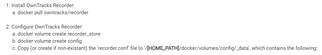

I set up Recorder from the command line following @lpakula's instructions in the app, it's running in a Docker container w/default settings from that setup, did not use Compose.
