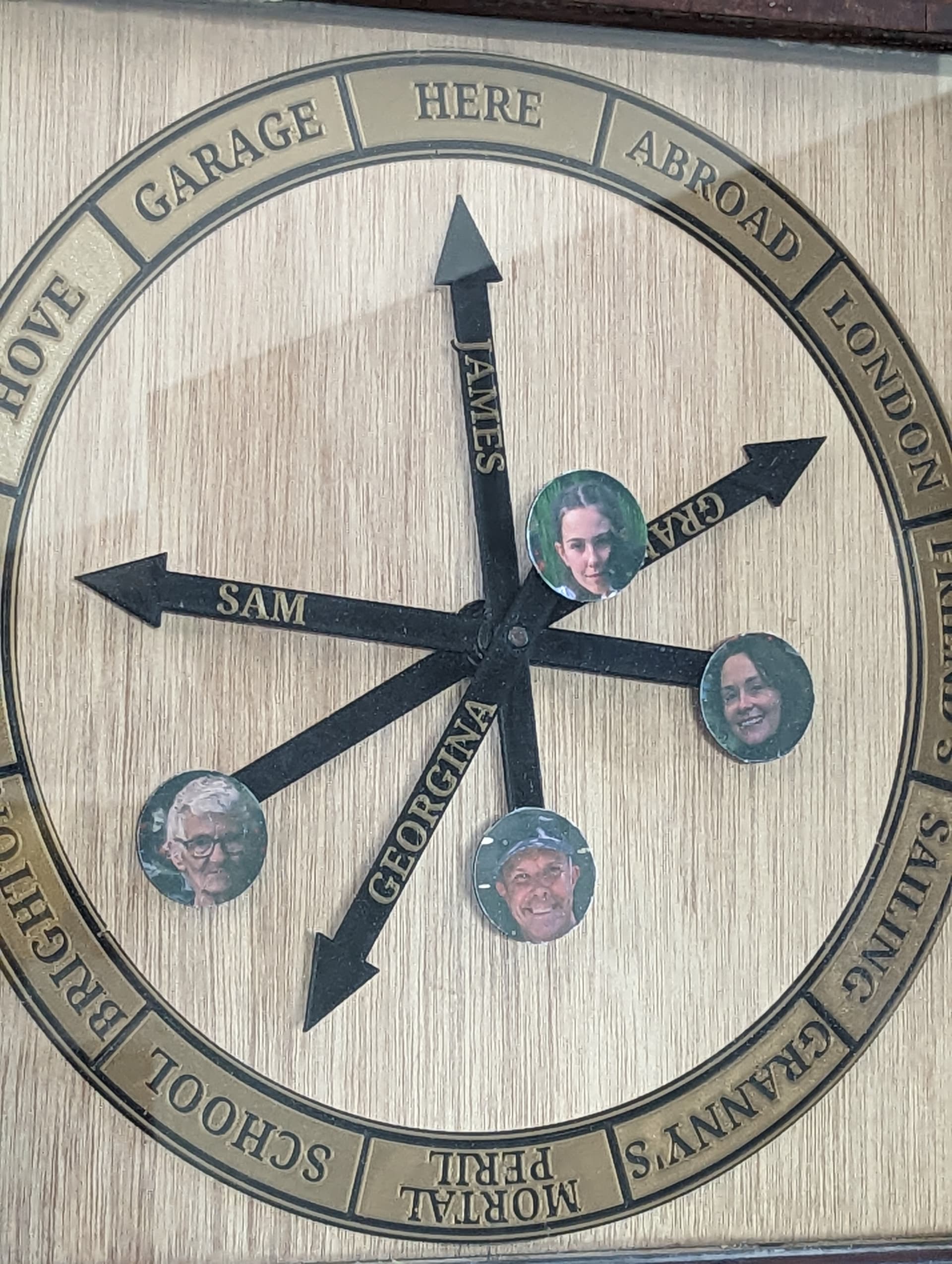

Hi all - I've been using Owntracks & Brian's version of this to power my "clock that tells place rather than time":
And it's working pretty well, though not perfectly - it's driven by a bunch of locations (replicated for each person) and then some webcore code to control the servos
This new fork looks AMAZING, and I think it makes sense for me to migrate to it, as it should give me central admin, and reduced complexity.
Can anyone see any obvious "gotchas"? Owntracks is running on a mixture of versions of Android and iOS.
The only quirk I can see is that there's a "friend" category, which means different things for different people, but I can deal with that in the webcore piston....

That's AWESOME! No real gotchas, it will work in a mixed mobile environment. A "friend" apparently is someone you'd share your hub link with. ![]()
Exactly...I've offered to move in w/his family if it means I can use the clock. ![]()
