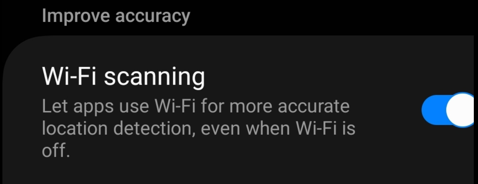

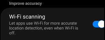

I do wonder if turning off Wi-Fi (either manually or via the automatic setting to turn it off when not near places where you typically use Wi-Fi.) is not so problemmatic on Android phones that have this setting which appears to allow for scanning for nearby Wi-Fi channels while Wi-Fi connections are off...not sure if this is on all recent phones, or just Samsung. Part of Location settings:

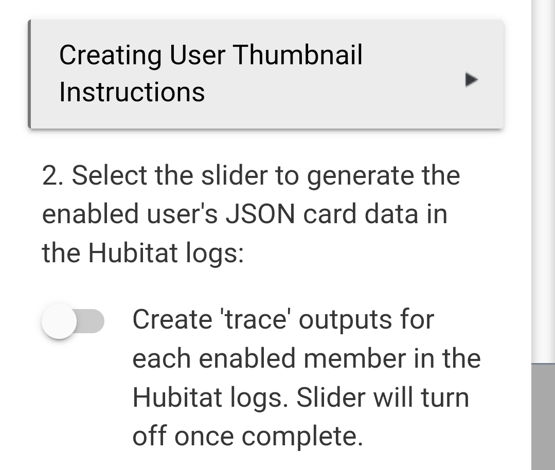

It looks like the Recorder enablement step where you create the user JSON isn't working.
When I select the slider it almost immediately returns and there are no entries in the log.
No rush, but wanted to note this.
