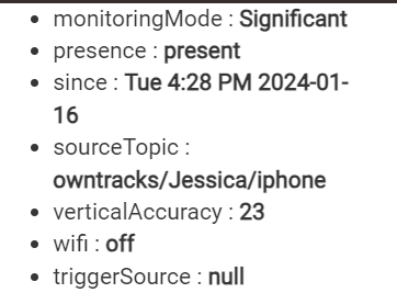

so the 'null' is coming from an iphone 15 running iOS 17x whatever... like i said im not an apple guy.
So, since the device ID is 3 characters and I have /name/iphone then why would it not show up as 'one'. On my android it shows the name 'Jessica' on map and in friends list page.
EDIT: ok i misread by initials i assumed 3 characters but you clearly indicated the last 2 (ne).
Trigger a publish location from the phone by clicking the up-arrow button in the top of the mobile app
If you had enabled "remote configuration" in the app (the one on post #2 does this by default) it would have pulled this change in when you sent the location.

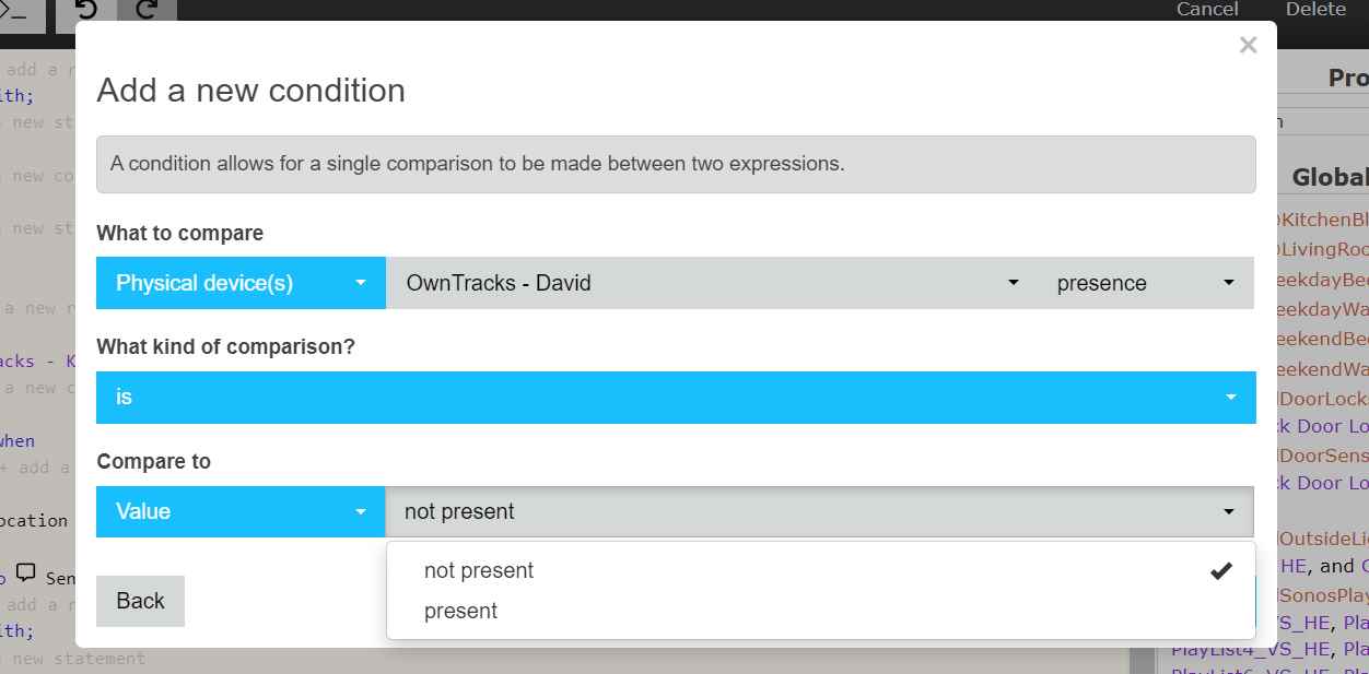

I wanted to share my perspective on the current states. For "Presence," I can easily choose between "Present" or "Not Present," as shown in the picture below:

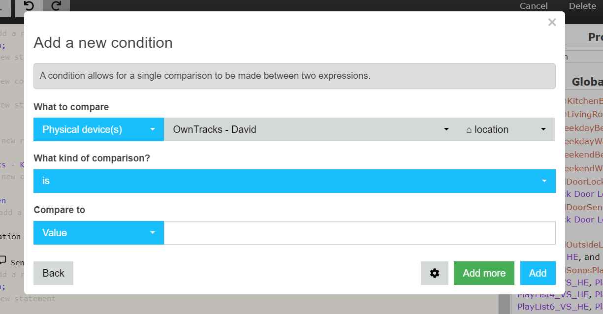

Actually, checking the code, as is it would work for you. The location field will display the region you are in right now, if you are outside that region, then it's the "distance from home".
If you are looking for a region map in webcore, that should work. Let me know if it does not and I can change something in the driver to support that better.

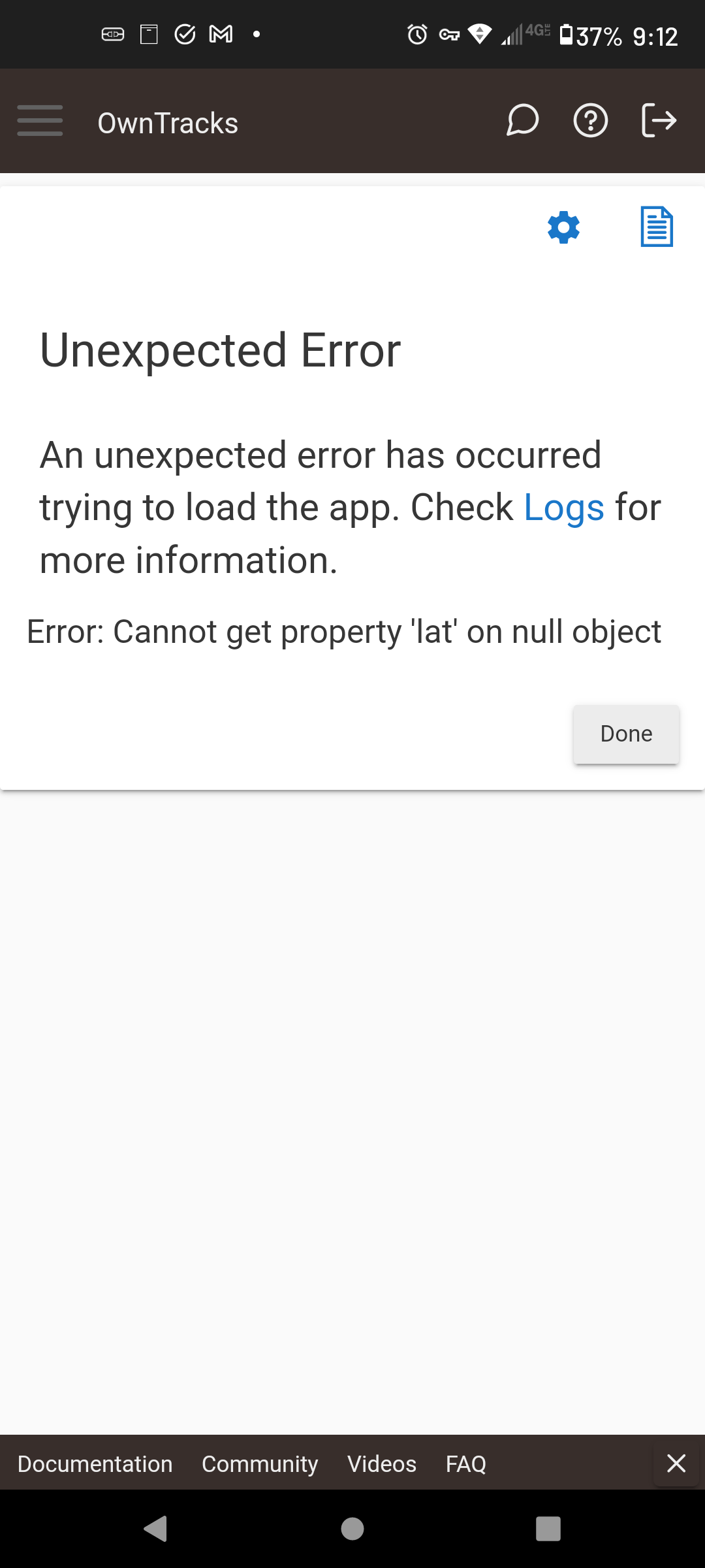

Anyone see this error before and know how to fix it? If not, I'll have to delete the HE app and reinstall. Every time I try to get into regions I get the following error.
I'm not sure. I started this a couple of days ago and came back to it today. When I returned to setting it up it appeared that I hadn't managed to save anything so I started over. I'm wondering if I managed to corrupt the Hubitat install. I can't open configure regions at all. It goes to the unexpected error message.
This seems normal to me for Webcore. This is how I was setup in Life360 as well.

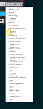

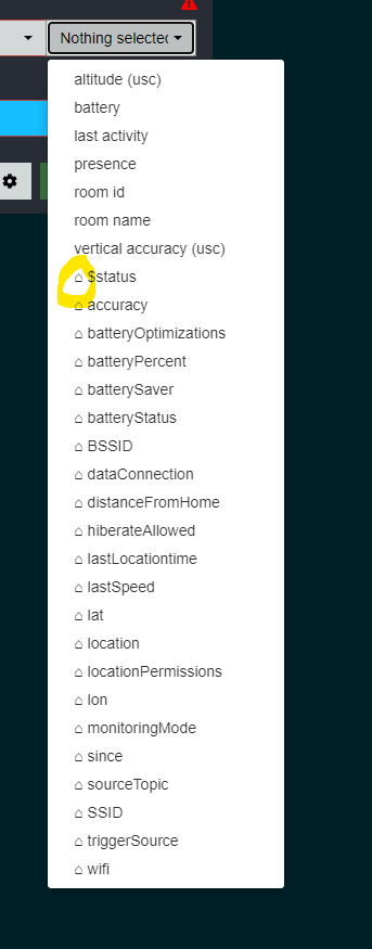

Please excuse the terminology, I'm not sure what everything is called. Presence is a Hubitat standard attribute. When looking in Webcore, any selection with the little house icon in front of it is custom, and Hubitat doesn't have built in support for it. The attribute is added to the driver, and can be used, but isn't a standard attribute. Some standard attributes would include presence, battery, switch, level, etc... Everything here with the little house icon is extra variables provided by the driver.
I believe all of the standard attributes in Hubitat have preset values which can only be selected. Presence is present/not present, level and battery are 0-100, switch is on/off, etc... Though with location, how would Webcore know what your regions are? And they are going to vary from user to user, so I don't think it would be possible to predefine a dropdown.
This is how it is setup using Life360+. Their variable was called address1, but I just did a simple if address1 is (Home, Region2, Region3, etc) then do stuff. If not in a region, address1 would display the closest address, rather than distance from home, but regardless if you are just looking for a region it shouldn't matter
