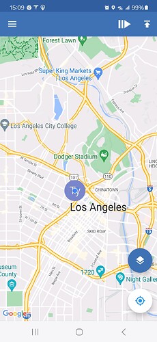

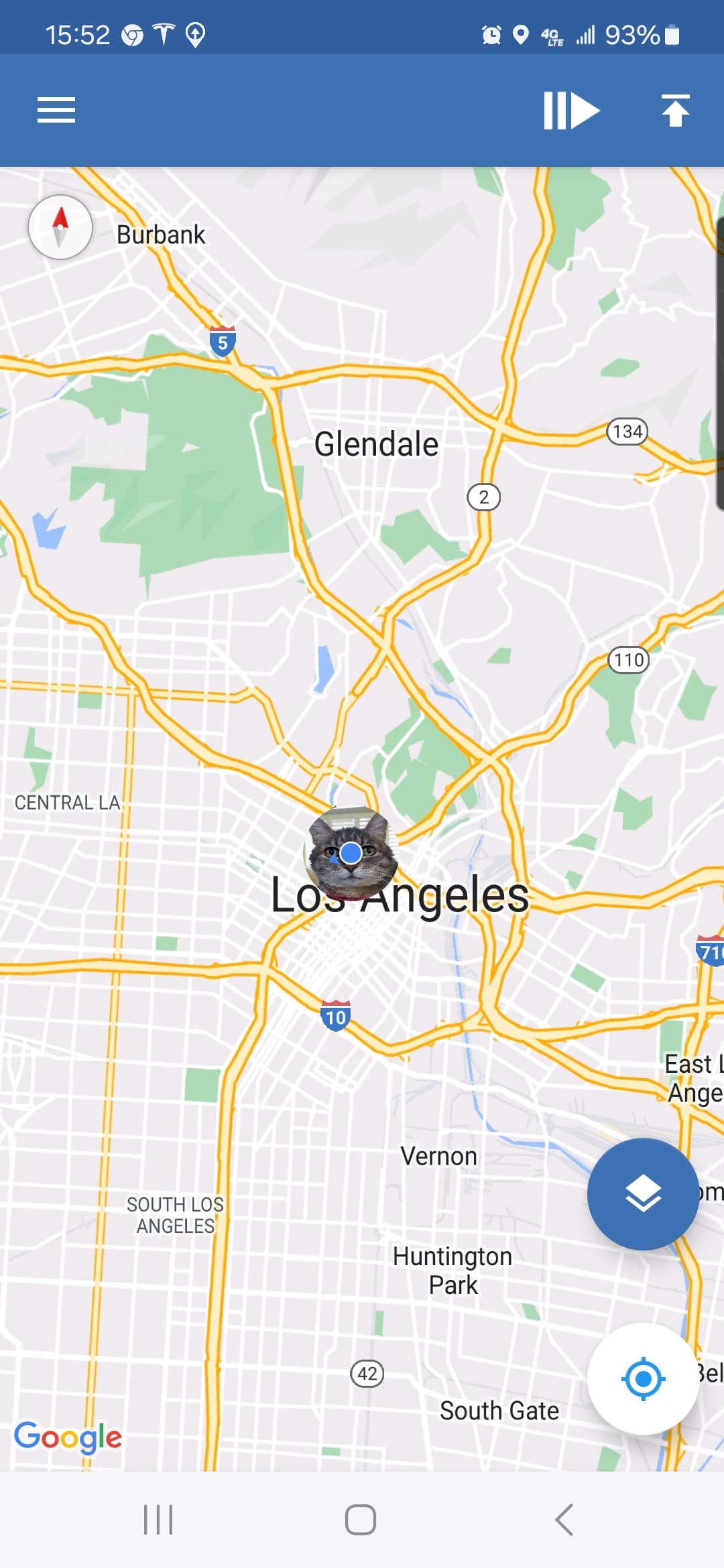

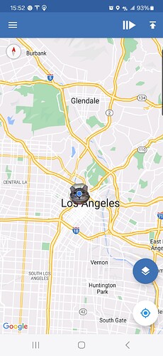

Pretty cool
Before
After

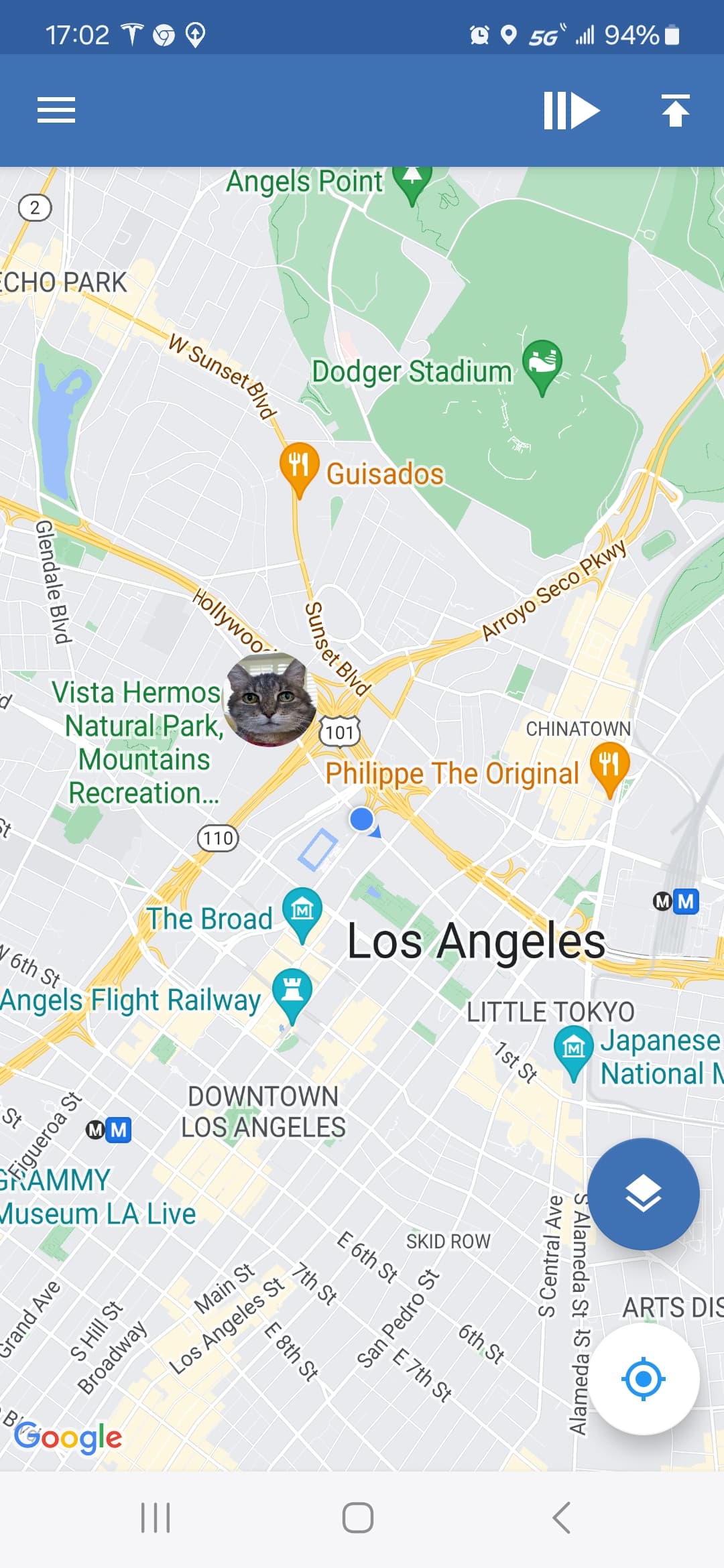

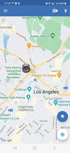

I am out and about but my thumbnail is not moving with the pointer
Is it supposed to be that way?
Glad you asked I had the same question!
