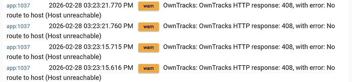

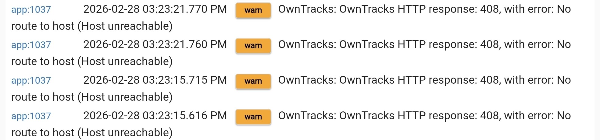

Been getting these all day regardless of whether I'm home or away, Lyle. No changes to any of my settings. Our arrival home after being on all day was correctly tracked/reported.

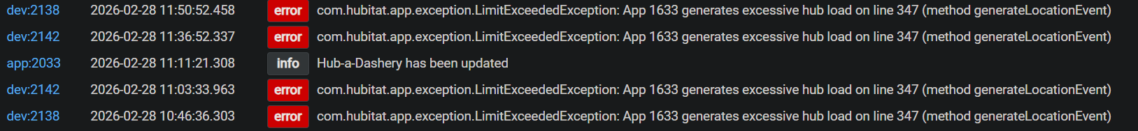

Do you have it sending data to the recorder or secondary hub? That is usually it not responding.
What do you set your device "to many thresholds" to? It's on the device info tab:
Yes, Recorder is set up. Thanks, I'll go look at that...
OK, looks like some idiot (and I think we all know who!) shut down the Pi running Recorder when he was troubleshooting an unrelated issue, and forgot to start the Pi up again.

My logs are set to 500, too little? Changed to 1K.
Normally I don't get any load message at that setting.
That would do it. Nice easy fix though! ![]()

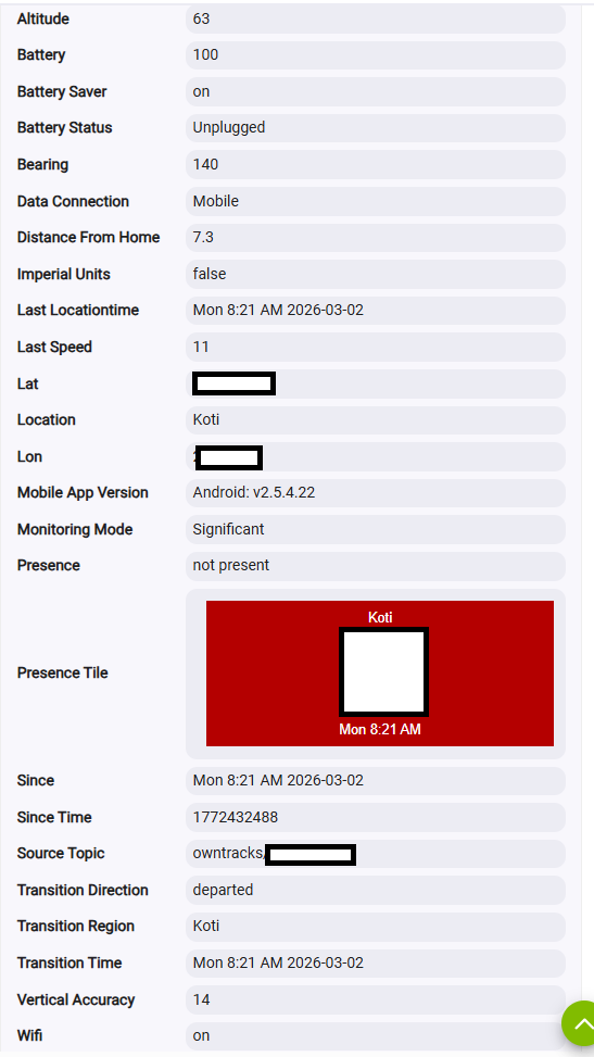

How do you get to this intermediate state?
The person has left home, the LAT and LON data point to a region that is not home. The icon is red, the distance from home is significant, the status is "departed", the presence is "not present", and yet the Location is "Koti" which means home in Finnish.
Is that running the latest version? Anything in the logs around that time?
Latest version yes. Nothing unusual in log ;(
