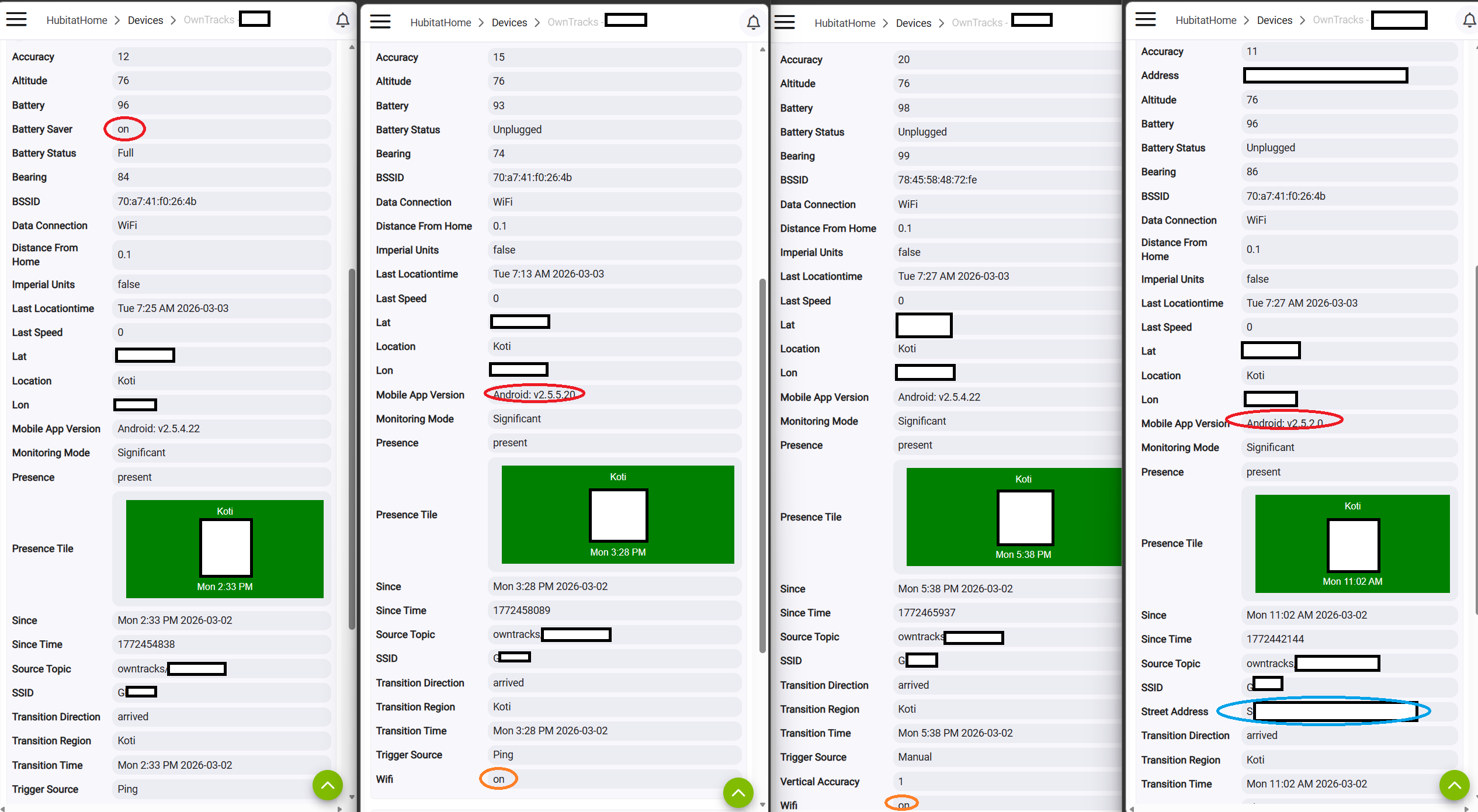

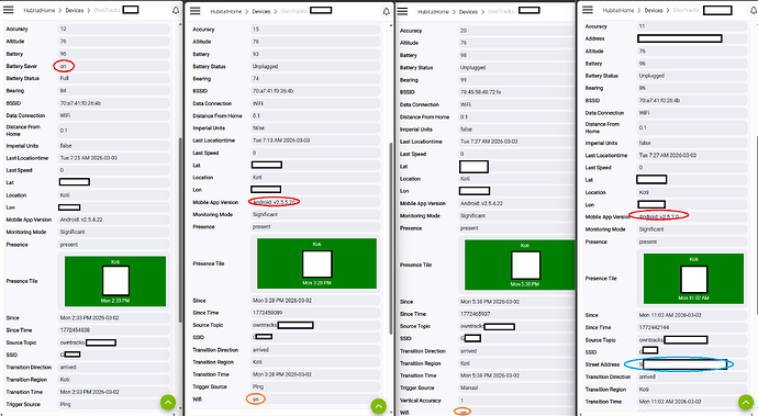

Well there seems to be an some kind of issue or issues.
We got 4 members and at the moment when everyone is at home it looks like this.
Coloured those thing that differ from other.
  • one has battery saver on (that is ok, no need to worry. I can fix that :slight_smile: )
  • everyone's at home but only one has address data (blue circle)
  • different android app versions.. (I'll fix that)
    - only two has wifi information..SSID is correct though.
  • EDIT: everyone has wifi information. It just didn't fit to the screenshot I took!
Not sure if anything explains the behavior from yesterday. Probably not.
Also noticed that when using vpn client on android phone owntracks can't figure out home SSID eventhough I'm connected.
EDIT2: There is no transition region for the device which is on battery saver mode. That would explain why it reports leaving from home but not much after that right? I have noticed that battery saver minimize polling to the server but it still somehow updates information time to time. Do we know the limits of use when using battery saver on android client?
