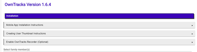

I just pushed 1.6.4 that adds a walkthrough in the app for creating image thumbnails to be pushed to the mobile phones
as well as how to install/configure Recorder, and add in the image cards.
Let me know if you need any clarification!

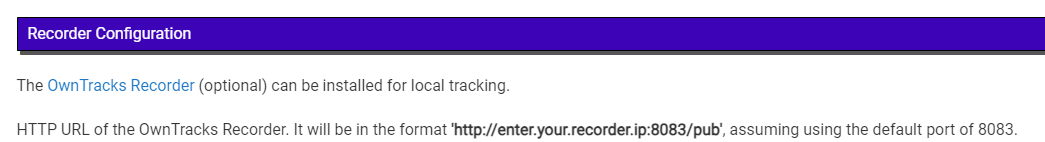

See the link above. It has a full walk through on setting up recorder on Docker.
Super easy to do. As a quick test, can you:
  • Install this app on hub #1
  • Set the mobile phone to connect to the URL from the setup in the app
  • Install this app on hub #2

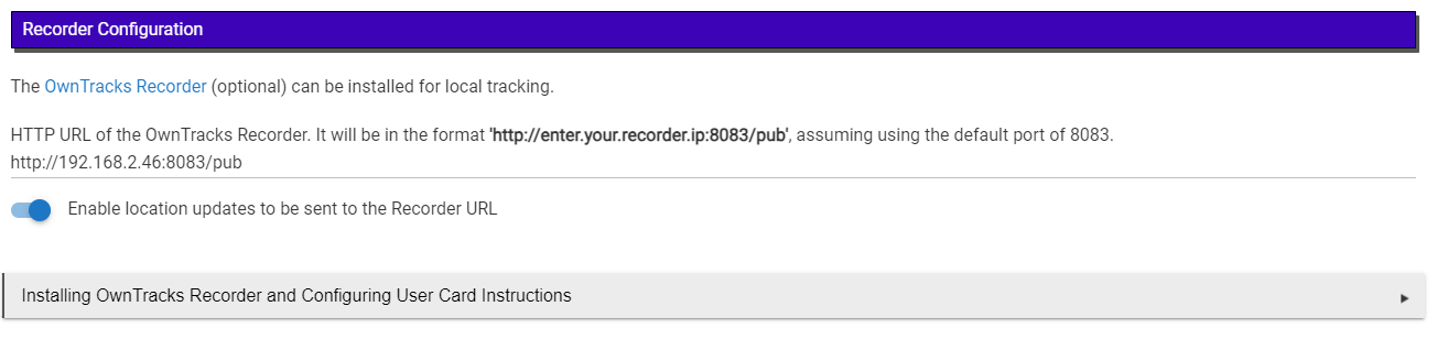

  • Copy the URL from the setup of this app, and paste it into the "Recorder Configuration" URL of hub #1
As it stands the app is just echo'ing what the phone sent to the hub off to the recorder application. If that works fine for you, I can add a secondary hub field to make that happen in a more "clean" way.

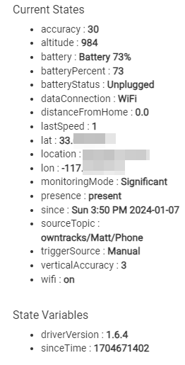

  2. Since side loading your APK, the SSID is no longer being displayed in the current states within the child device. I don't know if this is not being reported by your app or something else. I would assume that without the SSID, the resiliency could be a little less as it is not knowing which wifi you are connected to. Would this be correct?

Can you check in the mobile app that "remote configuration" is set, and in the Hubitat app, "Mobile App Configuration" section:
  • Select that phone from the "Select family member(s) to update location, display and region settings on the next location update."
  • Select "Display" and ensure "Include extended data in location reports" is checked.
  • Click "Done" at the bottom of the main page to leave the app.
  • Trigger a manual location update from the mobile map screen, top left
That should force the correct settings so that the phone returns the additional information.

Yeah... That's what I was trying to say. And yes, remote config is enabled. I followed all the bullet points and the states didn't change. The SSID does show up for my iOS family members, but not the Android ones.
Hmm.. that's weird. Can you open that device and just refresh the screen? If you are on that screen and trigger a manual update, anything?
I just checked it, and it's working on my side. :man_shrugging:
Same, no issues w/SSID from my Galaxy S21.
Yep. Done a refresh and hard refresh. But I think I just figured out what the issue is. I have an On Device VPN on my phone. Basically mobile security making sure my browser/apps don't go anywhere malicious. It also blocks web ads, etc. I disable this and did a manual update and the SSID appeared.
Interesting that the VPN is masking the wifi connection, even though it is connected. I would think that would be within the app.
We were posting at the same time. Do you have a VPN connections that is always on? I/E Google's VPN?
That's the issue-- I had a VPN on... with it off, it DOES display the BSSID and SSID correctly.
