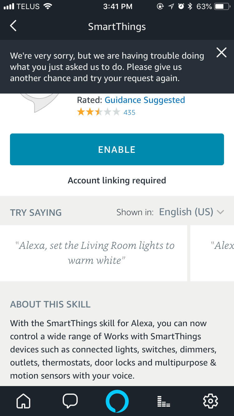

@krlaframboise Sorry if this is an obvious question. It's been a while since I've had Other Hub installed because my "other hub" has been sold. Can I trigger a ST simulated contact sensor via Other Hub ? I'm hoping that I can so I can trigger TTS on Alexa via a ST simulated contact sensor, which apparently works.
I'm just wondering if this is worth pursuing, as I'm not able to enable the ST skill right now for some reason, so I can't test the idea myself.
