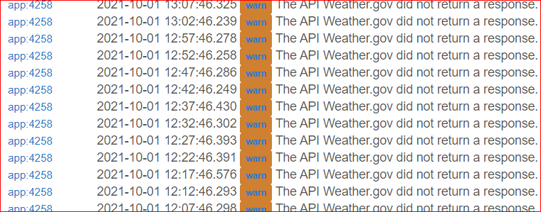

Anyone else getting this or know how to fix it?
Hundreds of warnings, starting around 2021-09-28 12:08PM
I see these every now and then, but have not see continuously.
When was the last time you nicely rebooted your HE system?
I sometime think/believe HE DNS needs a kick that polite reboot helps with.
Thank you for the reboot suggestion.
The Rebooter app executes at 0400, twice weekly on Wednesday and Sunday, last scheduled reboot was 2021-09-29. However, just to be sure I did a manual 'safe reboot', unfortunately the warnings continue.
When I get some time, I'll remove then reinstall the app.
I just looked at my logs and I’m seeing the same thing. Something that I would see only occasionally before.

So it seems NOAA has broken them selves again (they reverted back to the broke version of the API from last week).
So much for source code control....
Confirming, started 2021-10-05 09:18:39.414
They are right up there with DMV.
Mine is not working either.
Current NOAA Weather Alert setting (Not Working):
https://api.weather.gov/alerts?point=(your latitude,longitude)&status=actual&message_type=alert,update&urgency=Immediate,expected,future&severity=Unknown,minor,moderate,severe,extreme&certainty=Possible,likely,observed
Working by setting up API from NWS API Website:
https://api.weather.gov/alerts?status=actual&message_type=alert,update&point=(your latitude,longitude)&urgency=Immediate,Expected,Future&severity=Extreme,Severe,Moderate,Minor,Unknown&certainty=Observed,Likely,Possible
NWS API Web link: API Web Service
Their documentation states the first method is the REST API calls....it has been working for years until some novice tried to become a programmer....
I have pushed hack to let you adjust this. I'm sure they will break it and will have to create another hack.
Do an HPM repair, and see the new option:
"Capitalize Severity in API calls (NOAA bug)"
I just did a test alert and got this back after the repair. I will watch the logs for other failures.
    "correlationId": "15f47fd1",
    "parameterErrors": [
            "parameter": "query.severity[1]",
            "message": "Does not have a value in the enumeration [\"Extreme\",\"Severe\",\"Moderate\",\"Minor\",\"Unknown\"]"
    "title": "Bad Request",
    "type": "https://api.weather.gov/problems/BadRequest",
    "status": 400,
    "detail": "Bad Request",
    "instance": "https://api.weather.gov/requests/15f47fd1"
did you set the new parameter in settings to on?
