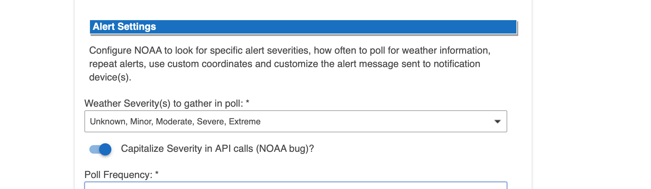

Is what I see under alert settings.
I did an update again from HPM and now I have it...let me test, yep looks like it's working now, thanks.

There is another update for api bug workaround…hpm repair to get it

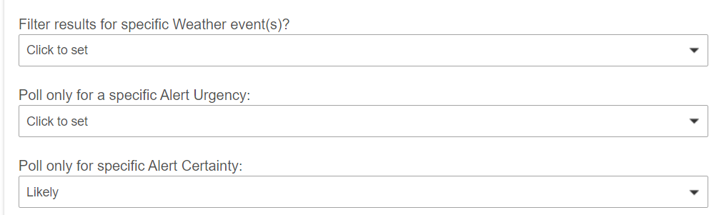

What do you have in your advanced alert settings turned on?
Nothing is set in advanced alert. I only used Severe and Extreme in the severity settings.

**This is an issue with capital letters in Advanced Alert settings. See in bold.
Not working in NOAA Alerts:
https://api.weather.gov/alerts?point=44.302018%2C-92.674947&status=actual&message_type=alert,update&urgency=Unknown,immediate,expected,future&severity=Unknown,Minor,Moderate,Severe,Extreme&certainty=Unknown,possible,likely,observed
Working link with modified capital letters:
https://api.weather.gov/alerts?point=44.302018%2C-92.674947&status=actual&message_type=alert,update&urgency=Unknown,Immediate,Expected,Future&severity=Unknown,Minor,Moderate,Severe,Extreme&certainty=Unknown,Possible,Likely,Observed
So the latest version (do an HPM repair) should do this with the setting on....
If you can ensure you are running latest, and enable the setting, then show me if there is a failure the URL that it is using - that will be helpful
Working now with no bad request:

@nh.schottfam I am getting this error on 4.0.017
app:49162021-10-13 07:46:01.740 am warn NOAAApp (v4.0.017) | The API Weather.gov did not return a successful response 400 message Bad Request.
app:49162021-10-13 07:46:01.133 am info NOAAApp (v4.0.017) | Connecting to weather.gov service
Here is URL
Also this error
app:49162021-10-13 07:49:53.788 am errorNOAAApp (v4.0.017) | groovyx.net.http.HttpResponseException: status code: 400, reason phrase: Bad Request on line 1157
Ensure you are updated to latest. (do an HPM repair)
Ensure you try the new parameter
@nh.schottfam Turned on slider and did a repair. HPM shows NOAA App at 4.0.016 and the App itself at the bottom shows 4.0.017.
No more Bad Requests. Thanks for the help.
