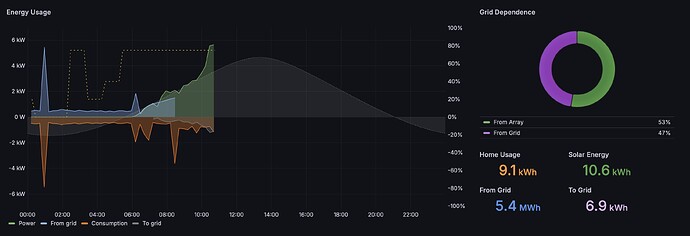

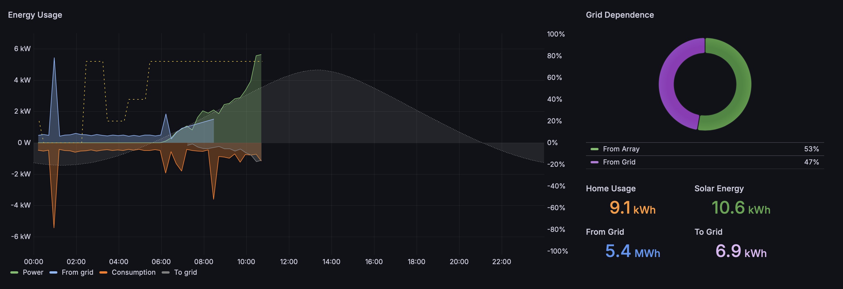

Thank you for the driver. Please know it is inspiring an influxdb and grafana dashboard:
The dashboard is still a work in progress, and not prime time yet...
Cheers!

Will you please share the dashboard with us when it’s complete? Looks awesome!
Yes can do. It is for grid tied panels.
Delayed due to life, and will plan to post to this forum this month.
