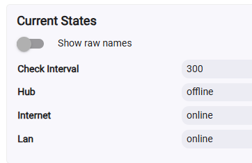

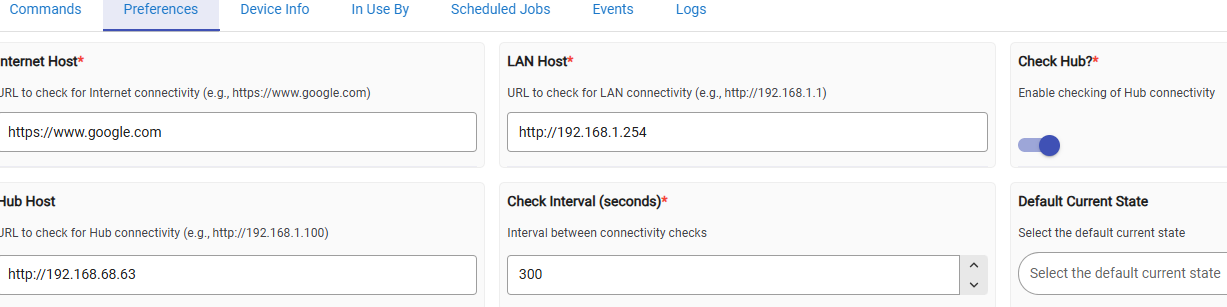

Thanks for this app. I think it will be very handy. The lan and internet checks are working but the hub connectivity shows "offline" regardless of whether I enter the hub ip or name.local.
Using C7 on 2.4.1.157
Any suggestions to correct?

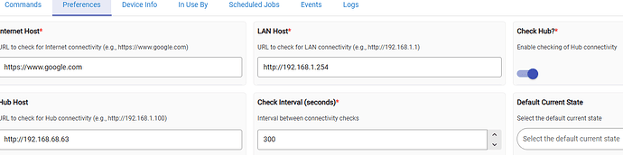

You are using http://192.168.68.63 for the hub IP
Can you acces that IP from the subnet you are on?
Yes. Yes.

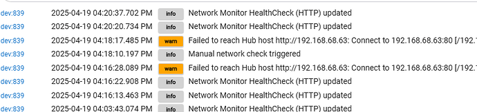

The code is placing a basic httpGet and it’s looking for a successful return (200).

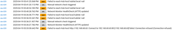

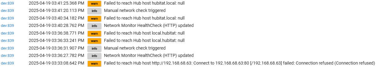

The log is stating connection refused. Any firewalls in between?
Basically this hub is placing the httpGet but something on the way to that request, is blocking it…

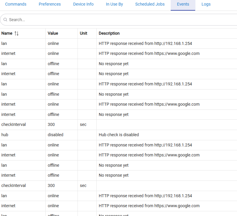

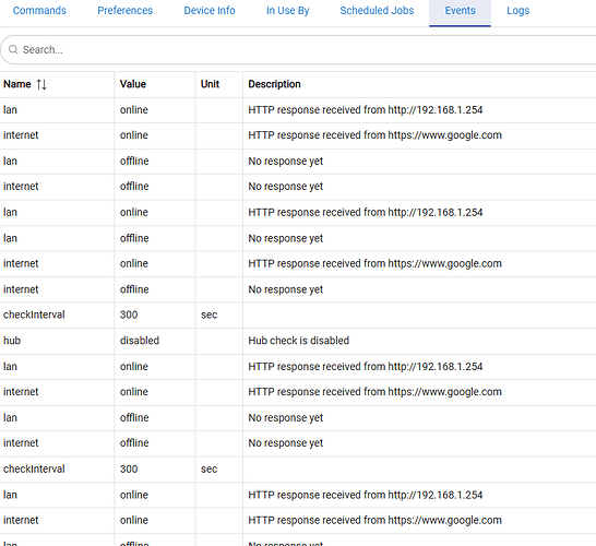

FYI: The device event list is not showing that the hub check is running, only the lan and internet checks. But the log is showing the errors for hub check.

Indeed changing the hub IP to the local hub ip and even 127.0.0.1, returns that.

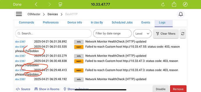

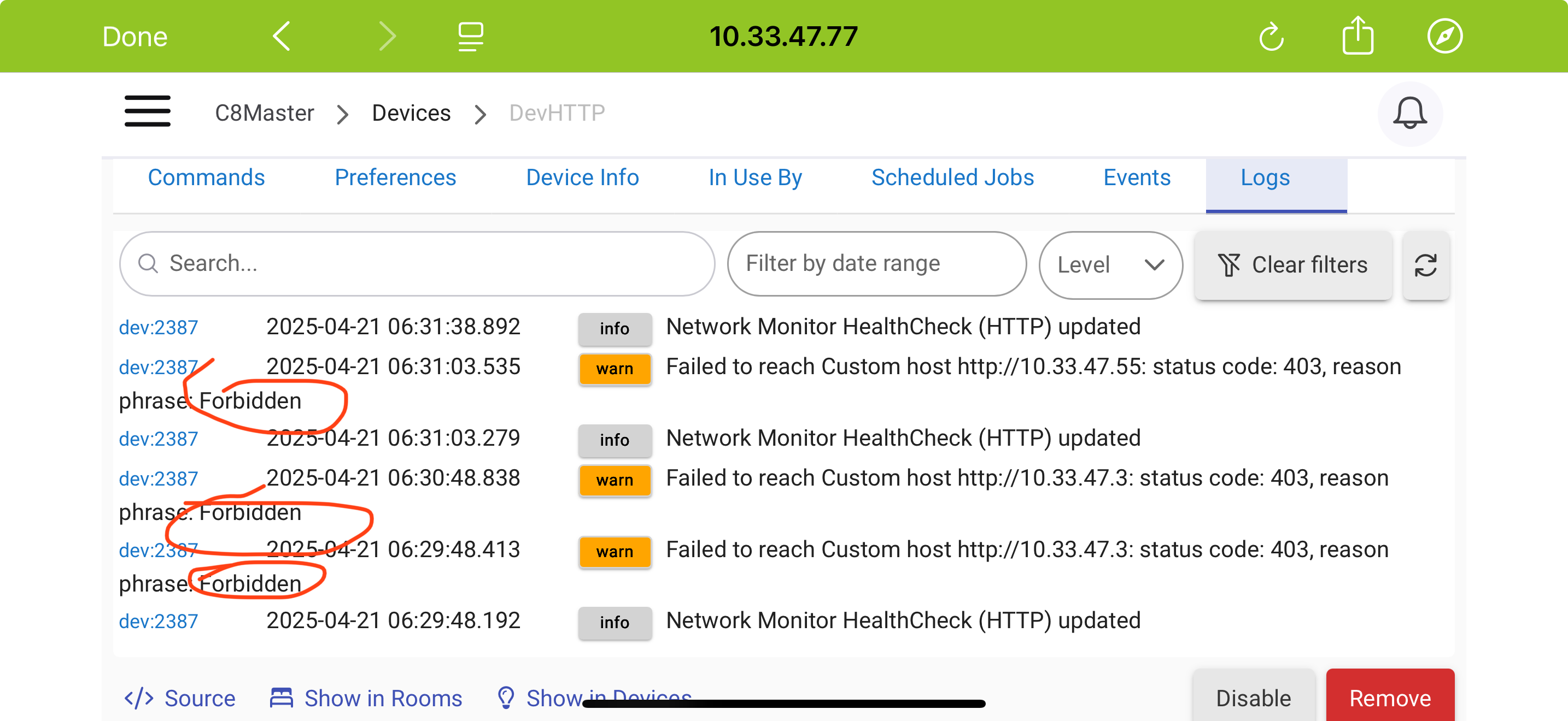

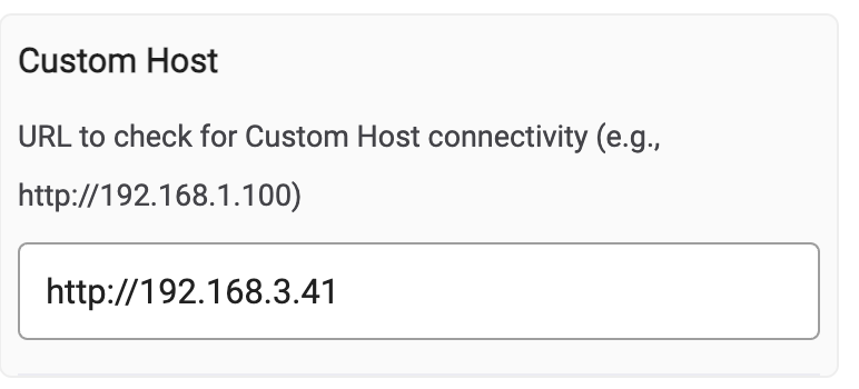

Custom still does not appear to work for me. This is another/secondary hub. I can ping it using "ping" from my laptop and from the ping in the primary hub's network test tool.
That is strange.
What does the log say ?
It returns offline if a successful httpGet is not retrieved (return code 200).
So if it’s anything than that (404, 403 anything except 200) it says offline.
While these hosts are all “up”, since they didn’t return to 200, they show up as offline
I guess i can rewrite the code to return offline ONLY when the host is down down (No route to host).

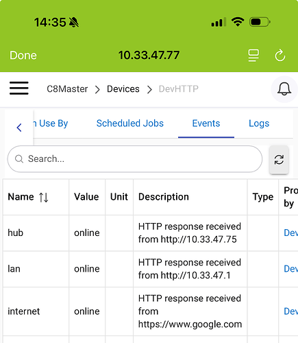

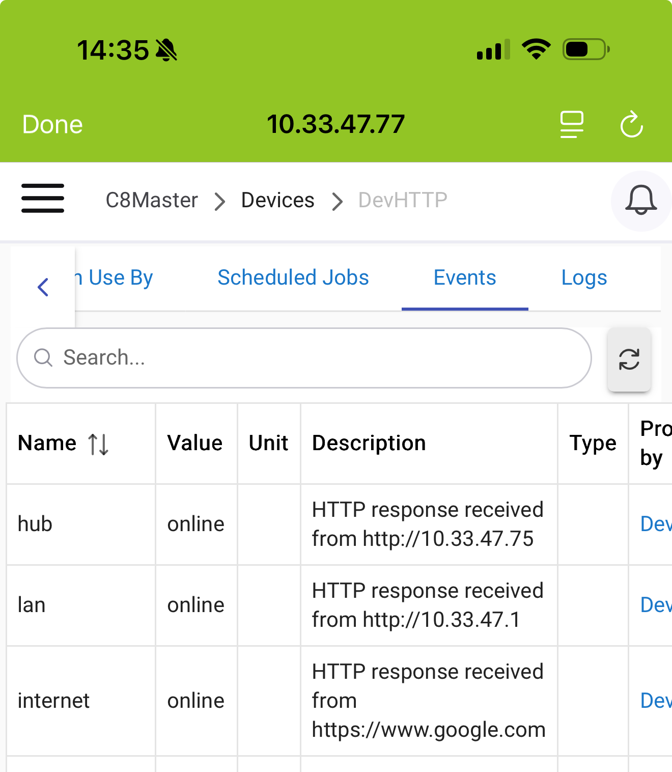

My testing shows it working as expected

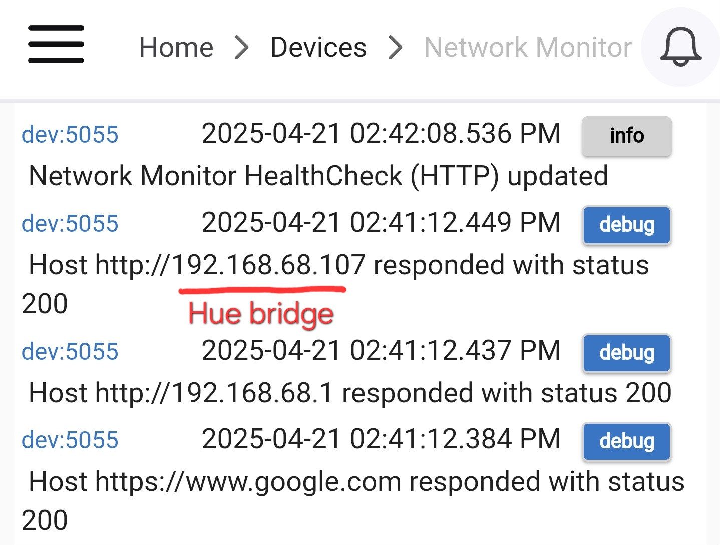

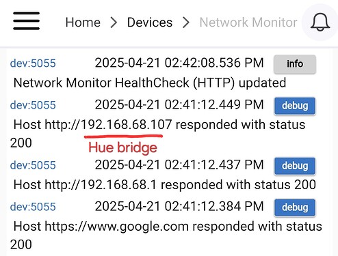

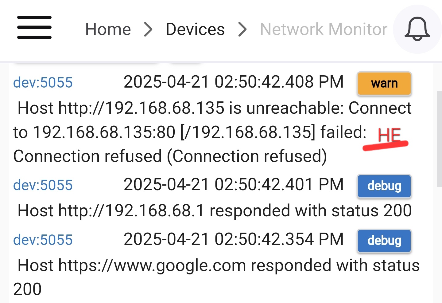

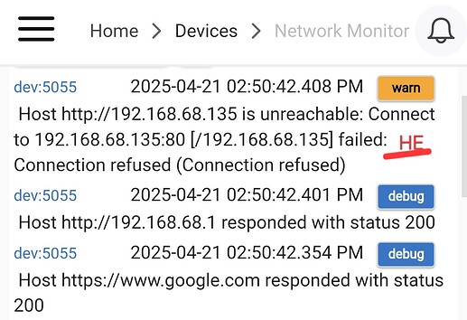

All my hubs (HE, HA, Aqara M3, SmartThings) are showing as offline/unreachable (connection refused), except for the Hue bridge which shows as online.
All hubs are on the same subnet, 192.168.68.xxx
@iEnam
Are those hosts connecting via https?
The httpGet goes by default on port 80 when using http and if port 80 is closed, then it returns as refused.
You can use IP:port format to point it at a specific web server port
E.g. http://192.168.68.135:8080

Great, all non-responsive hubs work with port 8080, thanks :blush:
It’s strange though. I know HE has 80 open …
