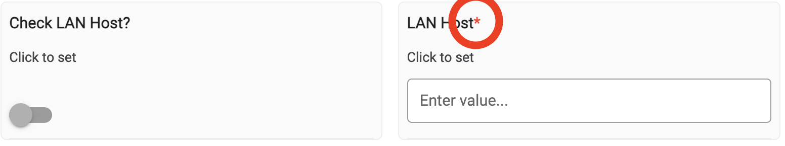

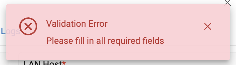

in 1.3, with LAN off, I'm not able to save without some value in LAN Host.

It couldn’t save without LAN host because when Check LAN Host? was turned off, the lanHost field was still marked as required. That forced a value to be present during saving.

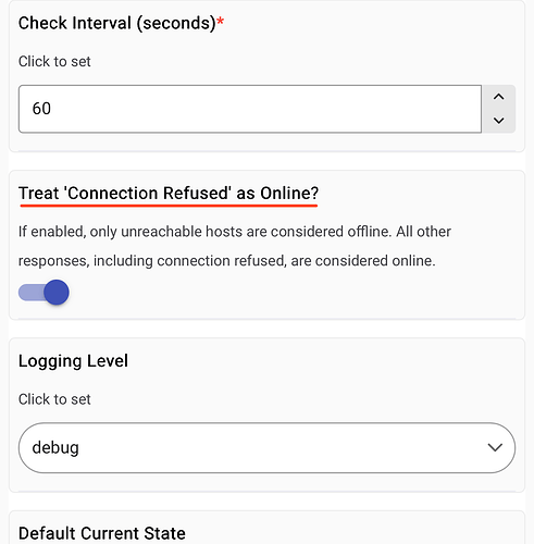

I fixed both of those issues and I added a toggle also that when enabled, will now optionally treat “connection refused” as online. The new toggle controls whether only unreachable hosts are considered offline.
It is useful when probing other type of ports (not http) and the connection is refused.
Technically the host is up to refuse the connection. The driver should not rely only on a successful connection code.
It can be disabled though, where the driver returns to the normal “http only” approach .
