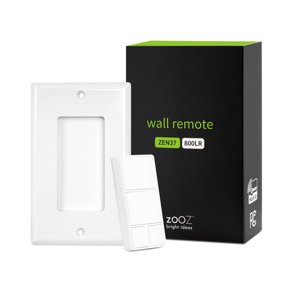

It looks like Zooz now make a VERY similar device
I got this notification today too. This Zooz model must be related, they are too close. Good news, the Minoston remote seems to be excellent and it's too bad it's not available anymore.
I did write to Minoston support recently, and they said the remotes should be back in stock in a few months. I wonder if it will reappear with a rechargeable battery like this Zooz model?
I think that Evalogik is the manufacturer for the Minoston, New One, and Zooz. All four of these are indistinguishable from each other, physically.
They likely only have very minor differences in hardware. An angled cord instead of straight power cord on the outdoor outlets, for example. Different color LED on the button on the indoor plugs. Things like that.
They likely have unique firmware and features between these models, and their distribution network and support is quite varied between all brands. Zooz seems to have a great price on these, as well as top-notch support.
Yeah, I am pleased my Minoston worked via this community driver, but... A Zooz version will be really nice to have.
If you do want the Zooz model, it is fully supported on HE with my custom driver:
[DRIVER] Zooz ZEN37 Wall Remote
