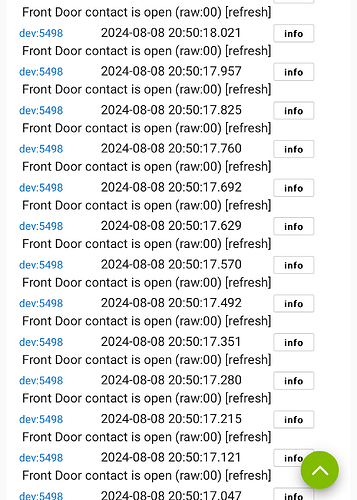

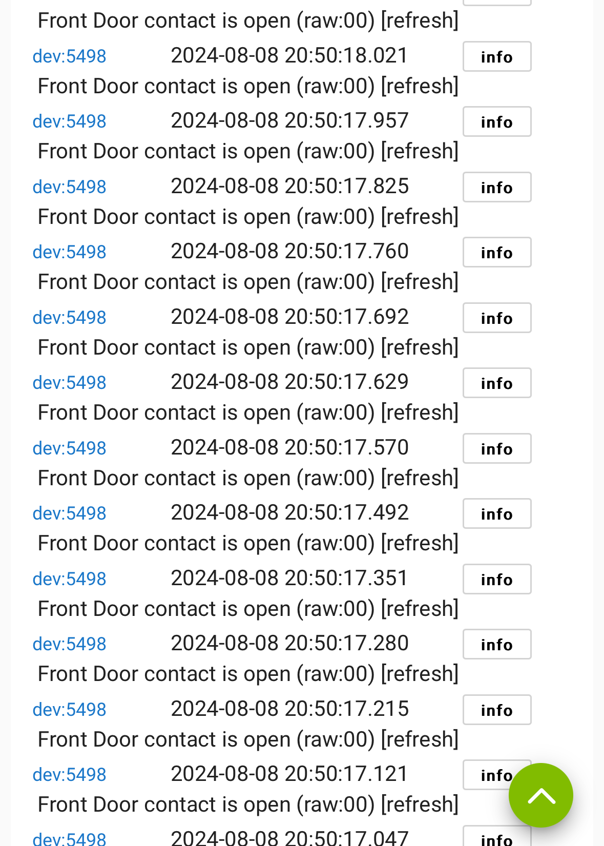

Things have gone south for me recently. I’m using an Aqara hub which has three contact sensors attached. Whenever one of the changes, some 20+ refresh events get triggered which causes some of my automatically me to overload.
Is this an issue in the driver or am I somehow triggering those refresh events?

I suppose you are on the latest driver version 1.1.2 and that the bridged Aqara contact sensors have worked OK initially?
Also, do you have other Matter devices in use paired to the same HE hub?
The possibility for these multiple subscriptions to the Matter events are the biggest problem in HE Matter implementations at the moment - not only for this package, but also for all other Matter drivers. They are caused by calling the initialize() method not only on the HE hub reboot, but also when the Matter device (a bridge or any 'native' Matter device) returns an error response to the last command that was sent by the driver. I haven't found a reliable way to distinguish between the case when the driver must obligatory re-subscribe the events (such as when the HE hub was rebooted, but also when the Aqara hub was rebooted!) and the problematic re-subscriptions result of a Matter communication / commands errors. Hopefully, the issue with this automatic call of the initialize() method will be mitigated somehow in a future HE platform update; I suppose it won't be an easy fix.
Could be a driver issue - the 'refresh' flag not being cleared after a timeout, although at first reading I couldn't find something obvious in the code. I will continue searching for the possible reason(s).
Meanwhile, you should be able to quickly fix the issue by clicking on the "Re Subscribe" button in the Bridge device page. Wait until you see the 'Status' attribute as 'completed'. Then you can click on the 'Refresh' button - you should see only one 'contact is open/closed' log per device. Does this work in your environment?

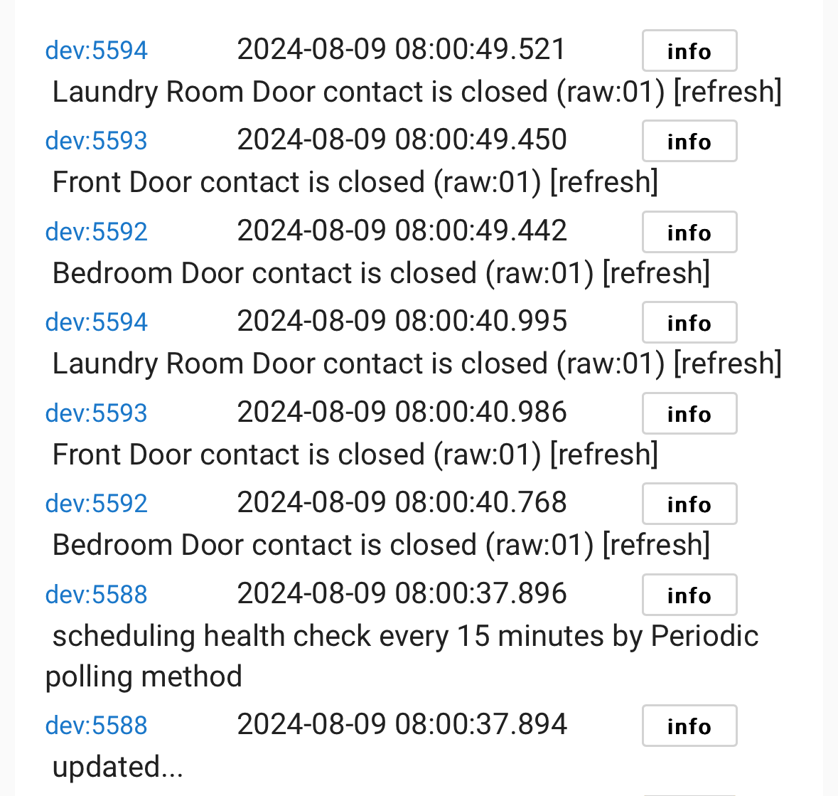

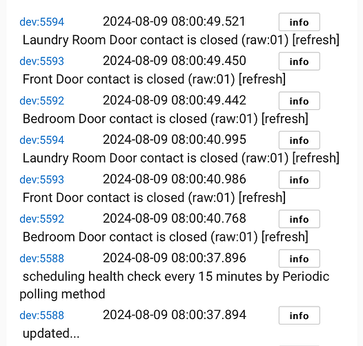

I did the re-subscribe (I swear I tried that before) and it seemed to have improved things. The refresh after that however called refresh twice for each of the contact sensors:
You can enable the Debug logging for several hours and send me the logs in a DM for further analysis... It is still strange that the contact events are duplicated after a forced Re-Subscribe.
What is the Aqara GW model and what is the contact sensor model?
Thanks for offering to look into this. It is actually behaving right now with no more spurious refreshes so the logs at this time will probably not be useful. I’ll keep your offer in mind though when the issue resurfaces.
