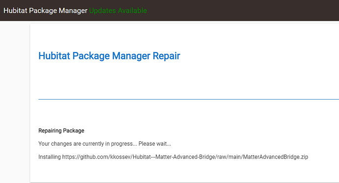

Please try ver. 1.3.1 2024-11-12 '2023/11/12 9:55 PM' - (dev. branch) bugfix: nullpointer exception in discoverAllStateMachine()
It must be installed manually from GitHub as a Bundle Zip-ed package :
https://github.com/kkossev/Hubitat---Matter-Advanced-Bridge/raw/main/MatterAdvancedBridge.zip
Save the ZIP file on your PC and then use the HE Bindles -> Import function :
The alternative way to update the package manually is to do an HPM 'repair.'
