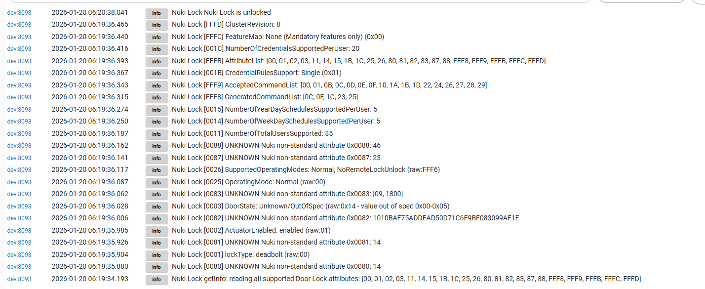

Hi @scottgu3
With Debug preference turned off, click on the 'Get Info' command button. You should see something like this in the logs tab :
Can you share your device info?

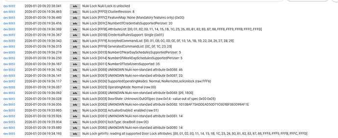

The reason for the lock/unlock operations failures could be this :
In the next update, I will add a warning log message when trying to open or close the lock when the device reports 'actuator is disabled'
I suppose the lock battery is good, and it was not in a jammed state?

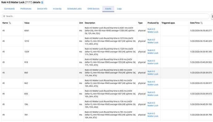

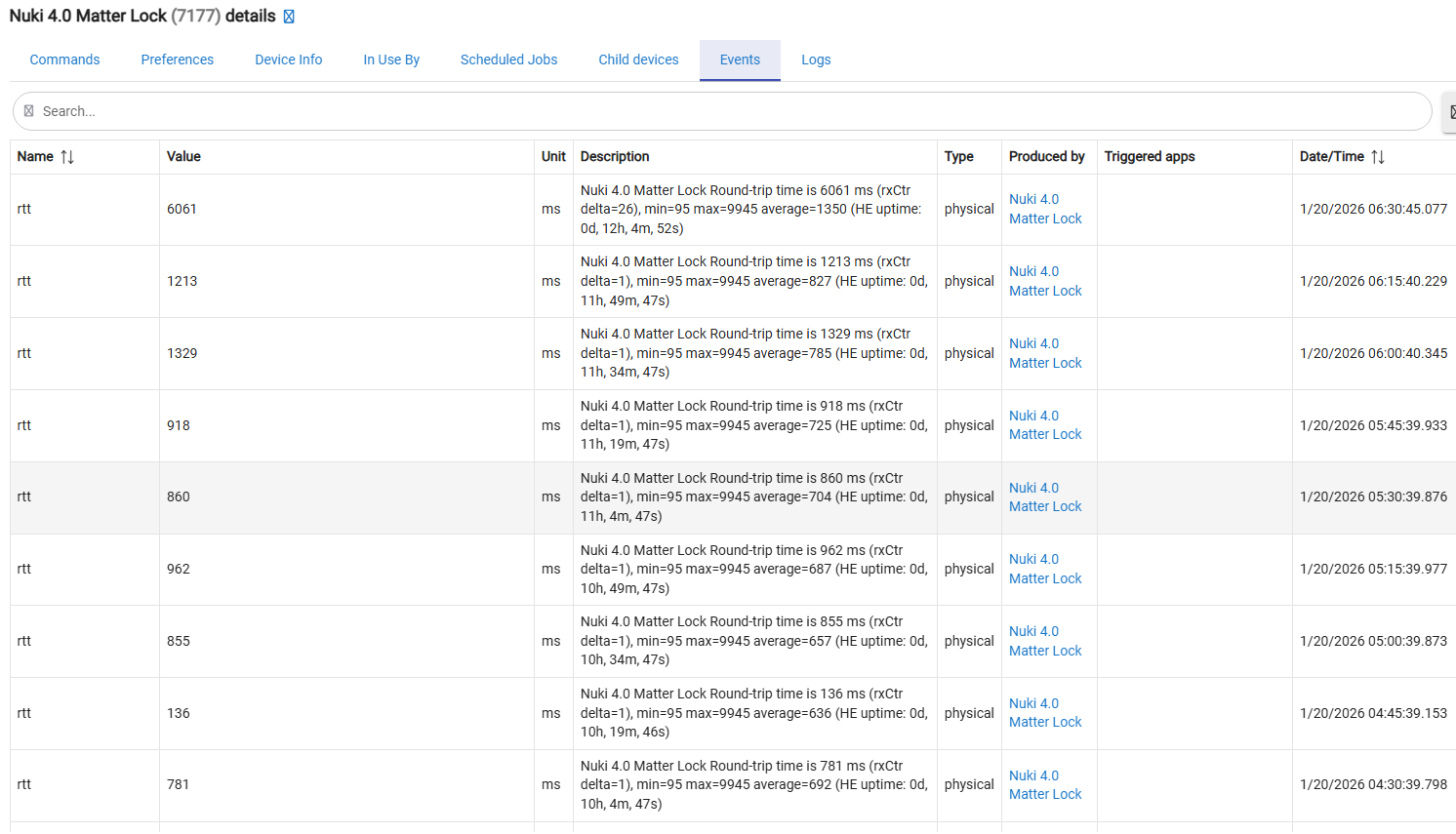

The reason for this error could also be errors / lost Matter communicaiton.., The result of sending lock/unlock commands in this 'actuator disabled' state is not strictly determied by the Matter standard, as I read it... The lock may activate or not activate the actuator.
II have seen a Jammed attribute value on my Nuki lock; I think it was the lastLockOperation state, although I am not 100% sure. I will try to simulate jammed states with my lock and see what would be the best way to report or alarm on them. The result of a lock/unlock operation must be reported very reliably by the driver—this is a security device, after all.

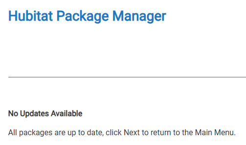

UPDATE - a repair of the package did the job
Hi, there is no update available for me, are there users that received the update 1.6.0 using HPM?

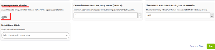

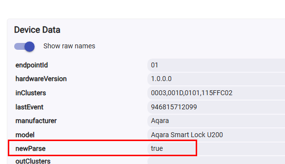

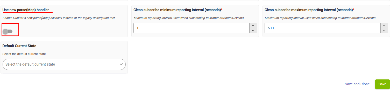

Matter lock commands and responses are quite complicated. I had to start using the newParse option, which effectively enables Hubitat’s new parser.
Enabling the new parser makes it a bit more difficult to switch back to the Hubitat stock drivers (either the “Generic Matter Bridge” or the “Generic Matter Lock” drivers).
For now, the workaround is to add a new 'Advanced option' that allows switching between the old and the new Hubitat parsers:
If someone decides to switch back to the Hubitat stock drivers, this option must be toggled off. Just FYI.

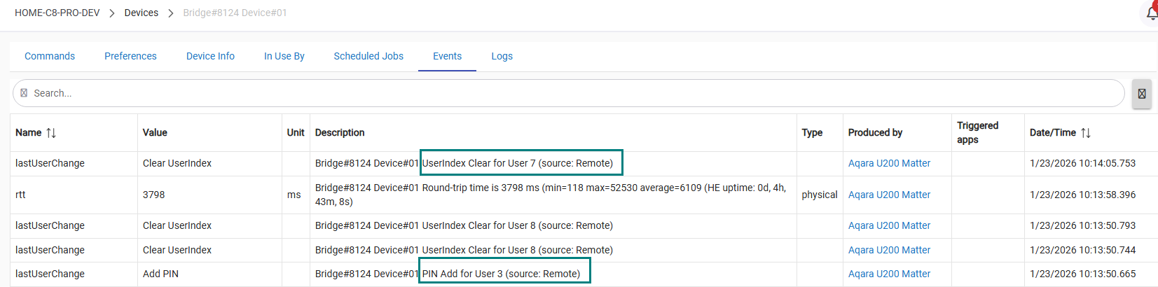

A sneak peek at some successful PIN/User commands, although there’s still a lot of work to be done before the next beta version is ready for publishing:

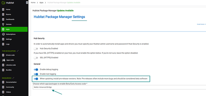

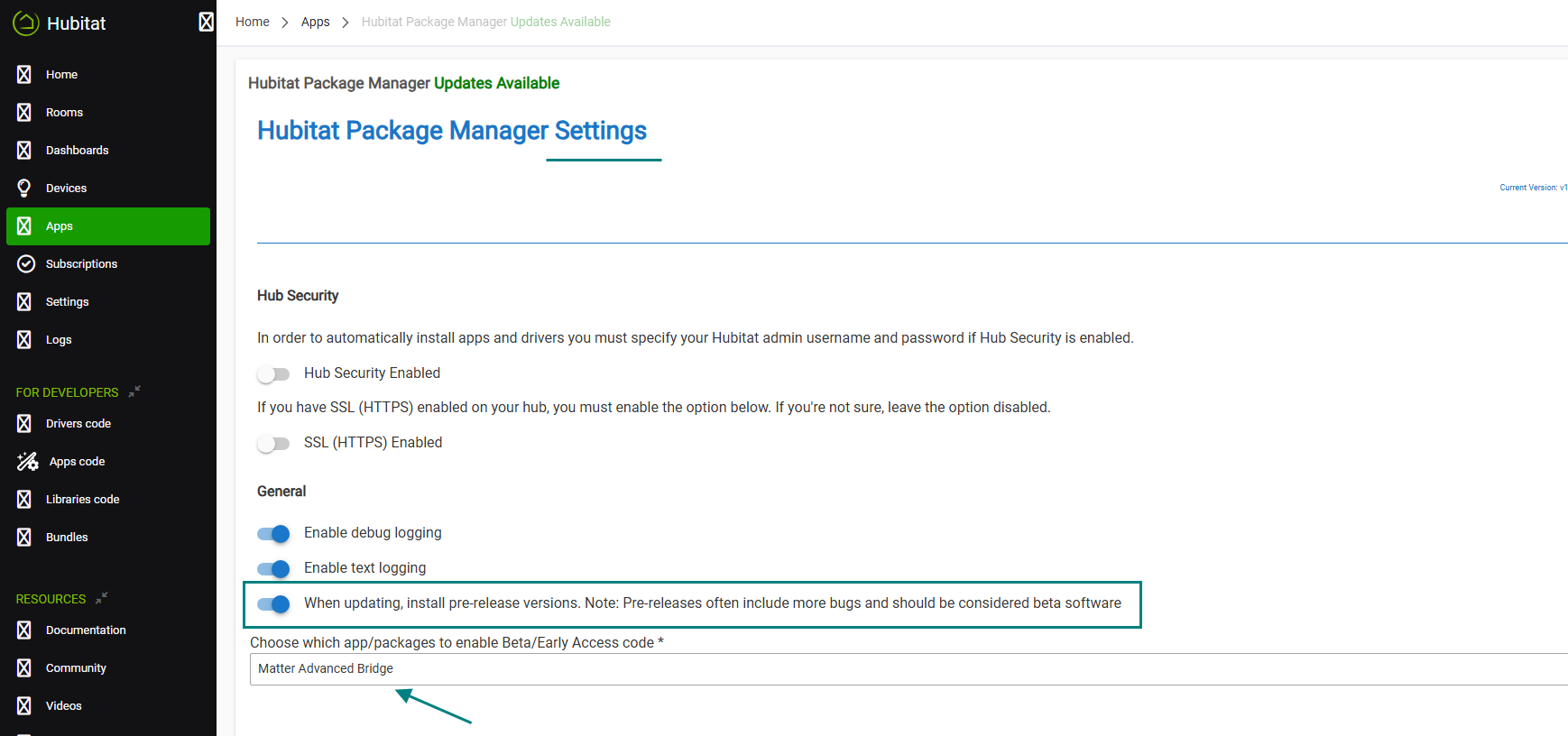

This beta version 1.7.1 can be installed using Hubitat Package Manager version 1.9.8 or later. Be sure you’re running HPM 1.9.8+ before installing.
Then, in the HPM settings, enable the “Install pre-release versions…” option and add the “Matter Advanced Bridge” suite to the list of authorized drivers and apps:
Save the changes. The new beta version 1.7.1 of Matter Advanced Bridge should appear as available the next time you press the HPM Update button.

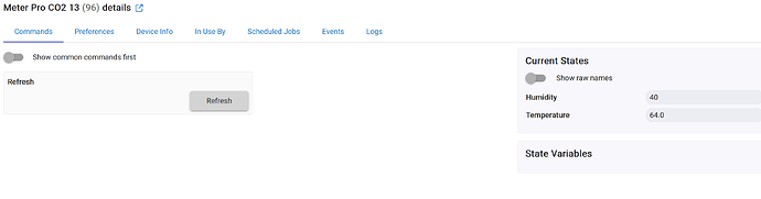

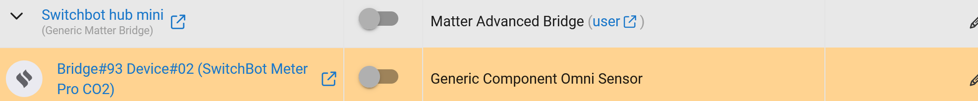

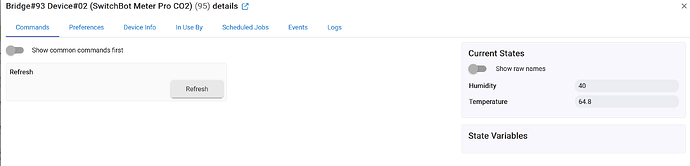

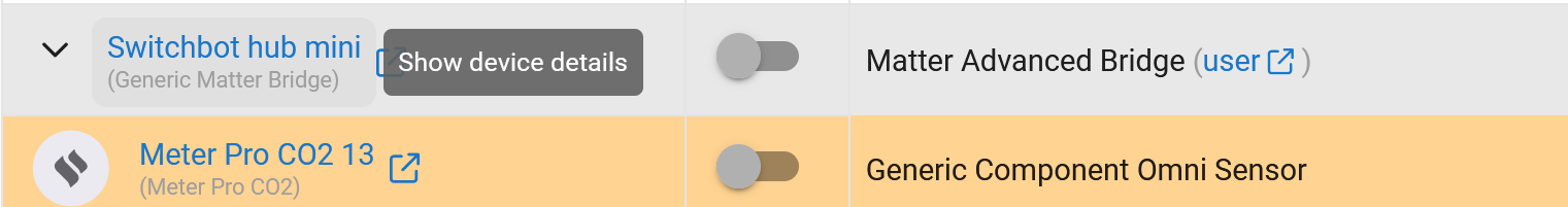

I finally got my Switchbot hub mini to connect to my C8 hub, and got my Meter Pro CO2 to be discovered using the "discover all" button. It seems to show temp, and humidity, but I was hoping I can get it to show CO2 levels. Long story short, I'm trying to use this to trigger a few fans to improve air quality in a bedroom.
I appreciate the help, and all the work that went into getting switchbot to seemingly play nice with HE. Was about to give up trying to get it connected to HE, but eventually did.
This is as far as I got :
Hi Spookypitboss,
The Carbon Dioxide Concentration Measurement feature was added a week ago in the BETA version. Can you try it? See the post above on how to enable beta version updates via HPM.
If you have installed the latest release version manually, this is the link to the Beta bundle archive :
https://github.com/kkossev/Hubitat---Matter-Advanced-Bridge/raw/development/MatterAdvancedBridge.zip
Perfect, i'll try that. Do I need to completely remove the current non-beta package in HPM before adding the beta bundle? Also do I need to remove the switchbot from HE, and re-add it through matter? Thanks
No, just update the current bundle version. Do not remove the driver or the switchbot hub.
After the update, click on the 'Discover All' command button and refresh the device web page.
Does updating and doing “discover all” mess with existing devices?
All existing devices will be preserved. However, if new device types are discovered that were not recognized or supported in the previous version, those will be created following the new discovery.

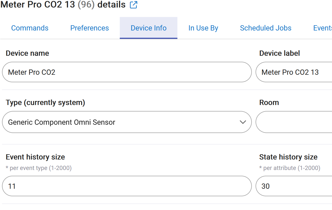

Got the beta version updated. I then clicked discover all afterwards but the meter pro still just shows temp and humidity. I then removed the meter pro, went to discover all again in the hub mini device page. It then shows as Meter Pro CO2 13. I refreshed the device page, with still just temp and humidity. Do i need to manually change the device type, in the Meter Pro CO2 device info to something else? Thanks!
I did a quick search, and a lot of sources state that, unfortunately, the CO2 sensor is not exposed in the Matter interface ... As an example, this is from ST forum :
If you temporarily change the 'device type' to the HE inbuilt 'Device' driver and click on the 'Get Info' command button, we can confirm this by examining the device fingerprint that should appear in the live logs.
