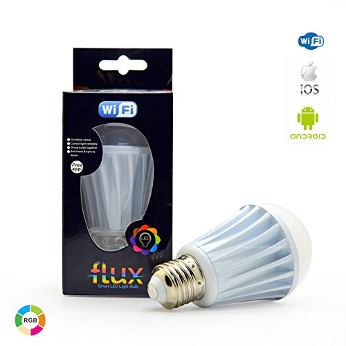

Are there any bulbs you know that don’t work with this driver? Mine look like this:
I’ve got a bunch of those bulbs, still :blush:

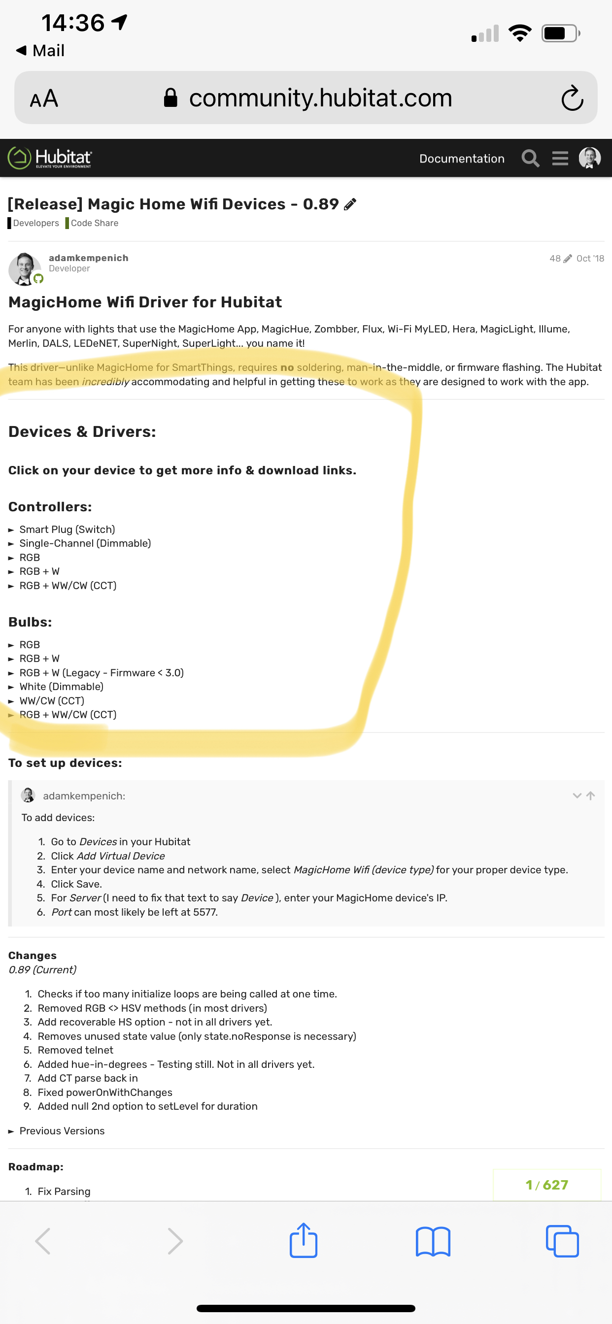

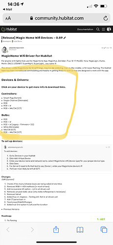

Thank you for this!! I have a color bulb and not sure which. I tried RGB and it didn’t work. Then I tried RGB + WW/CW (CCT) and it works (mostly). On and off and all presets work, but I cannot change color, hue, saturation, level. Any idea what I should check to troubleshoot? Thanks again!
Did you try the Bulb — RGBW driver?
Huzzah! That fixed it. I should have realized that myself. :frowning:
Thanks for the help!
Yes, I have tried all of the bulb drivers. RGB +ww/cw cct is the only one which any of the commands work as expected and they are all flawless except select color, level hue or saturation. They all do nothing. Strange.
