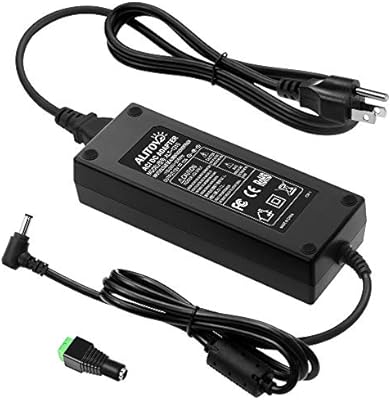

I have the controller and a strip of lights. (this is a basic electrical question I think) The controller only says 12 volts 5.5mm. The lights say 12 volts maximum 90 watts. I see power adapters around 7.5 amps and up that provide 90+ watts. It seems a no brainer but I've assumed wrong in the past. There are two types of Connectors, 5.5/2.5 and 5.5/1.7, I think the 5.5/2.5 Connector is right??? I don't want to under power the lights and I've a small but growing drawer of wrong parts. Do you have any advice for what power adapter I should try?

90w/12v = 7.5A
My power supplies are all 5.5mm OD/2.5mm ID.
If you run more than one strip, you'll need to run a wire from your source voltage to every 5 meters to maintain voltage --- these lights tend to drop voltage if you've got 5+ meters.
I'd recommend a higher amperage power supply than you think you'll need, I use 12v 10A for all of my runs.
Watts divided by volts equals amps. Sounds like something I could of looked up. Time to invest in some entry level electrical books. Thank you Adam.
