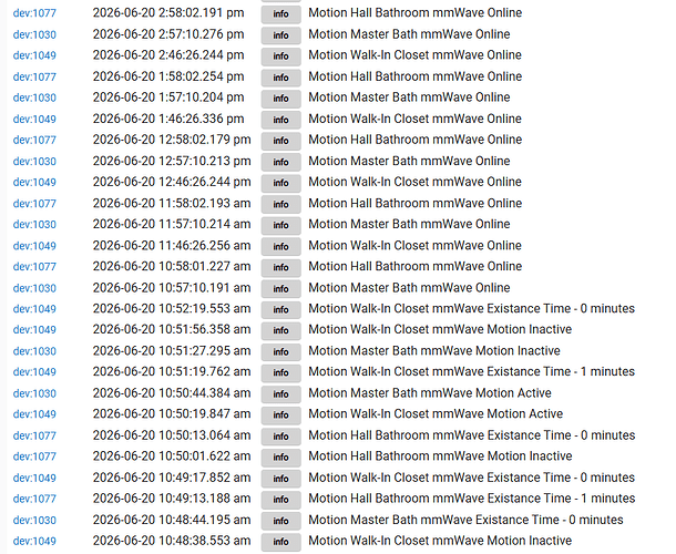

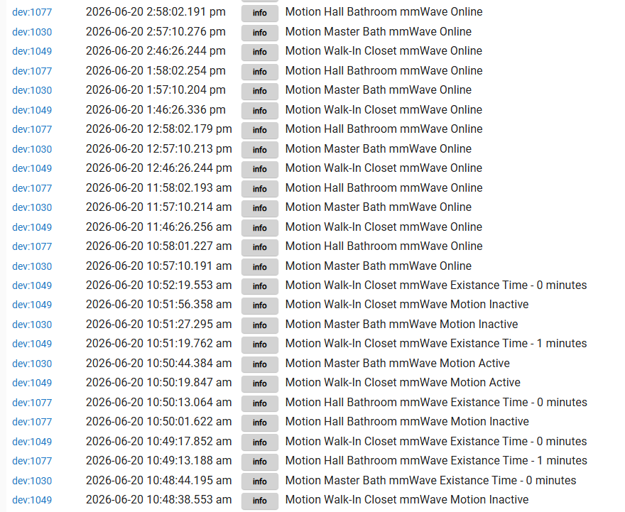

A somewhat odd failure. Starting around the time earlier today when I updated the C7 that the mmWave sensors are on to 2.5.0.159, the three sensors (the ones I added to the test part way through) stopped working...logs:
Update to 2.5.0.159:
The three mmWave devices stopped reporting motion right around the time of the update. (Motion Hall Bath, Motion Walk-in Closet, an Motion Master Bath.) Those devices still "talk" about being online, but don't report any motion.
I did reboot the hub w/a database rebuild, didn't help. The three that aren't reporting still aren't reporting. The other three are reporting normally, and all six of them are on the same hub they've always been (C7). All of them are on FW 1.05.
I'd roll-back to the previous build, but family is around/tripping automations and don't want to have to go through the "Don't panic, everyone, if nothing works for a few minutes" speech at the moment. :slight_smile:
Anyone have any thoughts about this?
Thoughts? Seemed to good to be true.
