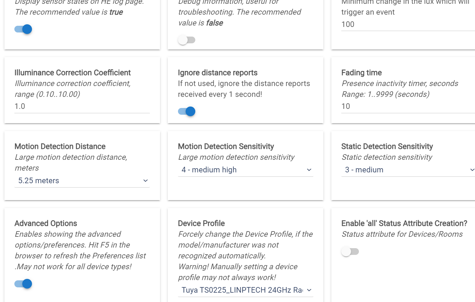

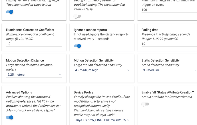

these are my setttings

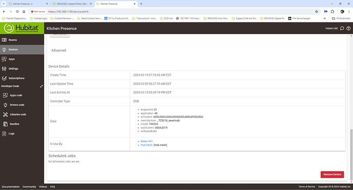

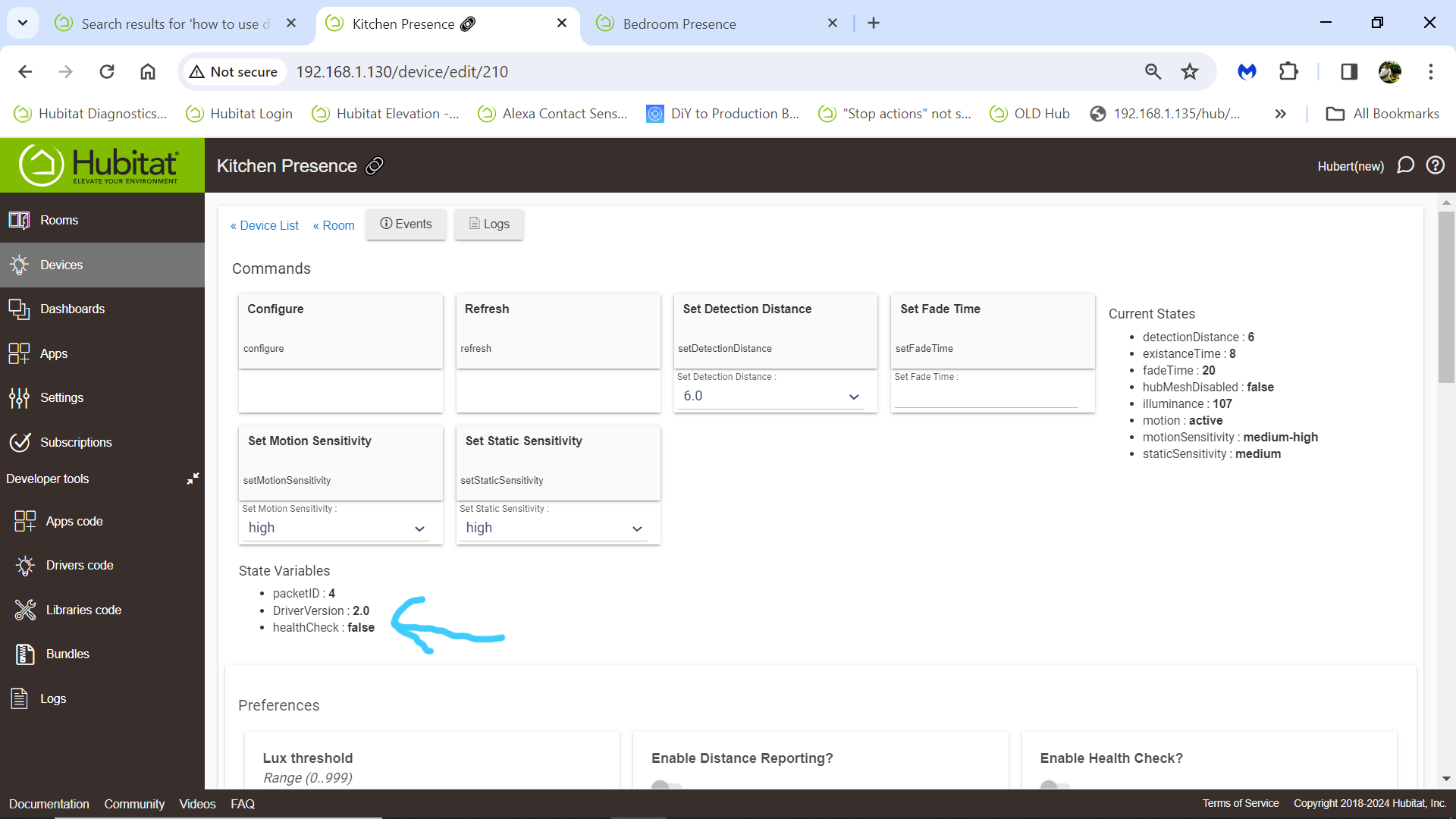

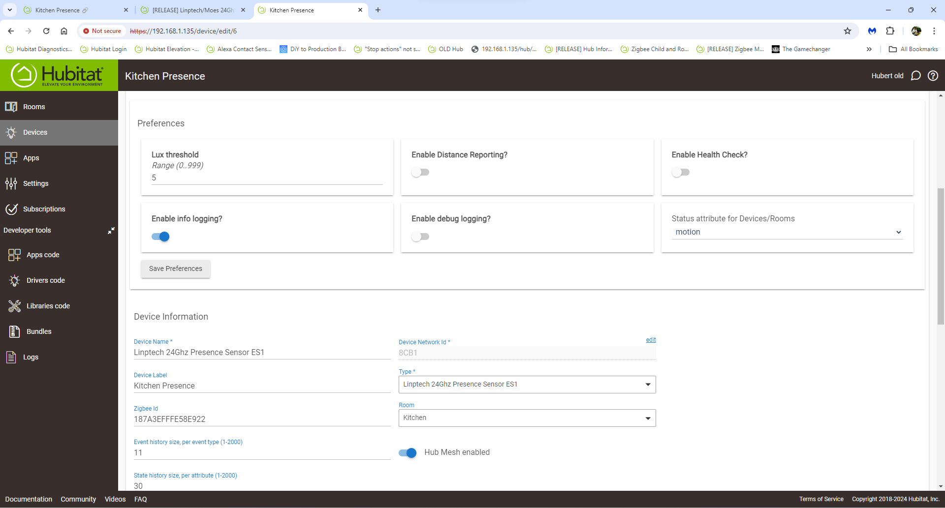

All 3 of mine have been working really well with no problems at all for a while now and all in all any issues have been minor. I am missing some info on this one in the state variables section and dont know how to get it back even tho it does not appear to cause problems I was used to seeing it and it is on the other sensors device pages. Also this one has more info in the data section than at least one of my other ones. Maybe Im to OCD
what are your preferences and driver. .looks like it missing lots of stuff like healthstatus and nopresentctr etc.
Here are the screenshots. Using the the lighter driver for the Linptech. Im missing 3 compared to my others.

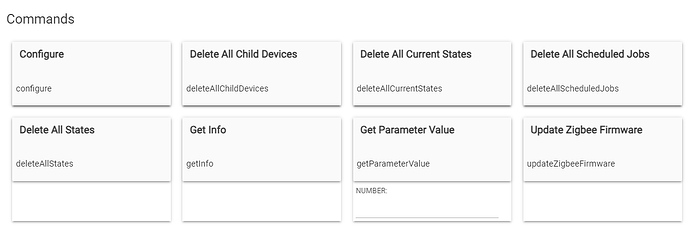

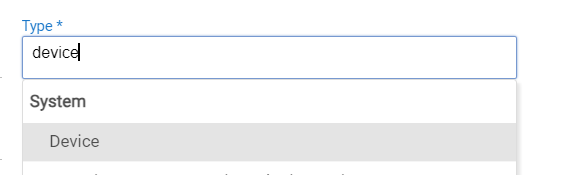

You can try the following. Change the Linptech to the "Device" driver, clear all states/settings, etc., then re-apply the Linptech driver and do the Configure/Initialize/Refresh dance.
Device driver:
2024-03-15 14_58_45-C8, C7, Hubs

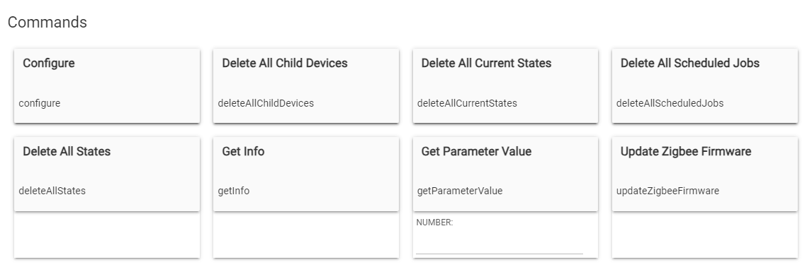

Then: Configure, run all the "Delete" commands, then Get Info.
Then change back to the Linptect driver, and do Configure, Initialize, and Refresh.
I think I already did that but I am fixing to try it again.

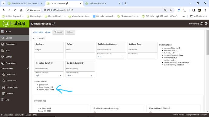

Well I did the device driver and cleared everything, then back to the Linptech. Put all my settings back, flipped on and off all things including config, refresh, etc. Here is what the states has. Still missing 3 lines?
State Variables
  • packetID : 2
  • DriverVersion : 2.0
  • healthCheck : false
One of my three is exactly the same as yours. It also works without issue, but I’m fixing to take care of that :joy:
Tell me how please

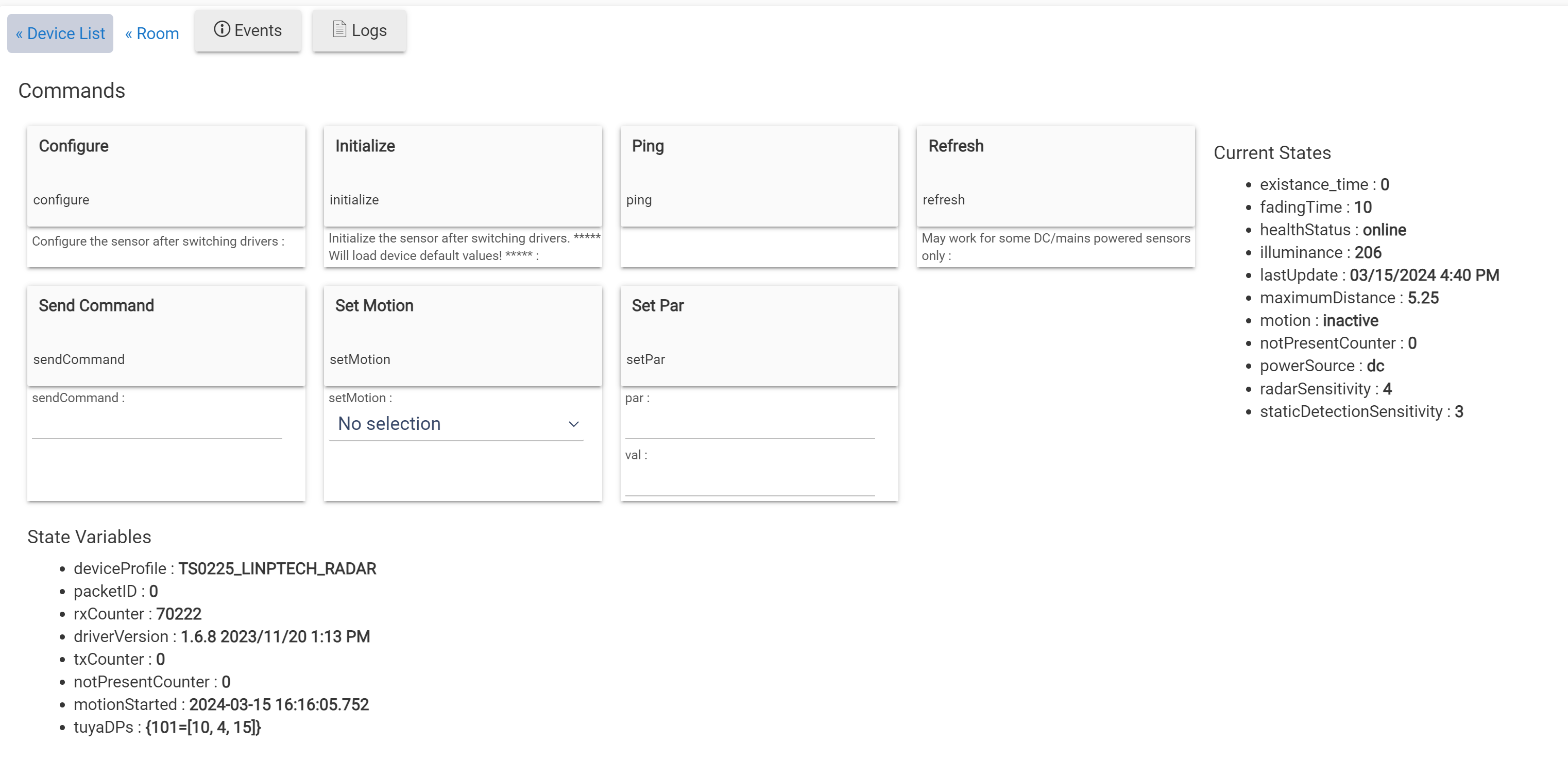

Per @gassgs original post about the driver:
I don't think you're going to get any more data in State variables. I just checked and all five of mine show above.
Mine have:
Screenshot 2024-03-15 at 4.40.14 PM
If you have never enabled Distance Reporting, you'd expect that value to be empty and not displayed. In my case, it might have been days ago that I turned that on for 2 mins and then back to Off. The last value would be reported forever, or to the next reboot. :slight_smile: Equally, if you've never changed the sensitivities, they might be blank as well and not displayed.

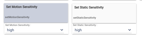

The two sensitivity values don't match. Medium, Medium for State Variables, High, Medium for Current States.
If you use the buttons to change those values, when you refresh the page, they revert to High, High:
Screenshot 2024-03-15 at 4.41.18 PM
I noticed that the other day too. It can be a little confusing cuz it feels like they are set to the values they're showing.
