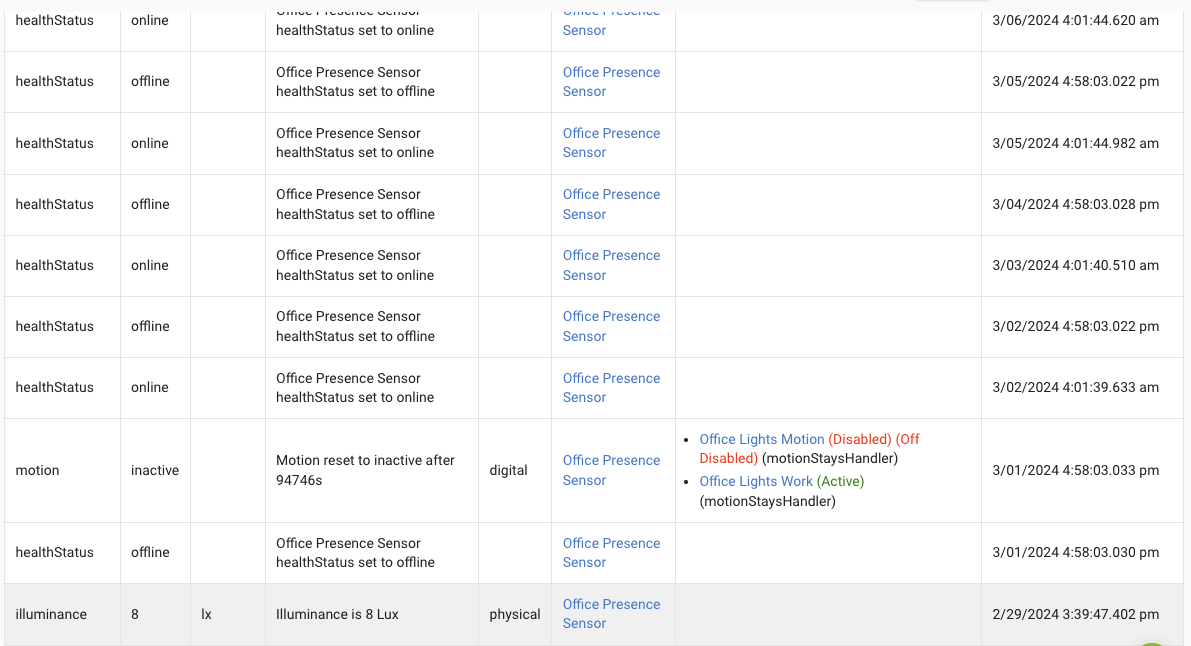

So here's something interesting. While I was out of town for 4 days, the following appeared in my event logs. Don't usually see these healthStatus messages. What's really curious is the offline came at roughly the exact same time on 3 separate days. Not seeing anything else in my logs at that time.
The lux entry at the bottom is right when I left town. It stopped reporting lux and started doing the online offline thing until I got back on 3/6 and rebooted it. 4am is when my Hubitat reboots so it seems to report "online" after the reboot each morning, then went offline again at 4:58pm. Didn't report anything in between. There wouldn't have been motion, but no lux reports either.
