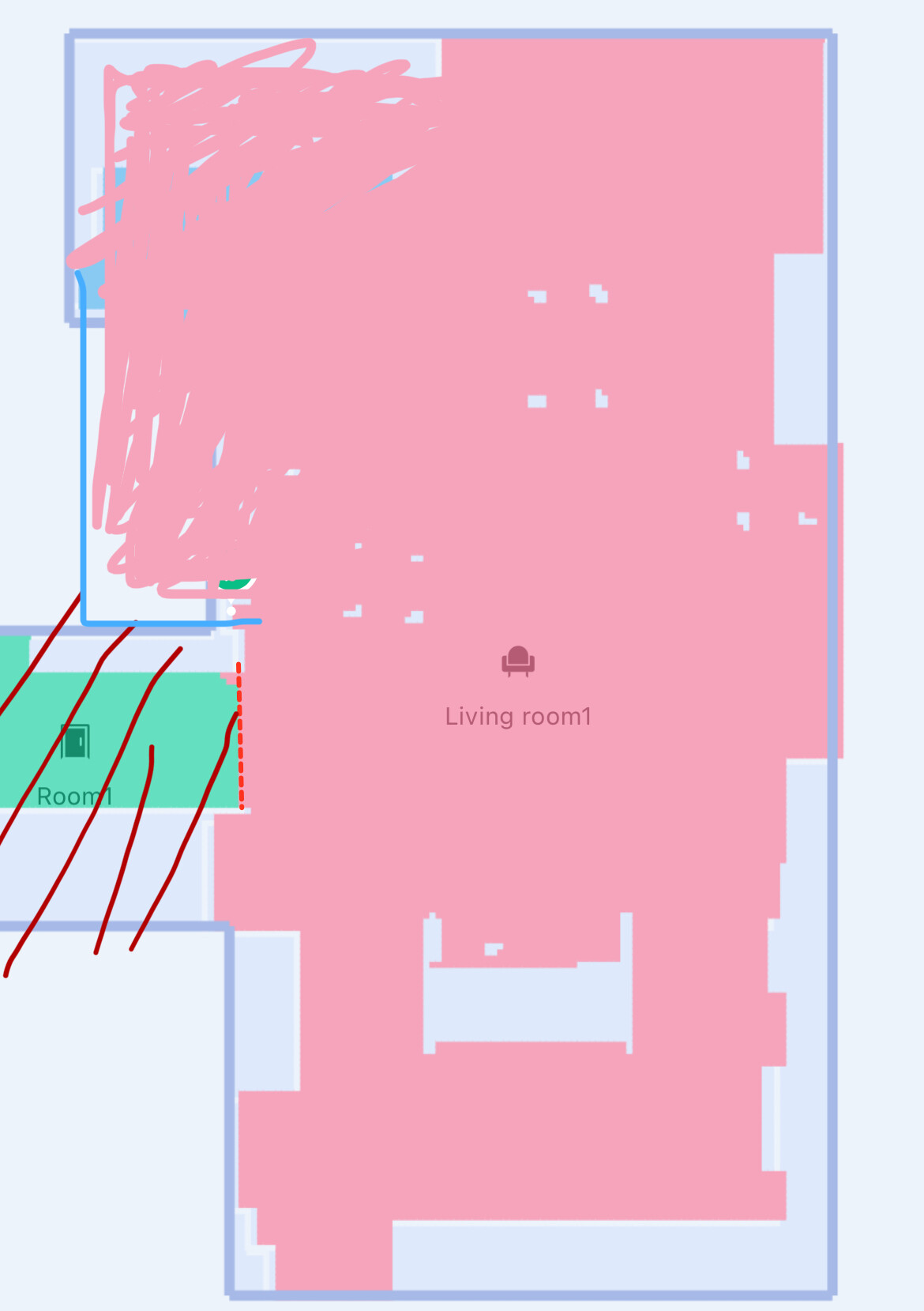

Looking at my main floor (using an old+modified robot vac map!) I’m sort of struggling or wondering about advice for how many and where to play my sensors for adequate presence detection.
It’s a large rectangular room but with a bit more of a jut-out space in the top left. That’s my “office”. To the right of that is the couch which faces the right wall, and you can see the grey area representing my tv stand.
Below all that towards the bottom right is my kitchen and the grey area is all the cabinets.
One definitely doesn’t cover the large space. Putting one on top and bottom facing inwards would cover a lot but likely miss me entirely any time I’m at my desk. But then… 3? Is that not crazy to cover one open area… even if it is large?
